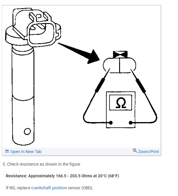

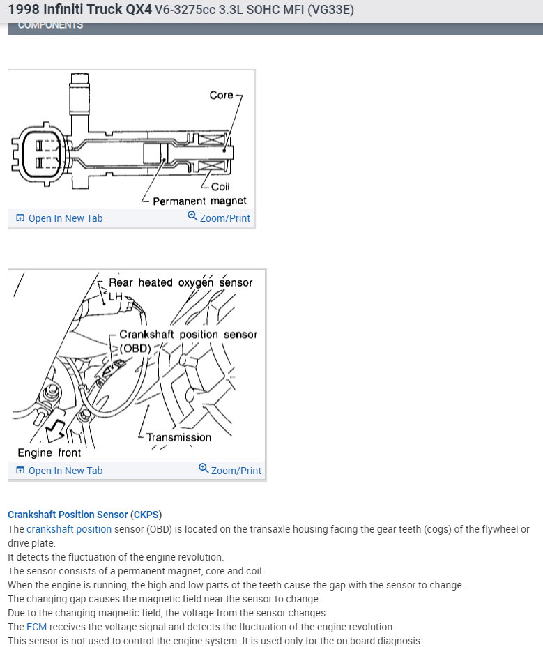

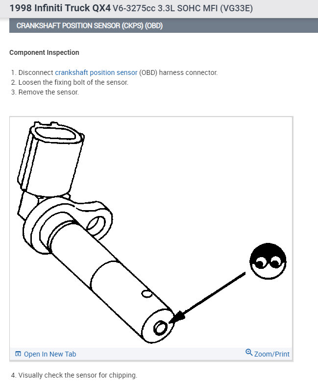

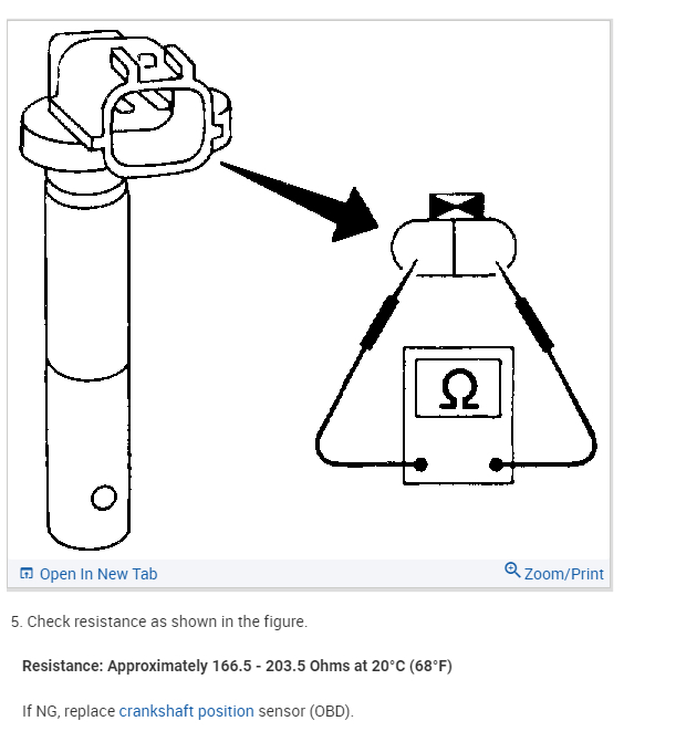

This could be due to a faulty crank position sensor.
The crank sensor sends the engine revolution signal to the ECM. Over time with heat and vibration from the engine the sensor can lose its calibration and send error code to the ECM. That can trigger an engine to shut down.
Is your check engine light illuminated?
If it is, then scanning and retrieving the code(s) can help with the diagnostics.

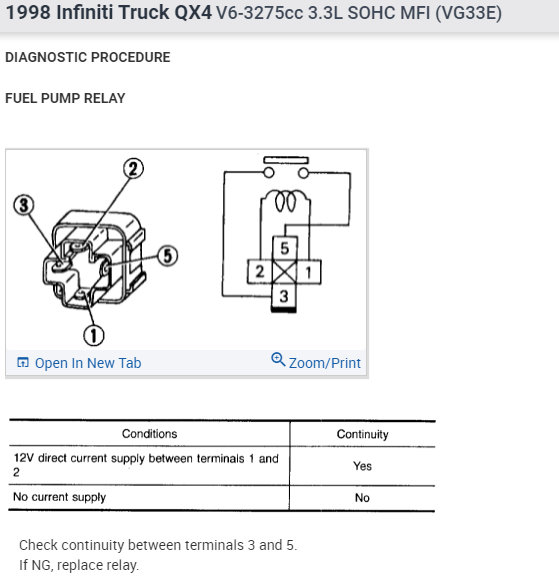

I have attached diagrams for the crank sensor location as well as testing procedure below.
Thank you.

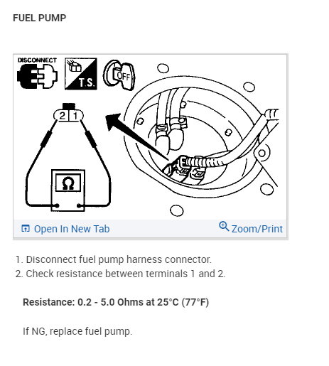

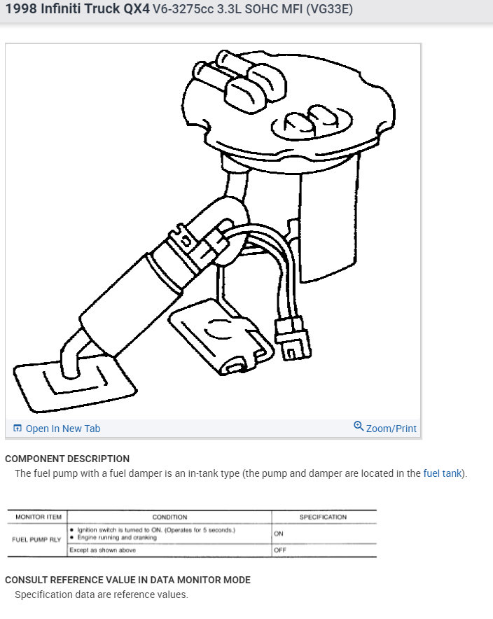

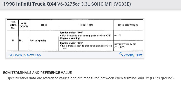

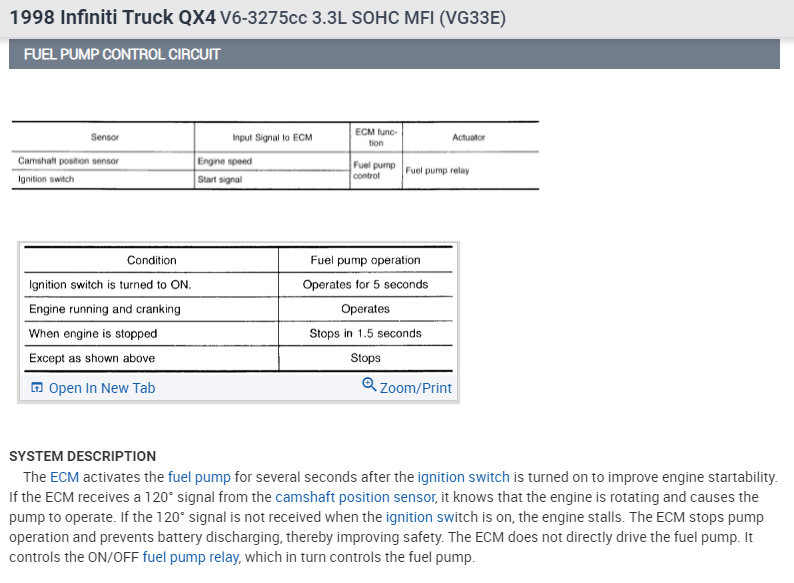

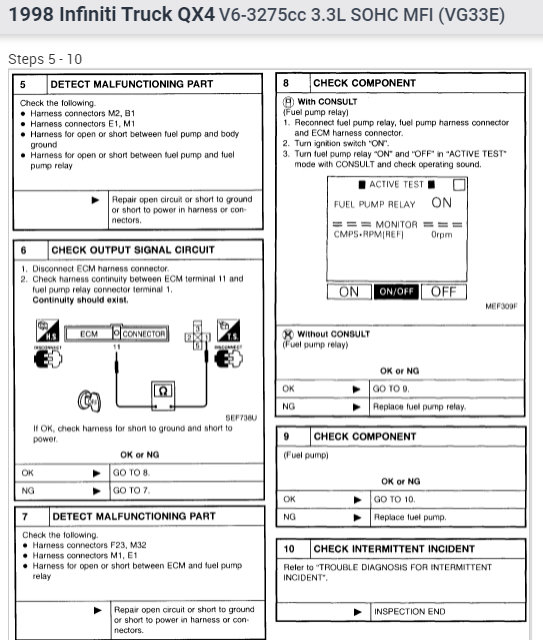

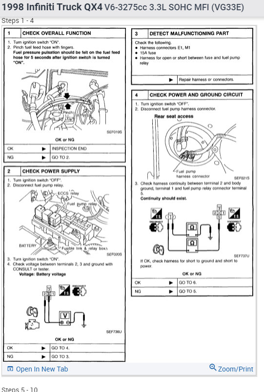

First try to jump the pump by connecting 12V power. This will tell you if the pump is operating correctly.
It is possible to have a short in the fuel pump wiring. So, checking for power at the fuel pump connector is a good idea.
I have attached the fuel pump circuit testing procedure below.
