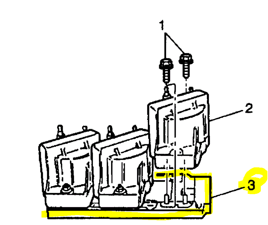

Terri,
Do you know if the ignition control module was inspected? That is the component on which the ignition coils are mounted.
If possible, can you let me know what all has been done, checked, or replaced?
If the module wasn't checked, that is my next suggestion. I attached a pic below showing the part I'm referring to.
Let me know, and I hope you have a nice Easter.
See pic below.
