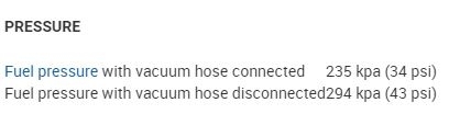

Now, there are a couple other things which could be checked. Both a weak fuel pump (low pressure) or an ignition problem (such as a bad crankshaft position sensor) can be an issue.

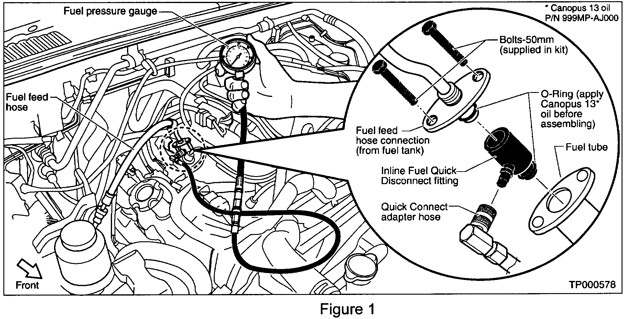

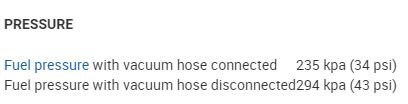

Here is a link which describes how to check fuel pressure:
The first picture below contains the fuel pressure specifications required by the manufacturer. The second is where the pressure gauge is connected.

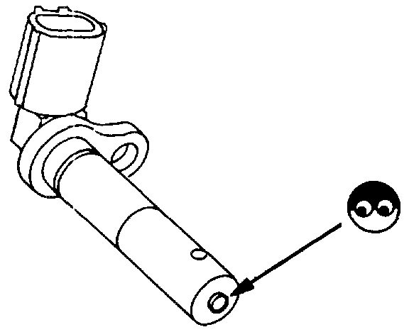

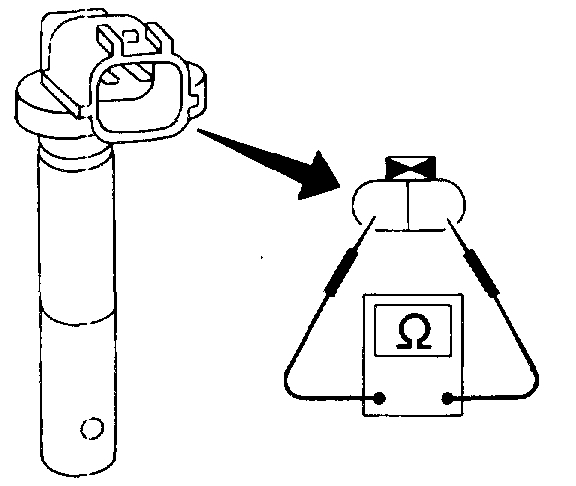

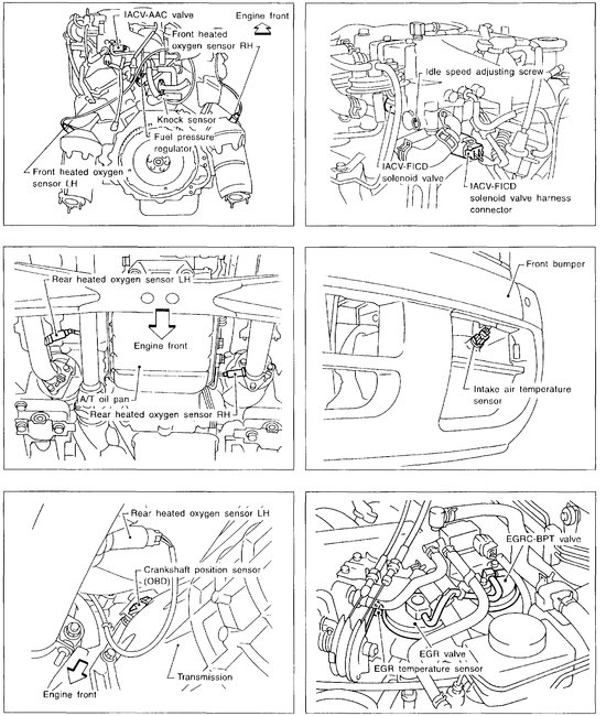

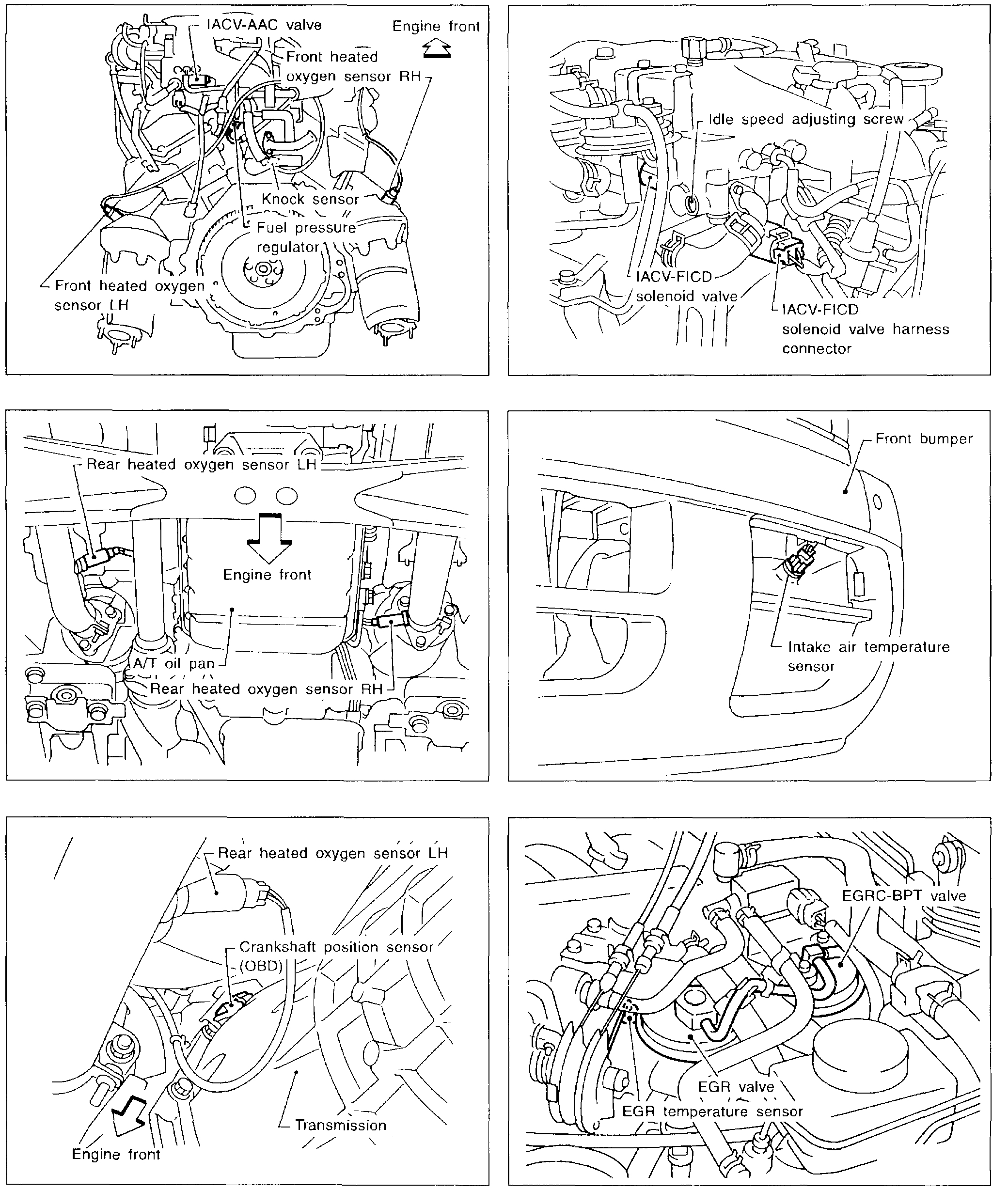

If you feel the sensor should be checked, here are the specific directions from alldata specific to your vehicle. Pictures three and four correlate with these directions.
CRANKSHAFT POSITION SENSOR (OBD)
1. Disconnect crankshaft position sensor (OBD) harness connector.
2. Loosen the fixing bolt of the sensor.
3. Remove the sensor.
4. Visually check the sensor for chipping.
5. Check resistance as shown in the figure.
Resistance: Approximately 166.5 - 203.5 Ohms [at 20°C (68°F)]
If NG, replace crankshaft position sensor (OBD).
Picture five is the location of the sensor.
