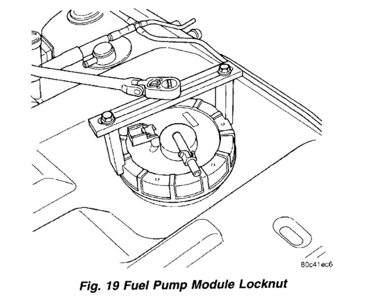

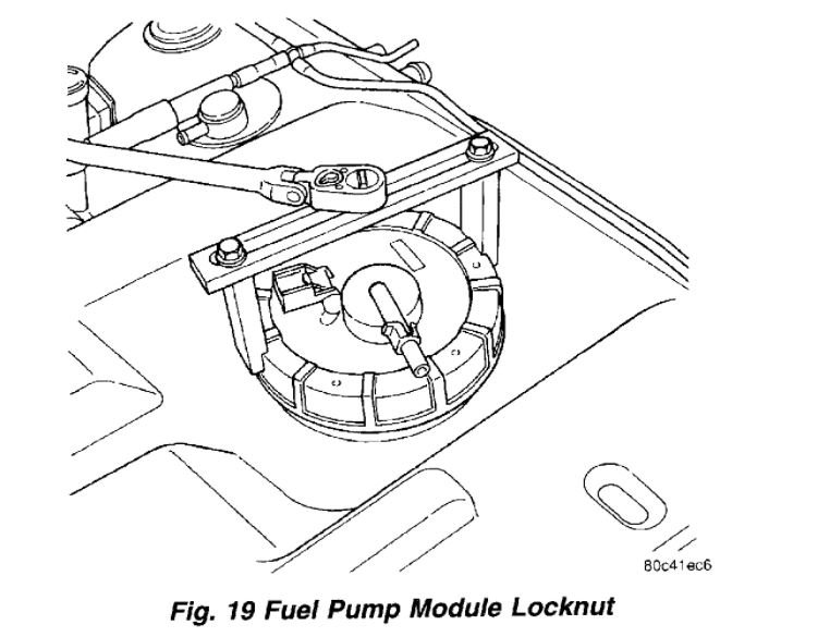

Fig.19 Fuel Pump Module Locknut
8. Using Special Tool # 6856 Fuel Pump Module. Ring Spanner, remove locknut to release pump module (Fig. 19).
WARNING: the fuel reservoir of the fuel pump module does not empty out when the tank is drained. The fuel in the reservoir may spill out when the module is removed.
9. Remove fuel pump module and seal from tank. Discard seal.
