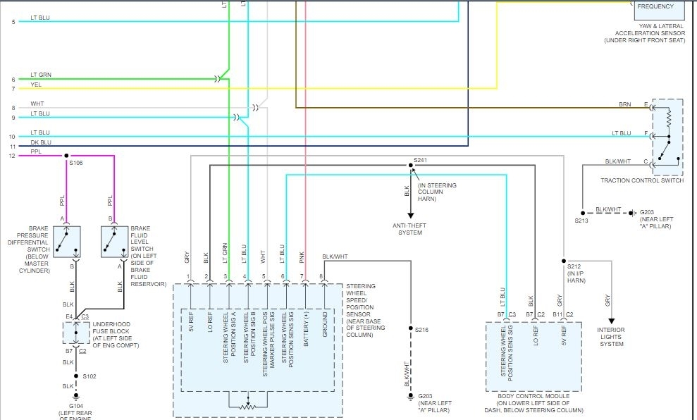

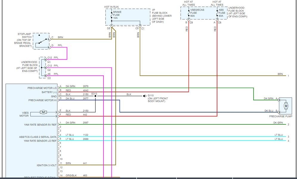

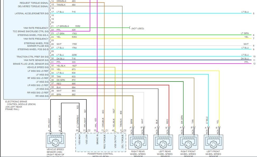

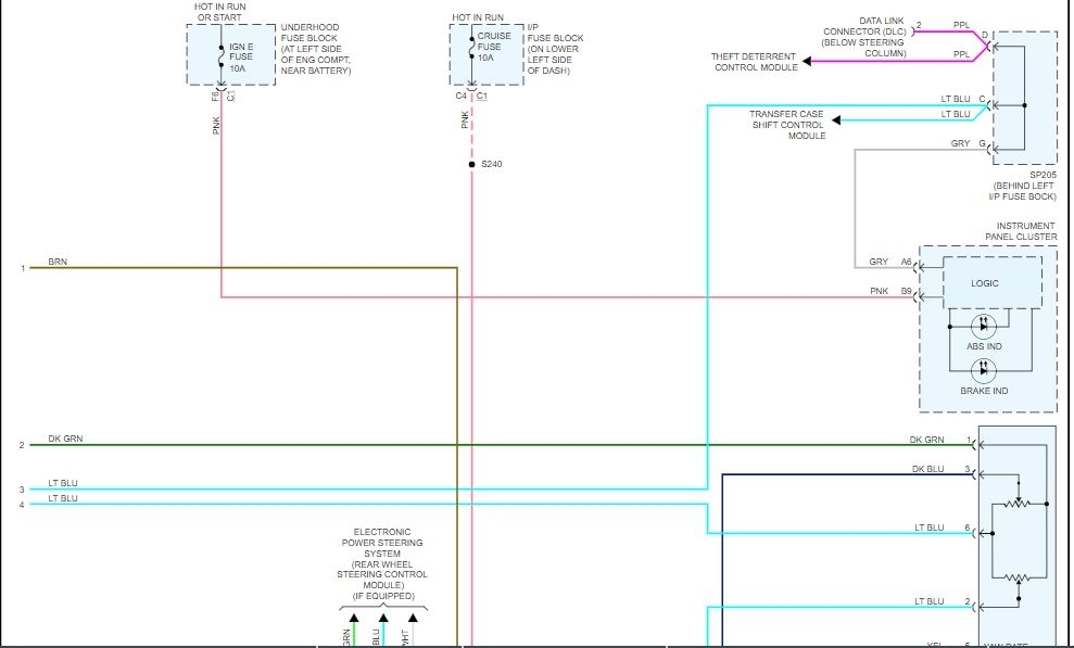

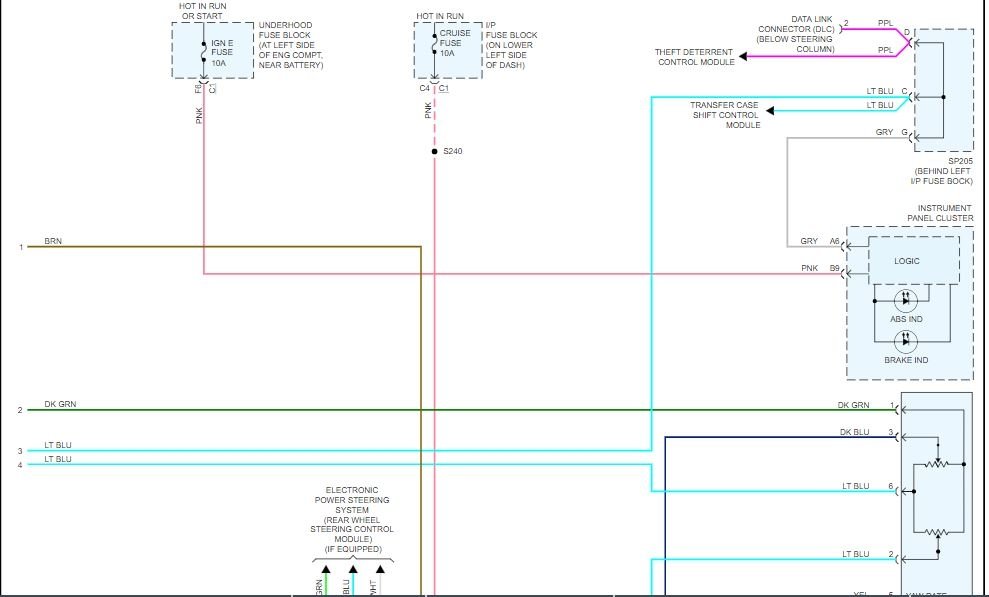

Okay, I posted the description of the system and how it works with ABS and traction control issues. When you disable that system, it disables traction control. When you disable the traction control, it will default to 2 wheel drive.
I attached the wiring diagram for the system as well. It will default to 2 wheel when there is an issue.
