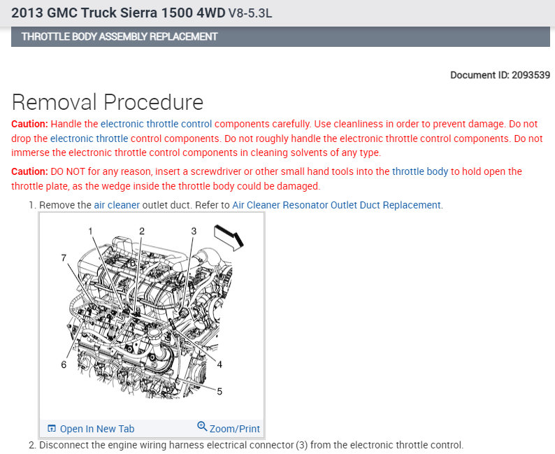

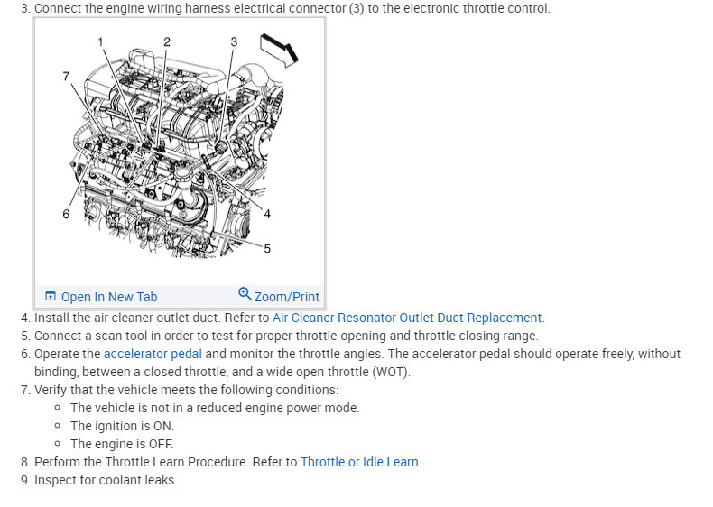

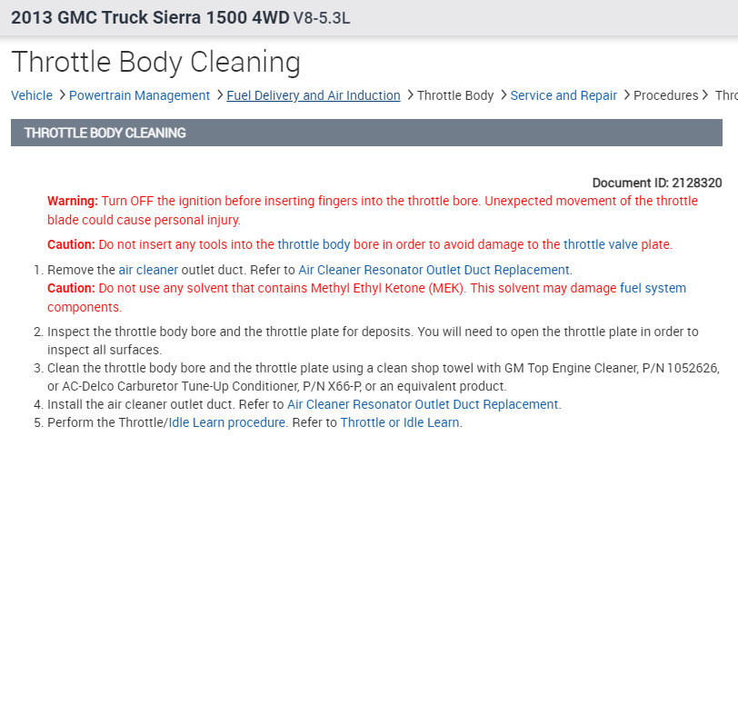

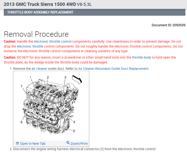

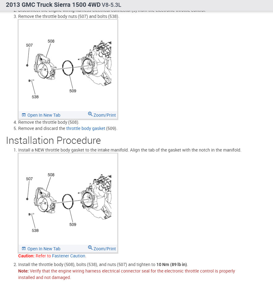

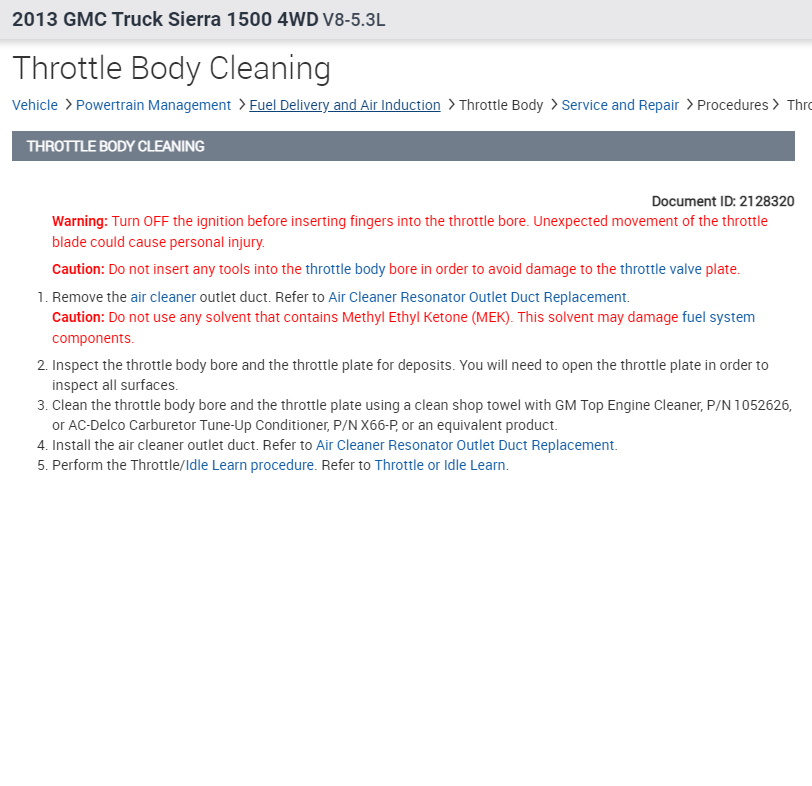

stability track light on disconnected battery overnight truck worked fine no light on, then after driving for 5 minutes or less light back on and truck in limp mode or I guess you can call it where it has no speed/acceleration.
