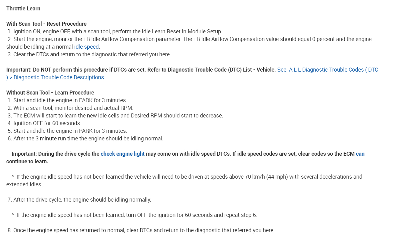

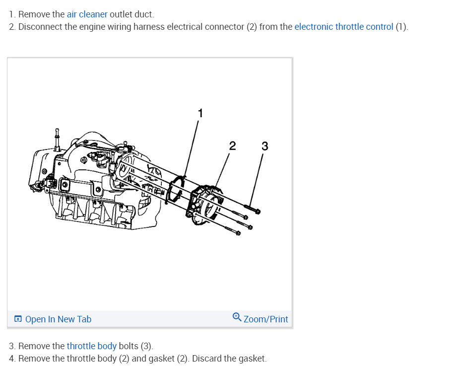

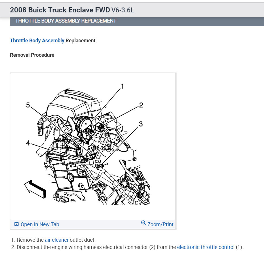

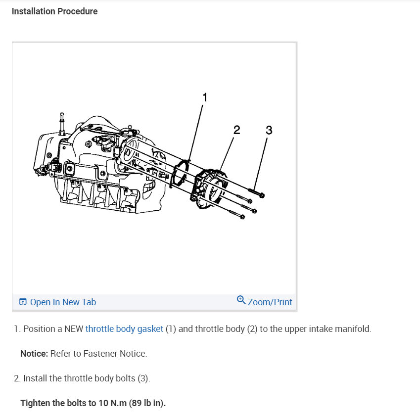

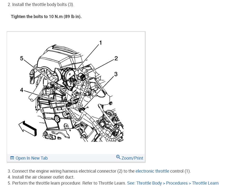

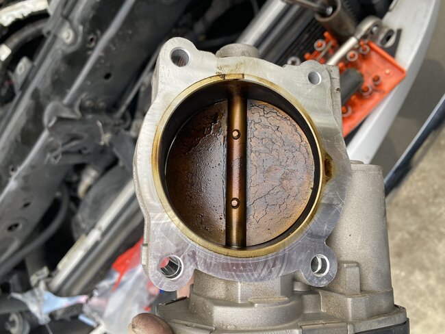

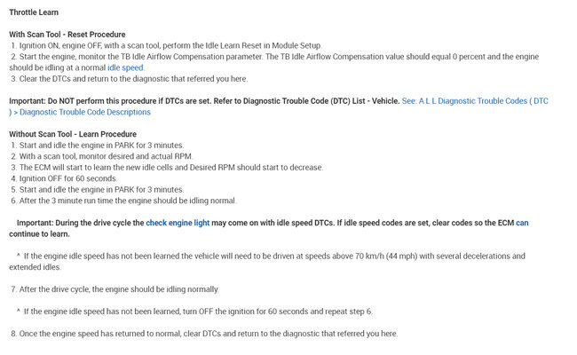

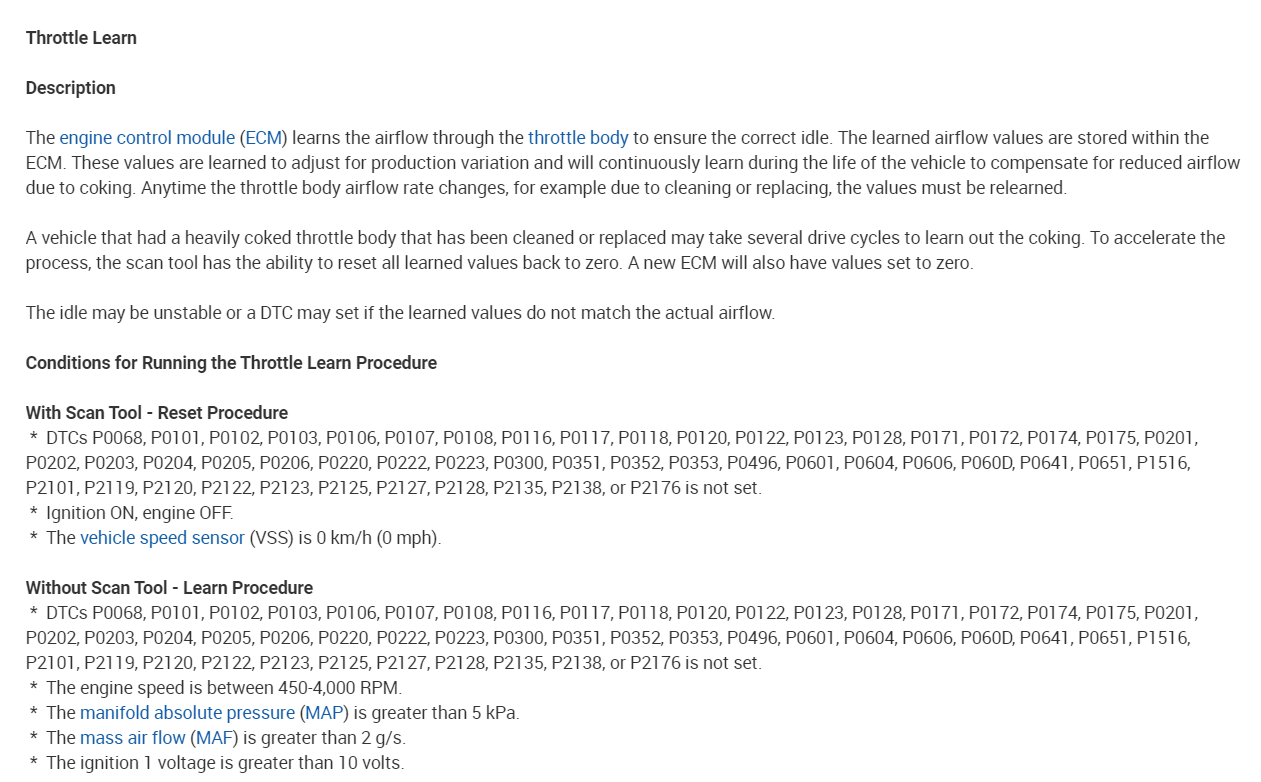

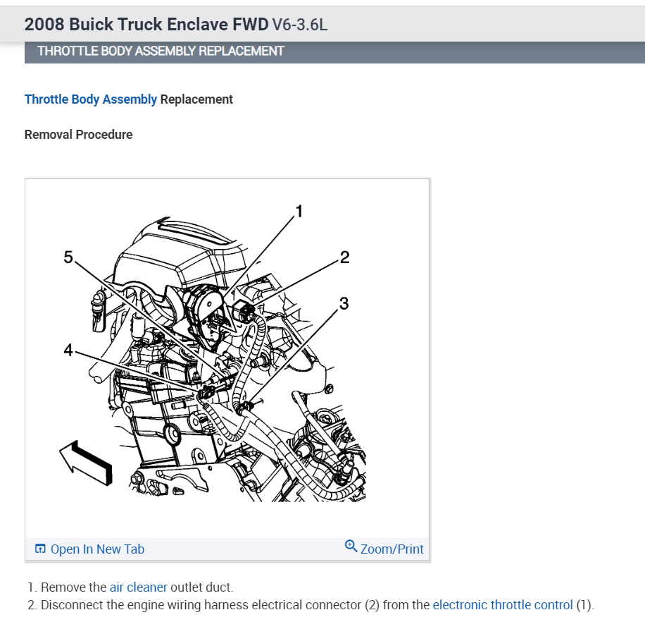

Are the ones I think ae causing the problems, I would service the throttle body first and then clear all codes here is a guide to help walk you through the steps and instructions for your car in the images below.
If you leave the wiring connected you should not need to relearn the throttle actuator. Check out the images (below). Let us know what happens and please upload pictures or videos of the problem.

That did the trick. I tried to upload some pics and a video but it all disappears when I click reply. Tried 3 times to no avail.
