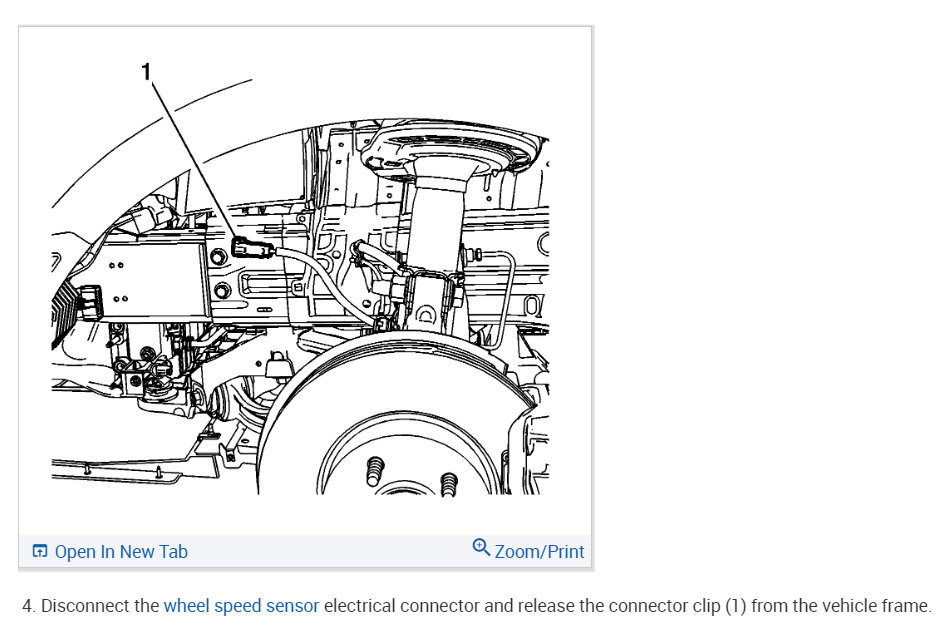

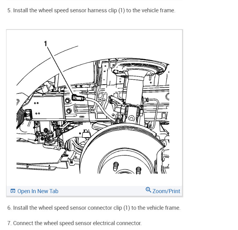

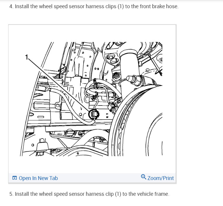

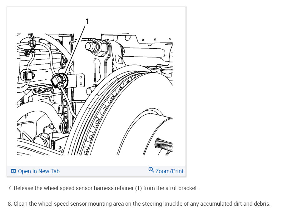

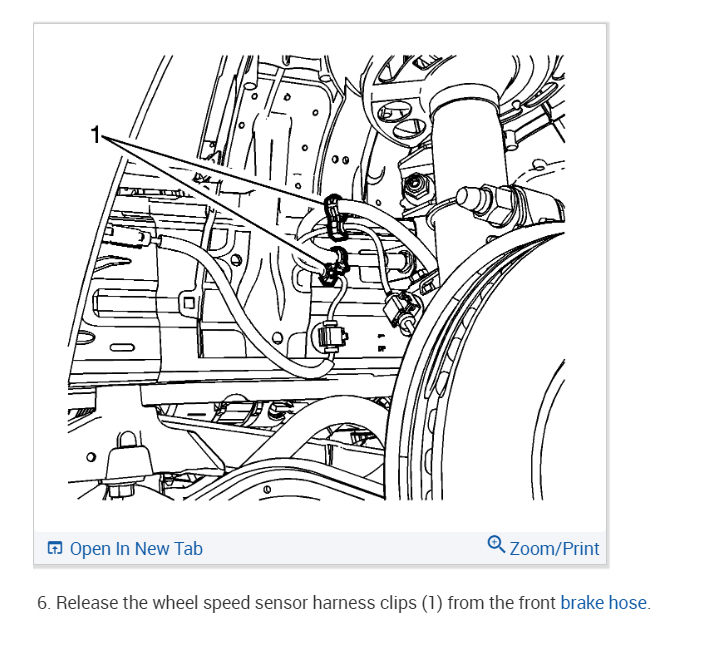

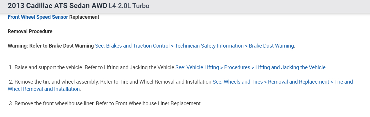

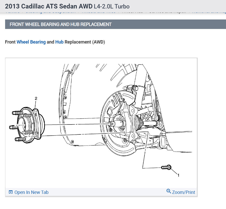

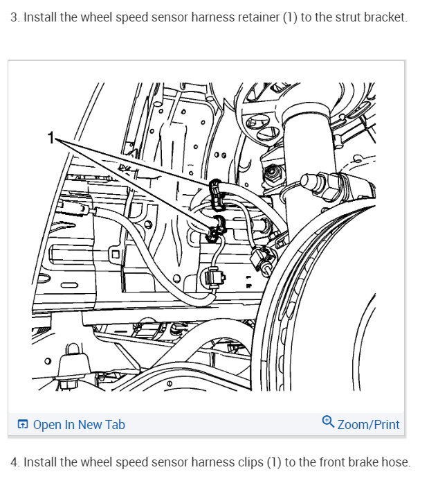

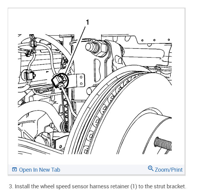

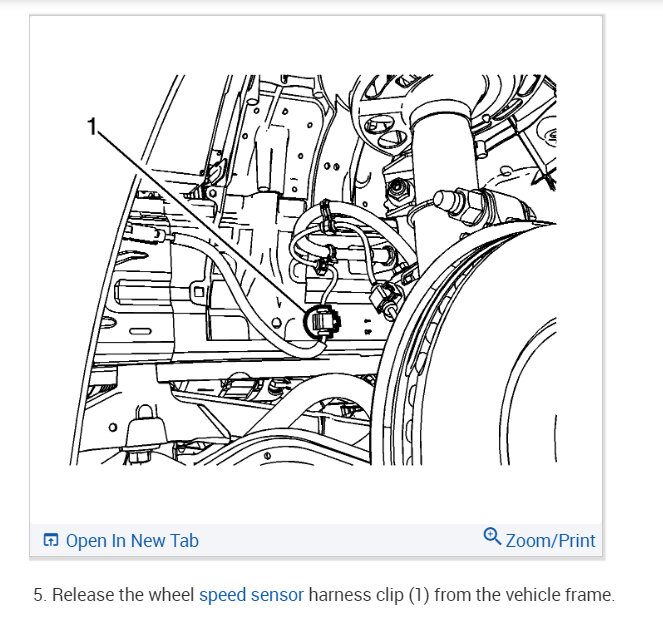

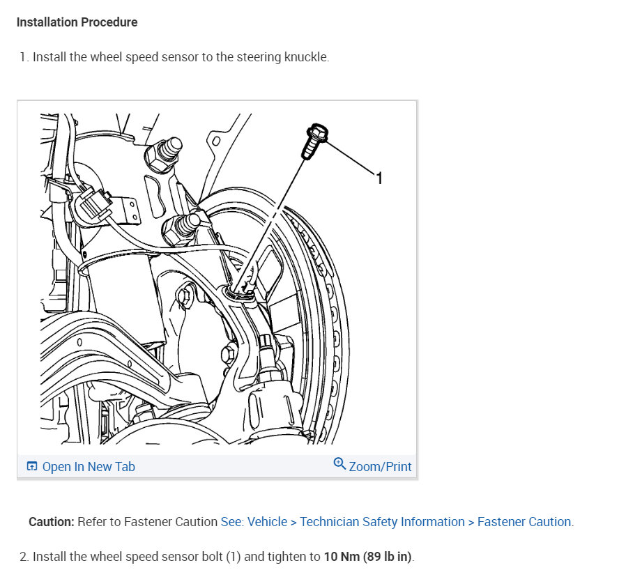

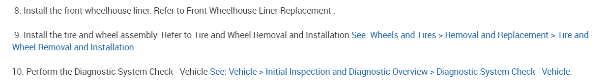

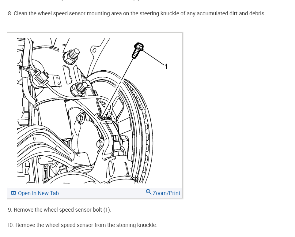

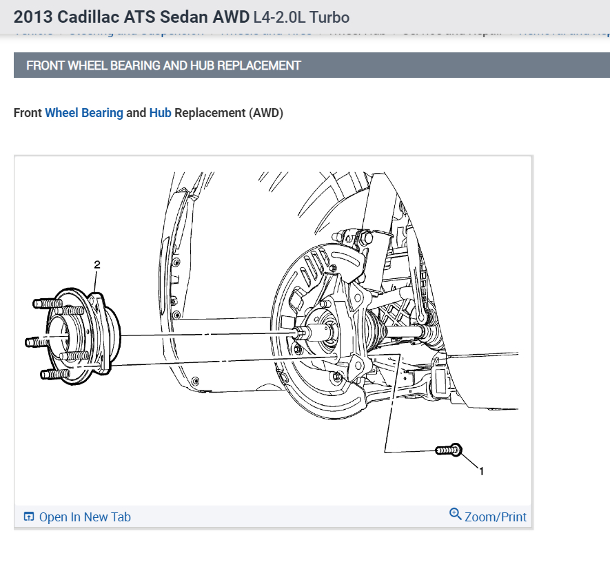

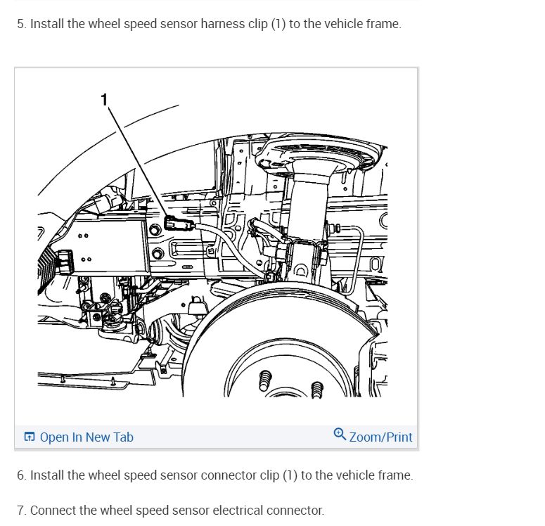

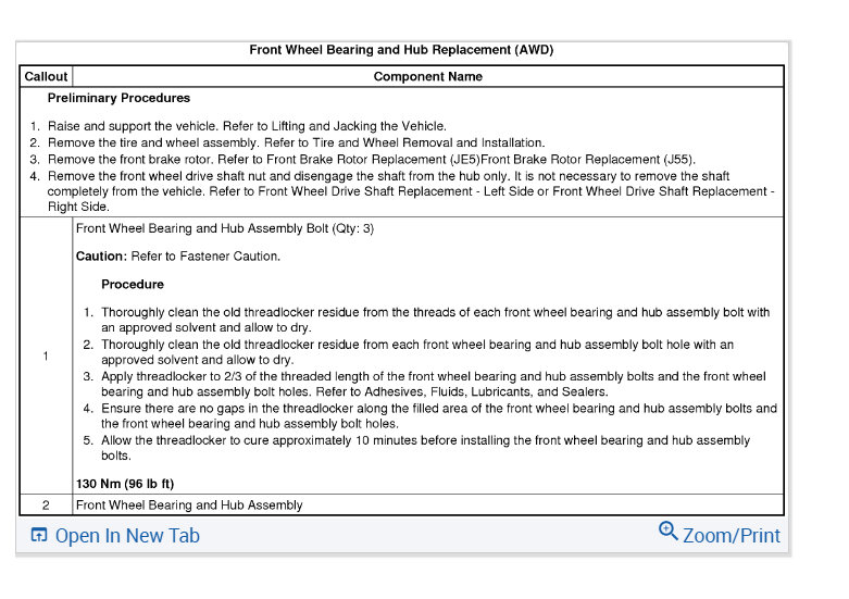

Sometimes it is a front wheel bearing hub which houses the ABS sensor that causes the light to come on, the code will tell us which one it is. For this I have included the instructions on how to change the bearing hub out in the images below. Please let us know what happens and check the images below.
