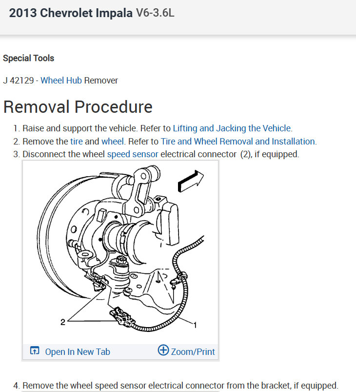

Everytime I turn the Stabilitract lights would turn off. Now I went down a bumpy road and the ABS light and Stabilitract lights are always on. Where do I start or what should I look for? I think one of the intermediate front axle needs to be replaced. Could this be causing the issue? I can go to AutoZone and get a OdbII reader and go from there.
Mar 21, 2025 at 8:38 PM
It sounds like you have a bad bearing hub or a wheel speed sensor, it is best to get a scan done to see which wheel is having the issue, also does the car make a humming noise while driving? This is a sign a bearing hub is going bad. Here is a guide so you can see what needs to be done:
https://www.youtube.com/watch?v=Pb6nXV-iamI

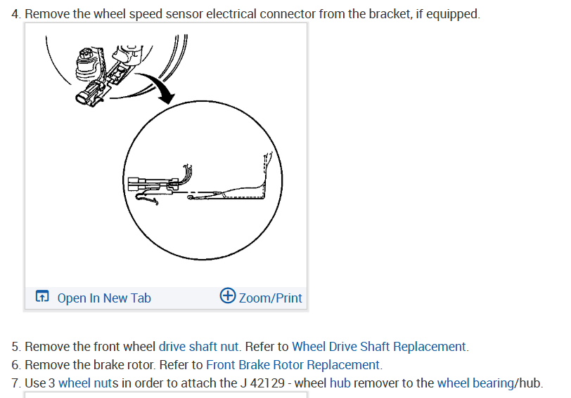

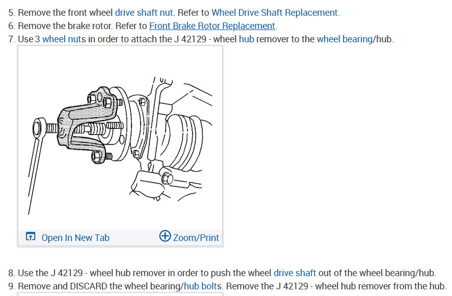

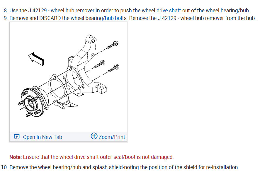

The sensor is inside the bearing hub FYI, here is how to change it out. Check out the images (below). Please let us know what happens.

Do you have pics to replace the wheel speed sensor for this car?
Apr 13, 2025 at 3:10 PM
Yes, the instructions on how to replace the wheel speed sensor are in the first post, you will need to replace the hub which the sensor is inside of. Let me know if you need help.
