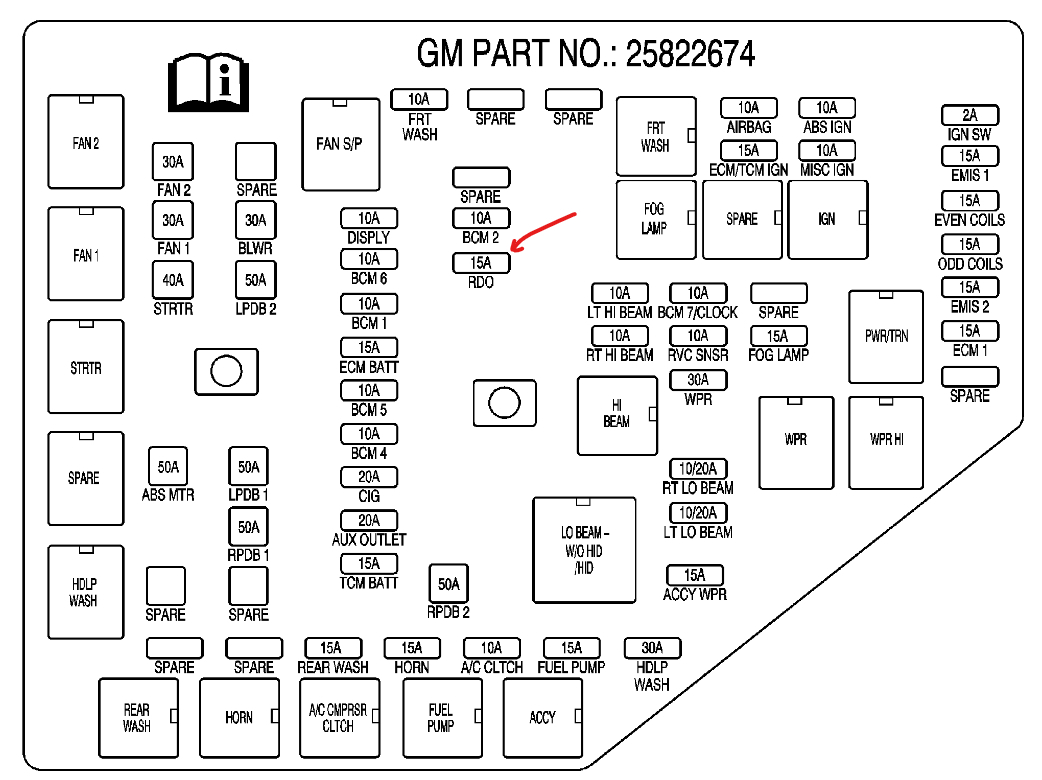

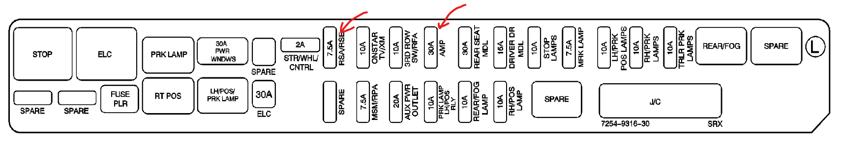

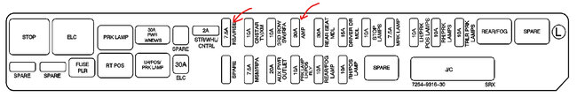

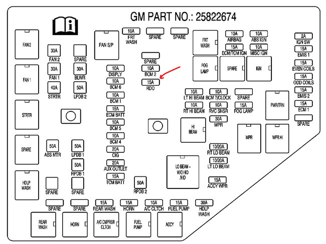

Please check the radio fuse in the under-hood fuse panel, the AMP fuse and RSA/RSE fuse in the fuse panel under the carpet near the rear seat. Also, I have seen the clock spring/spiral wire go bad, can I ask if the steering wheel control is working? The location of the fuses are listed in the images below. Check out the images (below). Please let us know what happens.

None of the fuses are blown and all controls on the wheel work, I think it might be the pre-amp in the radio. I've already ordered a new one and I'll update this when i receive and put the new one in.
