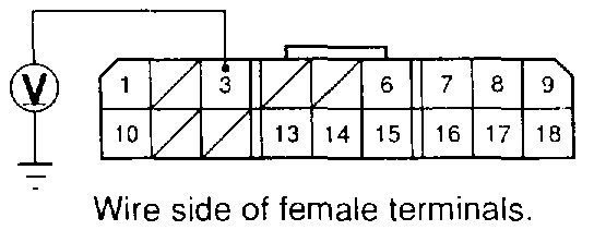

12. Connect a voltmeter between the No. 3 terminal (+) of the SRS main harness 18P connector and ground.
13. Turn the ignition switch ON .
Is there battery voltage?
YES - Go to step 14.
NO - Open in the SRS main harness (VB line); replace the harness.

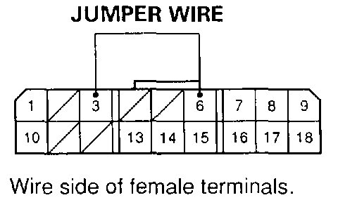

14. Connect the SRS main harness 18P connector terminals No. 6 and No. 3 with a jumper wire and backprobe adapters.
Does the SRS indicator light go off?
YES - Faulty SRS unit or poor contact at the SRS main harness 18P connector; check the connector. If the connector is OK, replace the SRS unit.
NO - Go to step 15.

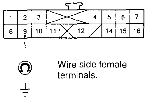

17. Disconnect the dashboard wire harness 16P connector from the gauge assembly.
SRS Main Harness 16P Connector
pic 3
18. Check resistance between the No. 9terminal of the dashboard wire harness 16P connector and ground. There should be 1 M Ohm or more.
Is the resistance as specified?
YES - Short to ground in the gauge assembly; replace the gauge assembly.
NO - Go to step 26.

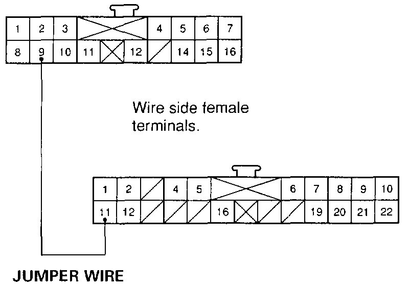

19. Turn the ignition switch OFF.
20. Remove the gauge assembly. Do not disconnect the connector from the gauge assembly.
21. Turn the ignition switch ON .
SRS Main Harness 16P And 22P Connector
pic 4
22. Connect the No. 9 terminal of the dashboard wire harness 16P connector and No.11 terminal of the dashboard wire harness 22P connector with a jumper wire.
YES - Go to step 23.
NO - Faulty SRS indicator light circuit in the gauge assembly; replace the SRS printed circuit board in the gauge assembly.

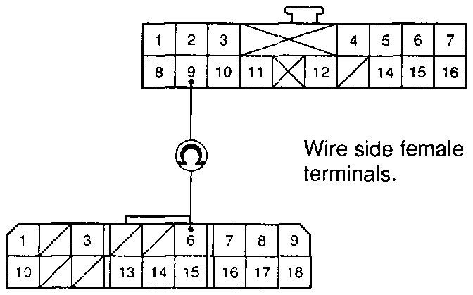

23. Turn the ignition switch OFF.
24. Disconnect the dashboard wire harness 16P connector from the gauge assembly.
SRS Main Harness 16P And 18P Connector
pic 5
25. Check resistance between the No. 6 terminal of the SRS main harness 18P connector and No. 9 terminal of the dashboard wire harness 16P connector; there should be 0 - 1.0 Ohm.
YES - Go to step 28.
NO - Go to step 31.

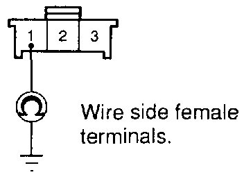

26.Disconnect the SRS main harness 3P connector from the dashboard wire harness.
SRS Main Harness 3P Connector
pic 6
27.Check resistance between the No. 1 terminal of the SRS main harness 3P connector and ground. There should be 1 M Ohm or more.
YES - Short to ground in the dashboard wire harness; repair the dashboard wire harness.
NO - Short to ground in the SRS main harness; replace the SRS main harness.

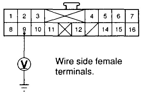

29. Connect a voltmeter between the No. 9 terminal (+) of the dashboard wire harness 16P connector and ground.
30. Turn the ignition switch ON , wait for six seconds, then measure voltage.
Is there 8.5 V or more?
YES - The problem corrected itself after disconnecting and connecting the connectors. Be sure all terminals make good contact, and recheck the system (see Troubleshooting Intermittent Failures)
NO - Poor contact at the SRS main harness 18P connector; check the connector.

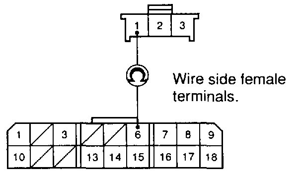

31. Disconnect the SRS main harness 3P connector from the dashboard wire harness.
SRS Main Harness 18P Connector
pic 8
32. Check resistance between the No. 6 terminal of the SRS main harness 18P connector and No. 1 terminal of the SRS main harness 3P connector; there should be 0 - 1.0 Ohm
YES - Open in the BLU wire of the dashboard wire harness; repair the dashboard wire harness.
NO - Open in the SRS main harness; replace the SRS main harness.
