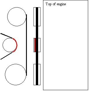

Another way to search for this is easier to do than to describe, so I drew a sad drawing that might help. When you look perfectly straight down from over the belt, you should only see it on the highest pulleys. In my drawing, the belt can be seen peeking out to the front just a little. That is the part shown in red. This could be the water pump, or more commonly, an idler pulley. It is sticking out because it is off-center on that pulley. Tension-er pulleys swivel on a mounting bracket, and that is a good place for wear to occur that lets the arm tip. Solidly-mounted idler pulleys can develop slop in the bearing that lets the pulley tip.
