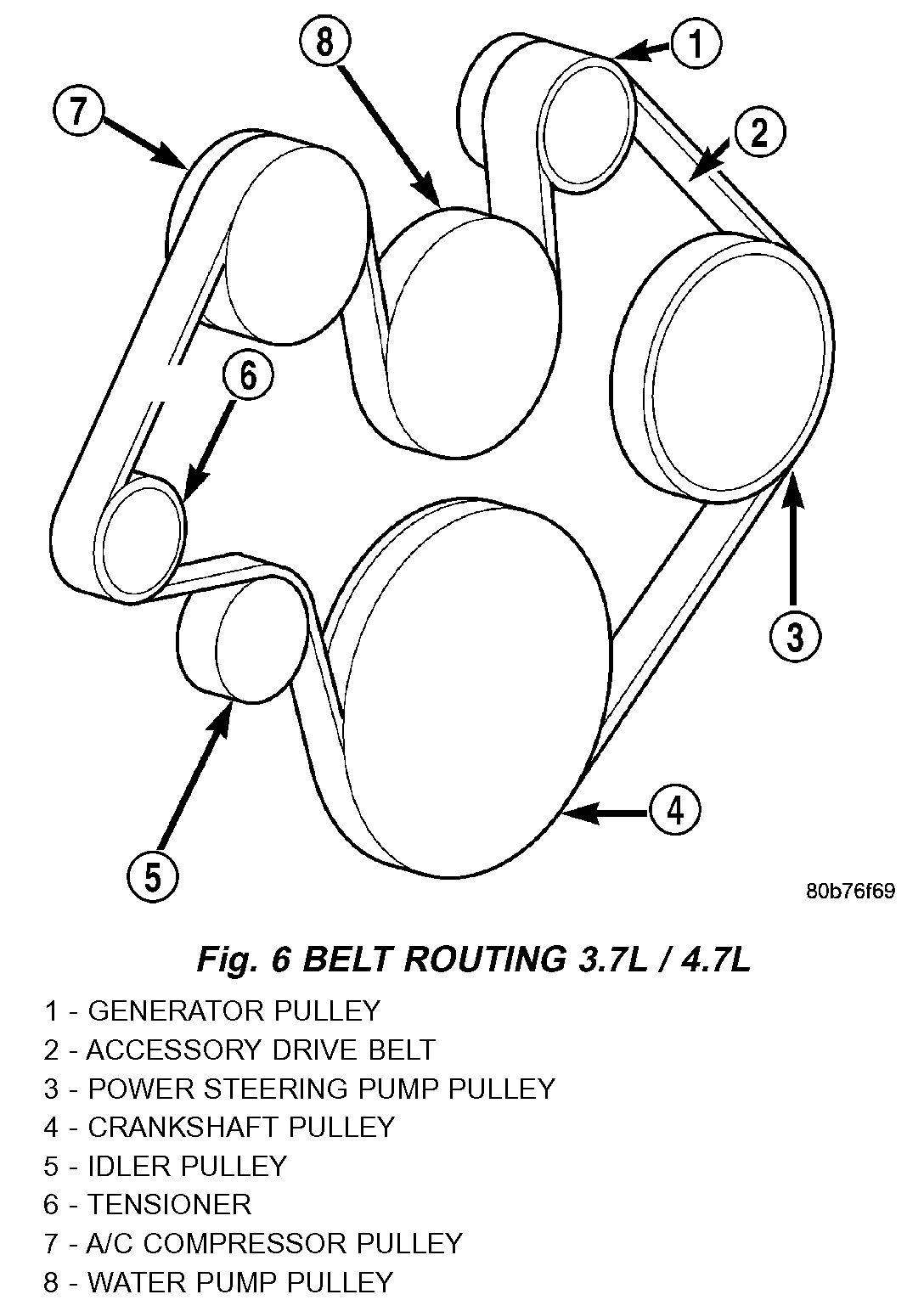

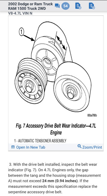

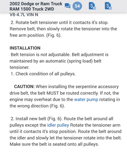

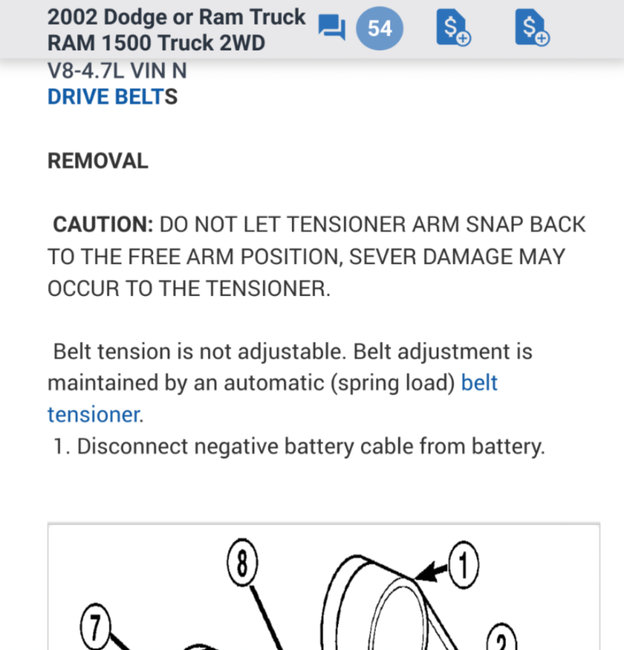

As for specifics to your truck, there are 2 v8 engines available for it. The 4.7L v8 and the 5.9L v8. I'll dig up AllDatas information on both engines so you can see where the tensioner is in a separate post shortly. Here is the information for the 3.7 and 4.7L engines.
Apr 22, 2021 at 5:00 AM

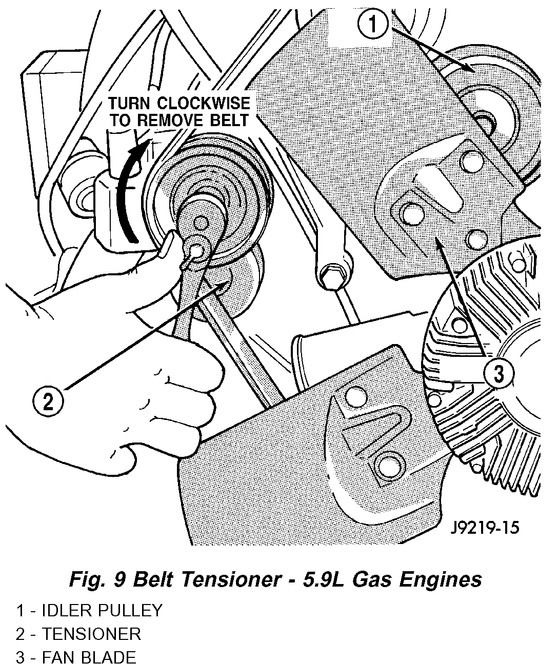

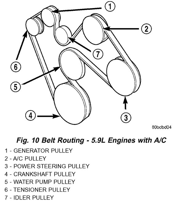

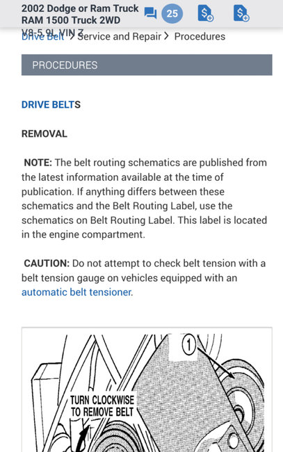

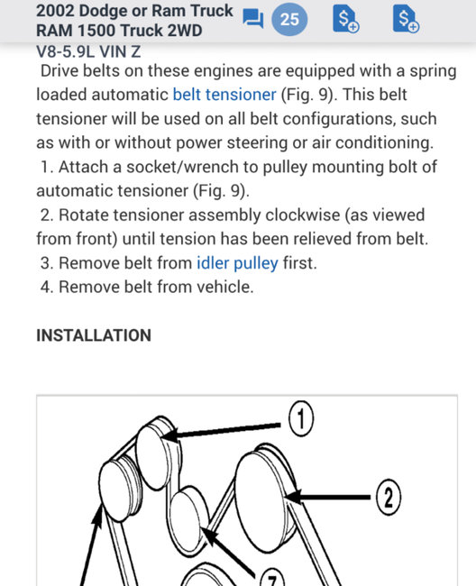

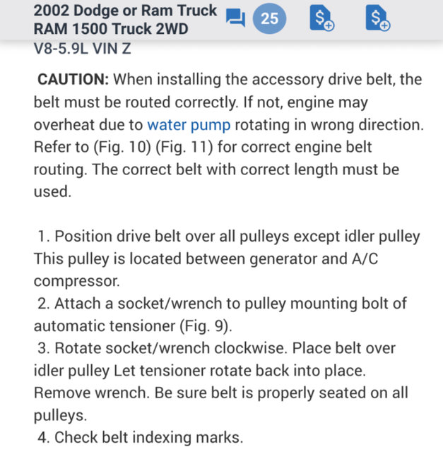

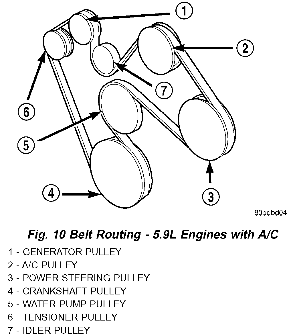

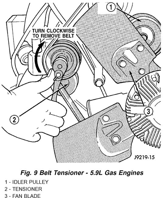

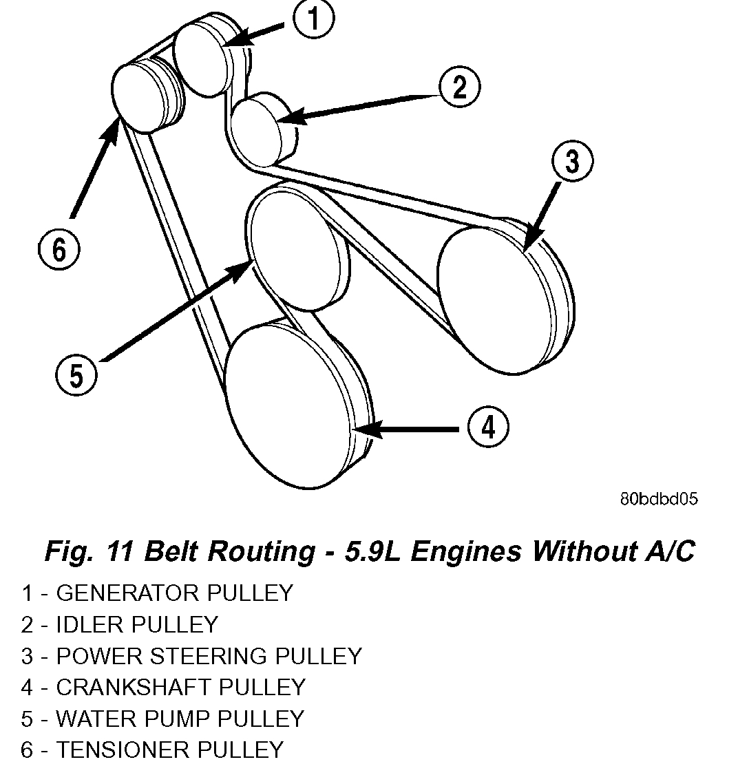

And here's the information for the 5.9L engine.
Let us know what you find and thanks for using 2CarPros!
