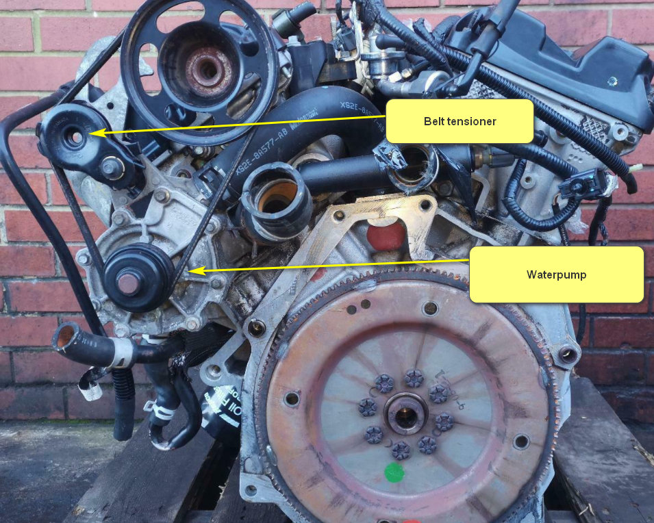

It sounds like you might have an issue with the water pump or drive belt tensioner These are the only engine peripherals which are located on the drivers side. Please see picture below.
Easiest way to check if the water pump or belt tensioner a noisy is to use a stethoscope or long screwdriver. With the engine running carefully touch the mounting bracket of the belt tensioner or the water pump housing and listen as to which part makes the noise. Mind the drive belt, do not touch any rotating parts!
A good guide on how to diagnose noises is below.
