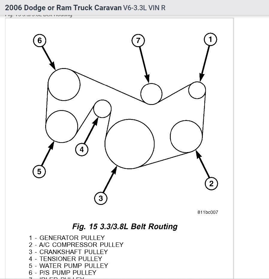

I have a very loud squealing noise coming from around the belt area. I’ve replaced the water pump, power steering pump, pulley bearing, harmonic balancer, and tensioner pulley bearing. I honestly don’t know what the problem is anymore. I also might add that the A/C in my vehicle does not work as well. I have no clue if that has something to do with it.
