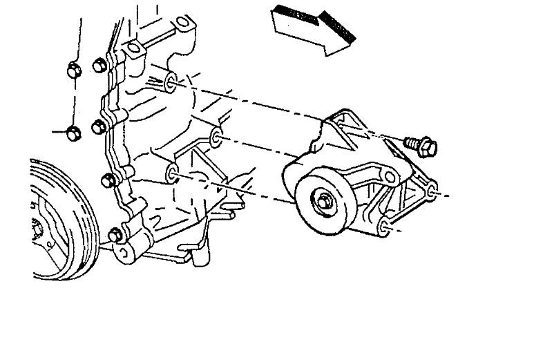

2.4
Removal Procedure
1. Disconnect the negative battery cable.
2. Remove the accessory drive belt.
3. Remove the generator assembly.
4. Raise and support the vehicle.
5. Remove the oil filter.
6. Remove accessory drive belt idler pulley.
6.1. The A/C compressor mounting bolt.
6.2. The A/C compressor. Position it aside.
7. Remove the tensioner.
Installation Procedure
1. Install the tensioner.
Tighten
Tighten the tensioner nut to 50 N.m (37 lb ft).
2. Install accessory drive belt idler pulley.
2.1. The A/C compressor.
2.2 The A/C compressor mounting bolts.
Tighten
Tighten the bolts to 54 N.m (40 lb ft).
3. Install the oil filter.
4. Lower the vehicle.
5. Install the generator assembly.
6. Install the drive belt.
7. Connect the negative battery cable.

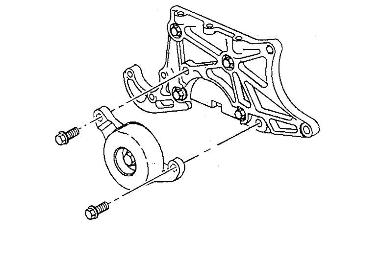

2.2
REMOVAL PROCEDURE
2. Remove the drive belt.
3. Remove the tensioner bolts.
4. Remove the tensioner.
INSTALLATION PROCEDURE
2. Install the tensioner bolts. Tighten the bolts to 50 N.m (37 lb ft).
3. Install the drive belt.
4. Connect the negative battery cable.
