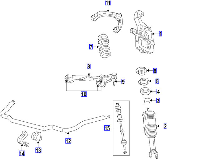

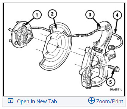

I didn't see the video? Can you please reload it? Here is a guide that can help and information on the problem as well. Check the images below.
Check out the images (below). Let us know what happens and please upload pictures or videos of the problem so we can see what's going on.

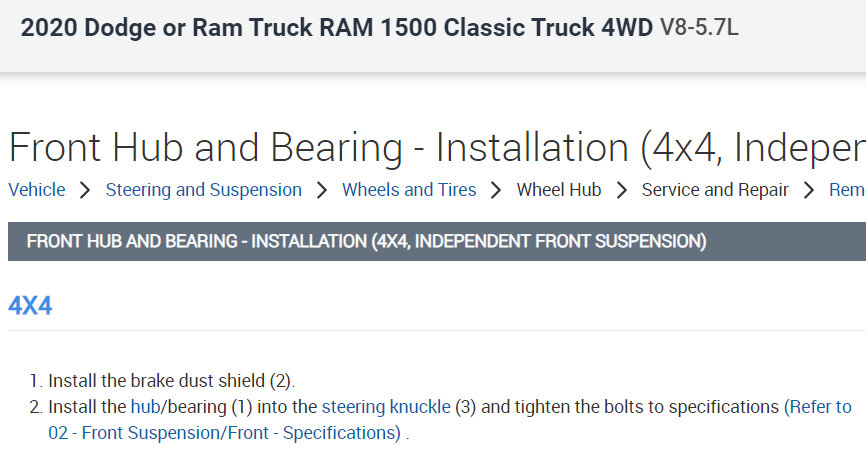

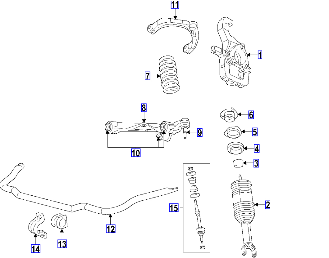

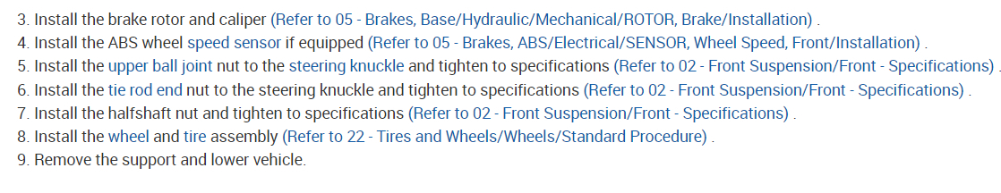

To me it sounds like the bearing hub can be bad, do you have large wheels on it? If so, this is how to change them out. Check out the images (below). Please upload pictures or videos in your response to any problems so we can see what to help you with.
