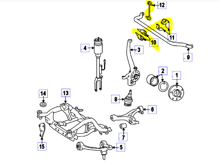

Based on your description, my first suspect would be the stabilizer bar bushings or the stabilizer links.
If you look below, I attached an exploded view of the front suspension. I highlighted the parts I'm referring to. Check these and let me know what you find.,
See pic below.

sounds good i'll check and report back, thanks.

It sounds like you live near me. LOL The weather is the same here. Also, you are exactly right. When it gets cold, that is when you will hear a dry bushing the most. I have an Audi that does the same thing, and it drives me crazy. I just never have the time to identify which bushing and to fix it. My first suspect is either a sway bar bushing or even a ball joint.
If possible, spray the sway bar bushings really well with a lubricant to see if that keeps it from coming back for a while.

You may want to consider removing the bushings for the stabilizer bar and inspecting them. They aren't expensive.
