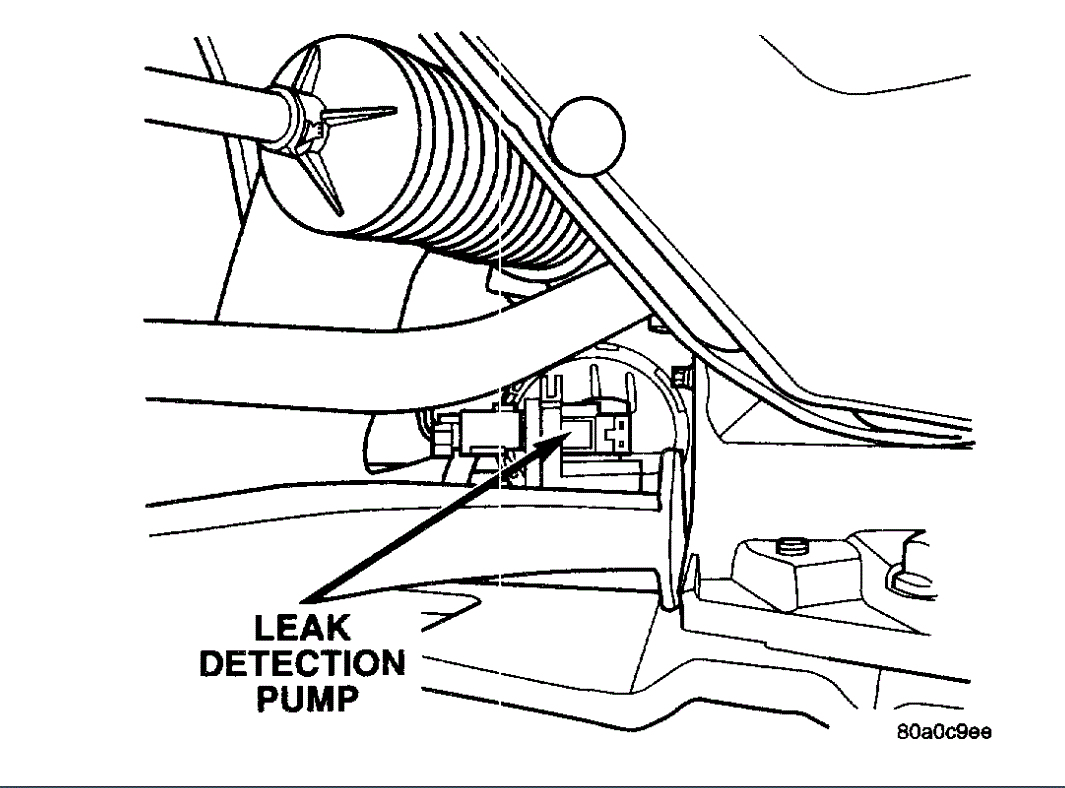

The purpose of a leak detection pump is to pressurize the fuel system checking for leaks. It closes the EVAP system vent so the system can be pressurized and tested for leaks. I attached a pic below of it. Your vehicle does have one under the engine (passenger side).
The idea that it doesn't change with vehicle or engine speed really limits things. As Steve mentioned, the pump could play a role. Take notice if that is the area it is coming from and let us know. By the way, Steve, good thought on this one.

Can the leak detection pump make a type of chirp or any other strange noise when it's getting old? And, if yes, could the chirping of my van possibly be the leak detection pump?
Mar 19, 2020 at 3:30 PM
Interestingly, yes it could. It's a pump. To further the idea, it would not be affected by engine speed or vehicle speed. Could it be? Sure it could. However, don't just replace it without checking to see if that is where the sound is coming from. If you find it is, we will provide directions.
