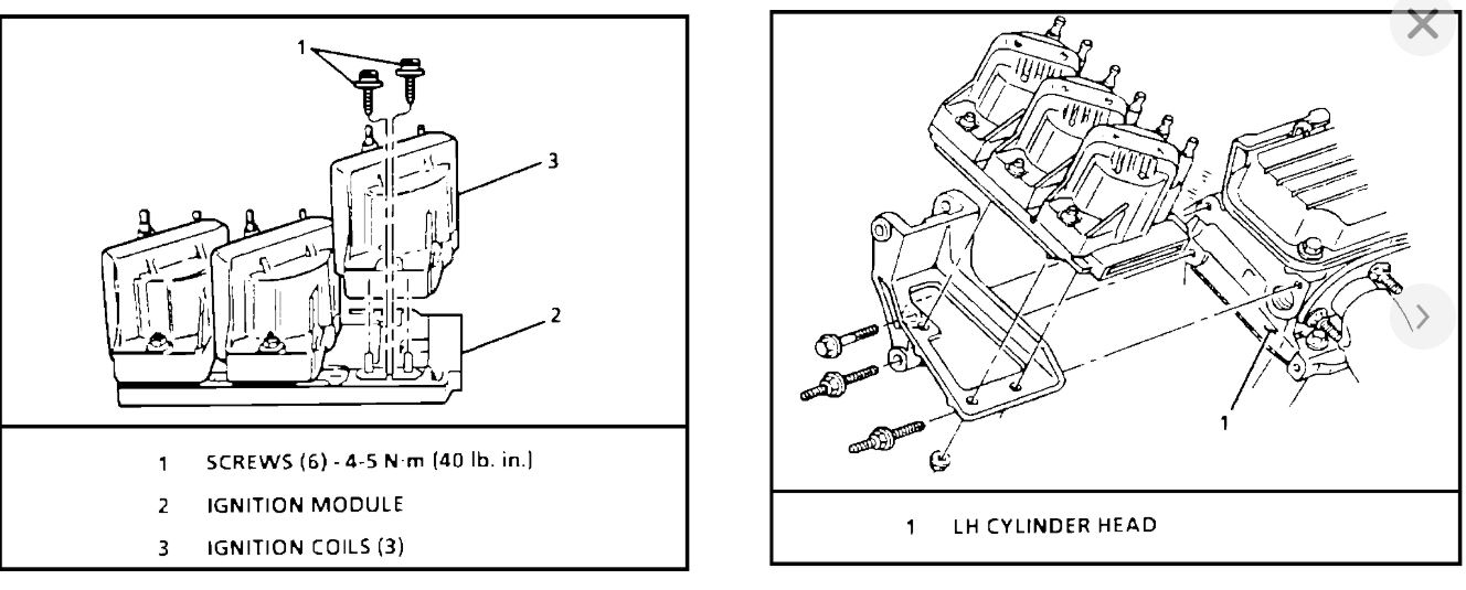

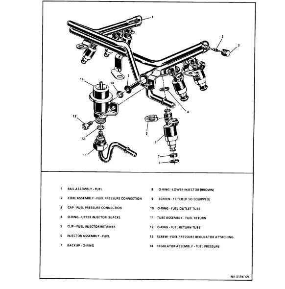

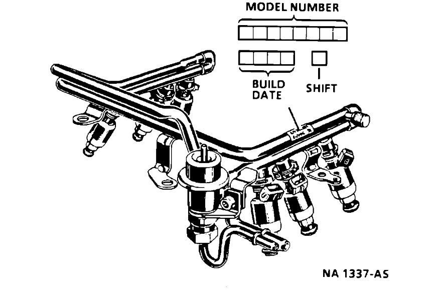

My car sputters horribly when starting off from a complete stop or if I even give it good gas, especially at mid throttle. I’ve changed fuel pump, fuel filter, TPS, spark plugs/wires. I checked coils and they’re fine. I’ve used seafoam a few times over the past few months, didn’t notice any changes. Help!
