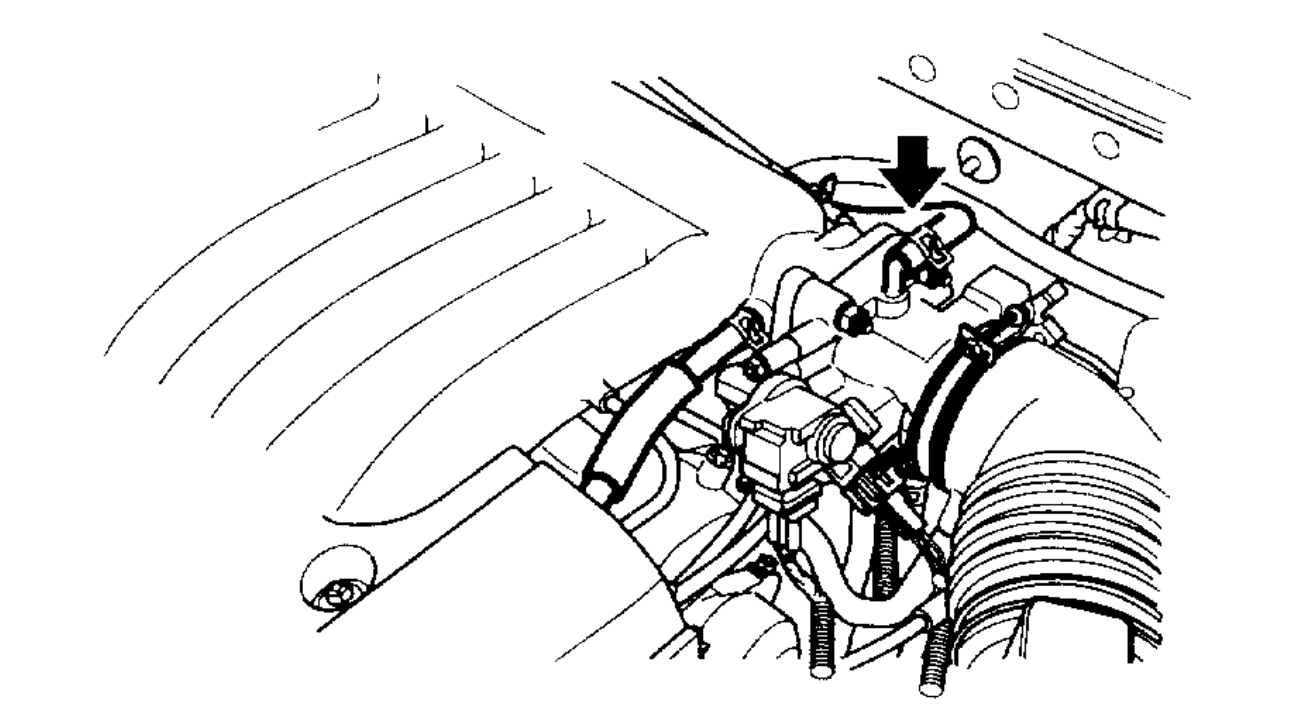

Okay, so I checked all the vacuum lines. All the hoses are good, but I could hear air leaking. On investigation I found what I believe is between the throttle positioning sensor, and another sensor air leaking out. There is another sensor right in front of the throttle positioning sensor. I don’t know exactly what it is. But in between the two I can feel air. Is it possible that the throttle positioning sensor is bad and it’s leaking out of there all of this is near the throttle body. I can’t see any other indication of where else it could be.
Jan 2, 2023 at 11:39 AM
Yes, the throttle bore can be worn allowing vacuum to leak out at the butterfly shaft. CAN you remove the throttle bore to confirm? Here is how to remove it, if it seems okay, please service the unit once it is removed.
Here is a guide to help:

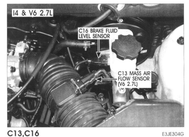

Can you upload a video of the engine misfiring so I can see what's going on? I would run the codes as well. You could have a cylinder that is low on compression.
please check out this guide to help us see:
https://www.2carpros.com/articles/engine-misfires-or-runs-rough
You might want to try to clean the MAF sensor or replace it.
here is a guide to walk you through the steps:
https://www.2carpros.com/articles/mass-air-flow-service
