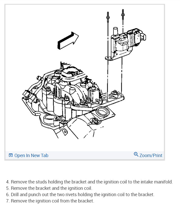

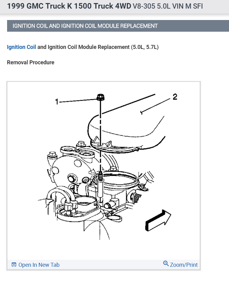

Lets run the codes to see what comes up and if no codes are present lets replace the ignition module and coil. here is how in the diagrams below:
