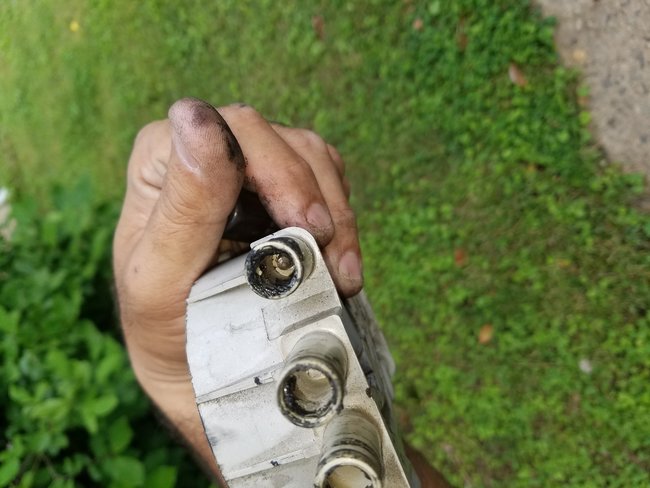

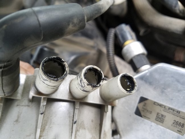

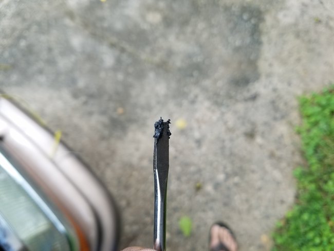

So I hadn't touched it in a few days. Raised the hood today and took the distributor cap off. Looking at the even side of the cap, I see this gunk down in the where the plug wires connect. I think the plug wires are getting hot on that side and melting in there. Would that be because the resistance in the wires is too high? I went ahead and ordered new wires and creamed the contacts inside the cap.

Good find, please order AC Delco stuff, you can find it on Amazon for cheap.

My wires came in yesterday. I put them in today, and it runs like a new car now. I swear it feels like I'm driving a Camaro compared to how it was. Funny thing is it finally threw a code this morning (before I put the plug wires in) for a random misfire (P0300). Anyways, thanks for all the help. I'll be back when something new pops up.
