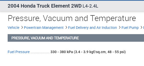

Now, when this is happening, are there any strange odors, sounds, or smoke from the exhaust? Also, I realize the fuel pump has been replaced, but have you confirmed fuel pressure is within the ma manufacturer's specifications? If not, we need to check that if there is no check engine light.
Here is a link that explains how it's done:
See pic 1 below for pressure specifications.

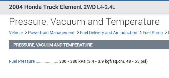

Let me know. Also, let me know if you have checked for engine vacuum leaks or if you have tried cleaning the throttle body.
See pic below.
