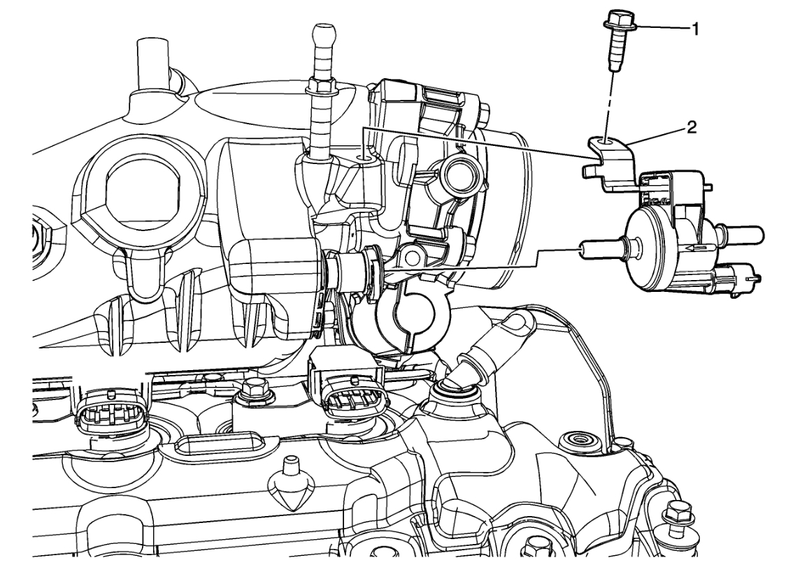

It sounds like the EVAP purge valve is stuck on. Here is the location so you can check it out. Remove the valve and try to blow through it, if you can the valve is bad and needs to be replaced. Check out the images (below). Please let us know what happens.
