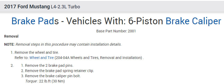

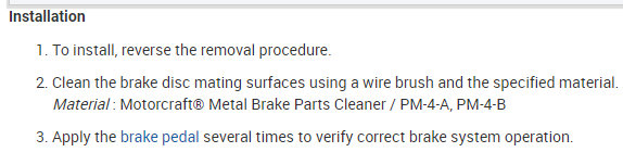

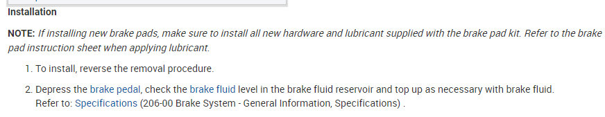

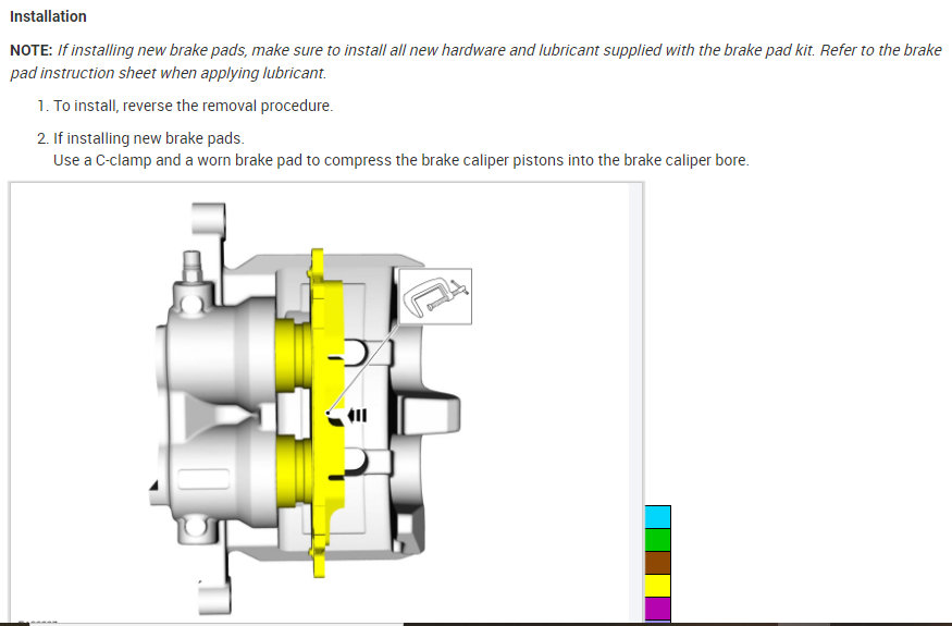

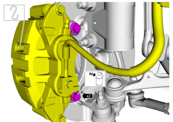

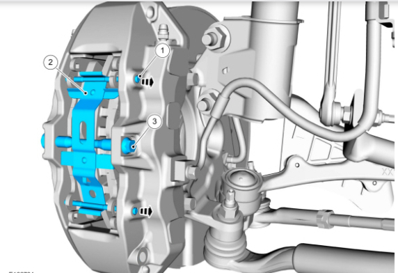

Hello, I'm Danny.

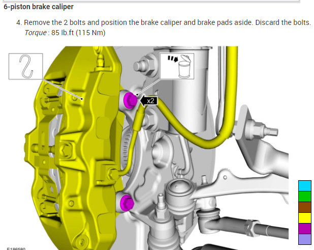

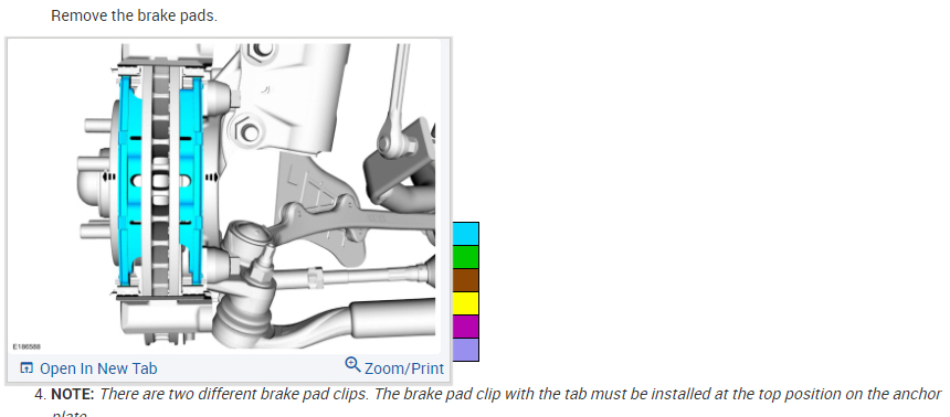

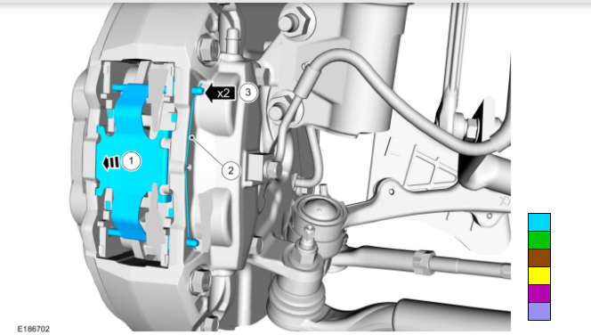

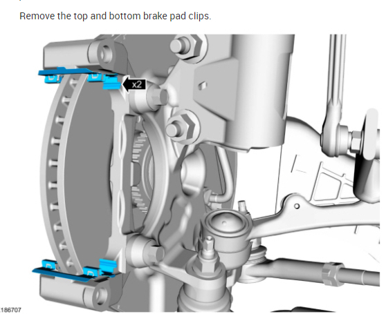

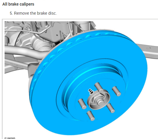

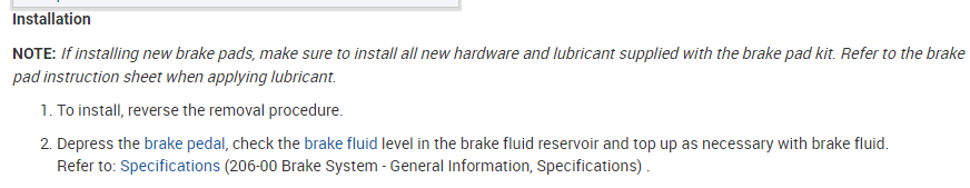

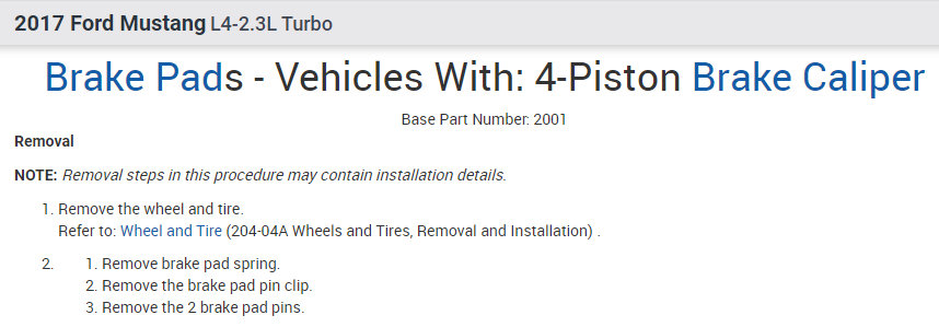

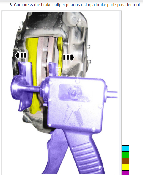

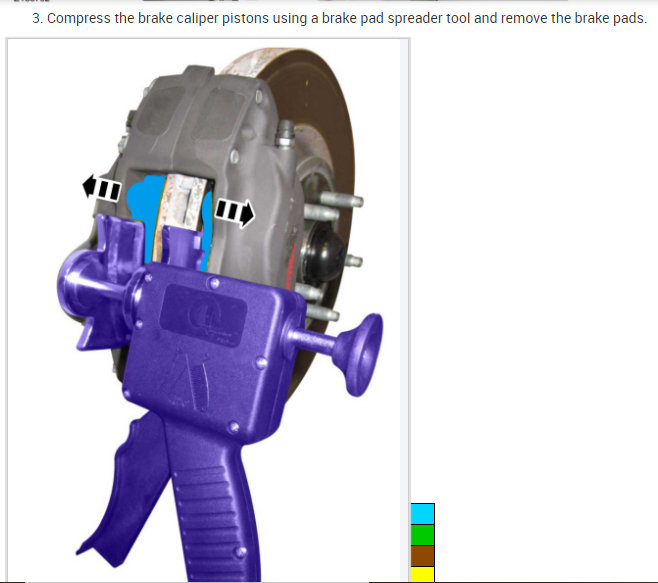

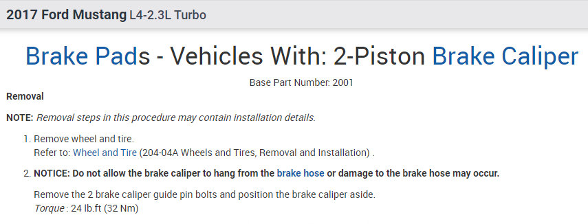

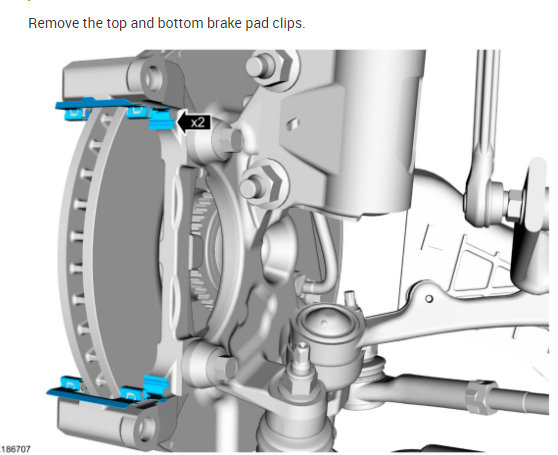

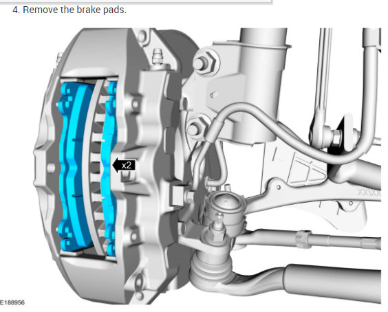

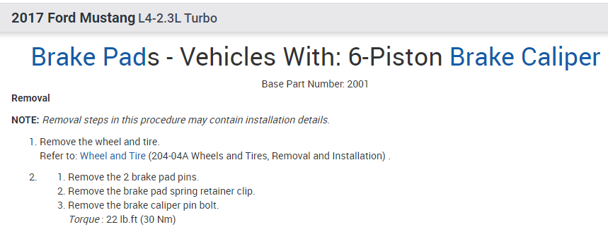

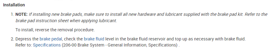

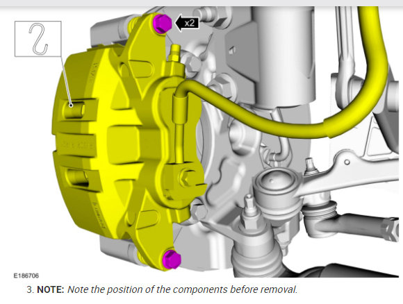

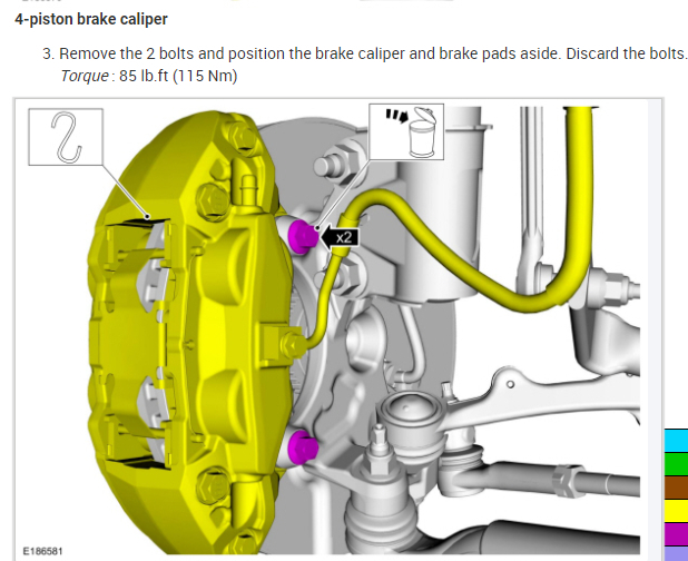

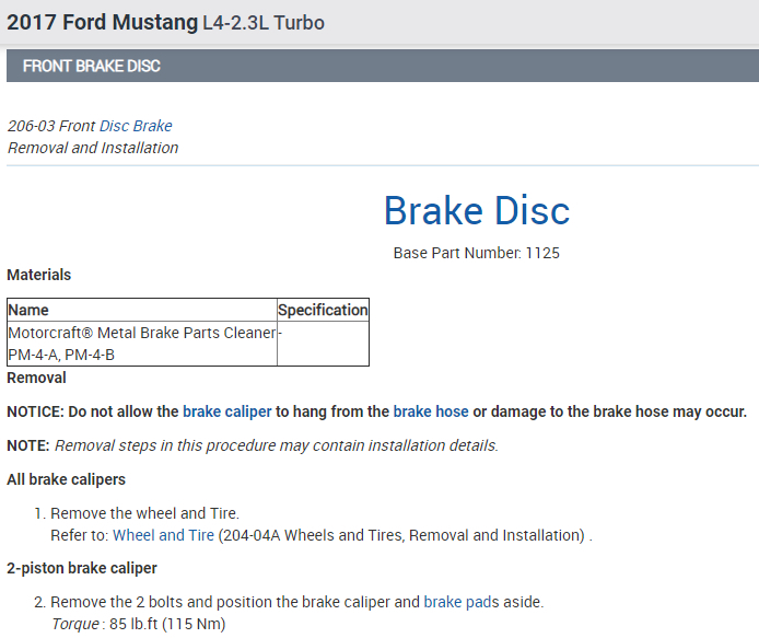

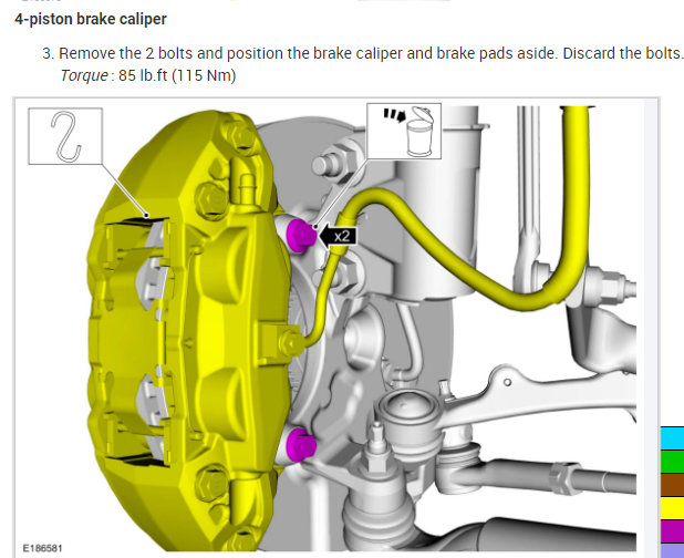

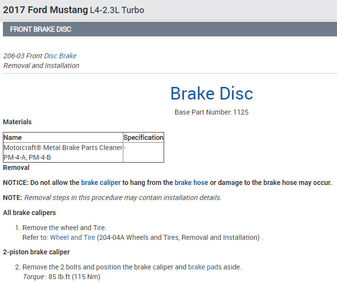

Here is the information you requested. This is a tutorial showing what is involved on how to change front brake pads and brake rotors:
I've attached picture steps below on how to change the front brake pads and rotors on your car. I've included the steps for the 2, 4, and 6 piston brake calipers available on your car. Hope this helps and thanks for using 2CarPros.
