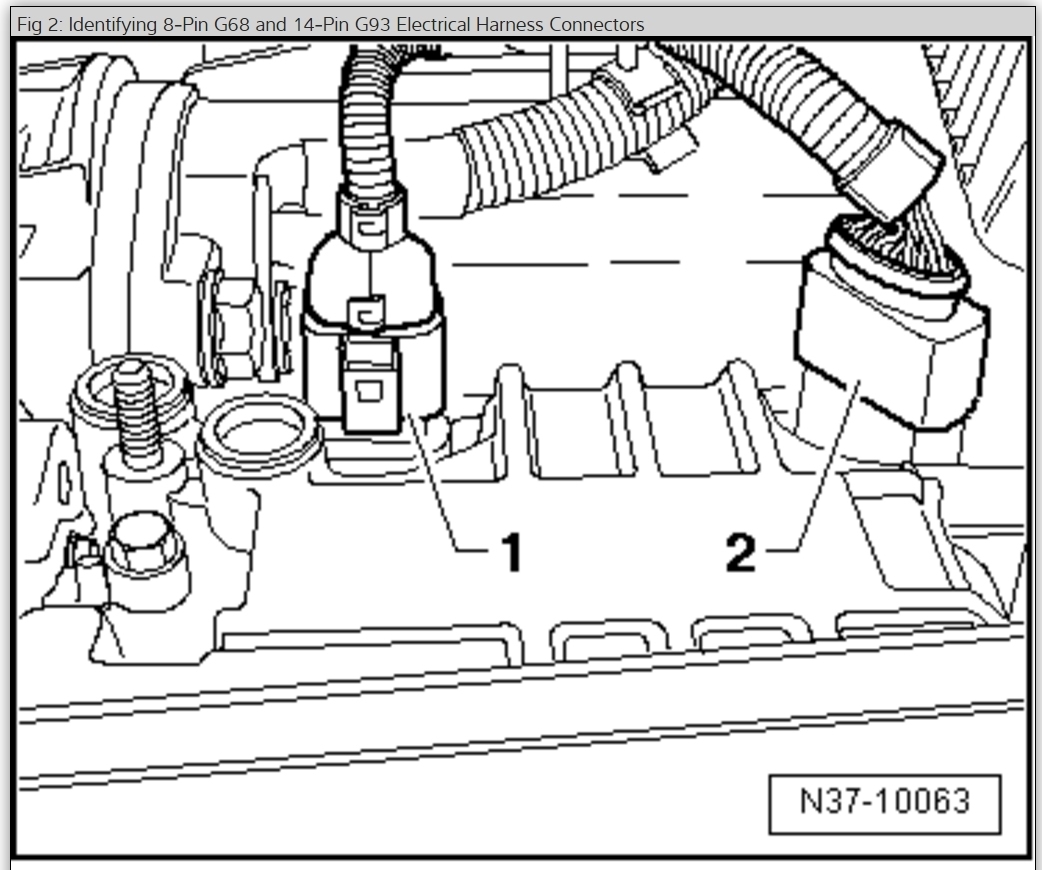

Sorry for the slow response we have been super busy, it seems a bunch of cars are breaking down lol,, here is the location of the speed sensor, it is actually called a transmission output speed sensor which controls the speedometer. Please let us know how it goes.

So I got your picture. Thanks so much. I'm not quite sure where these are located on the car. Can you give me some more information?

This picture would be from the top down. Please let me know what happens.

So I hate too be a pest but is it left side or right side facing the engine compartment?Also just a bit more information to give you. We had a mechanic do a full system scan & during the scan he was able to activate all the cluster gauges except the speedometer with his computer. Also the cruise control still works. Thought this info might be helpful
