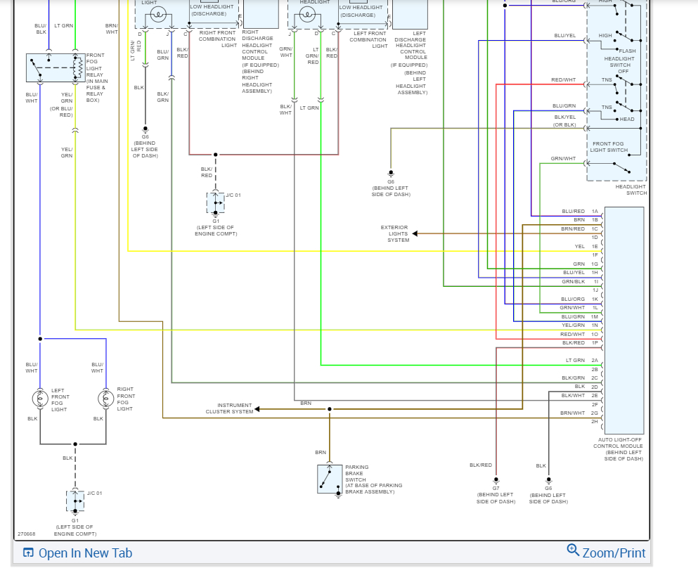

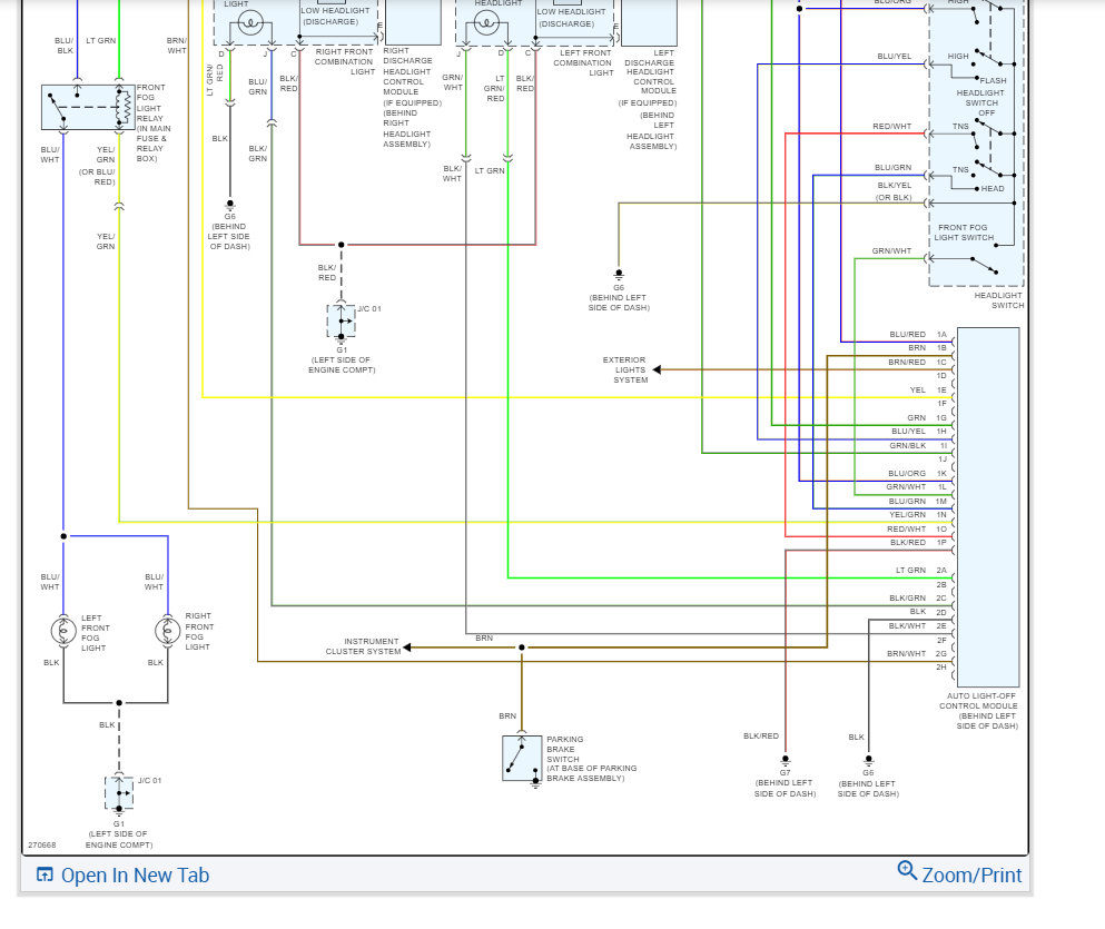

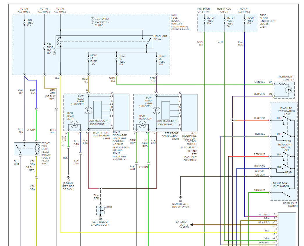

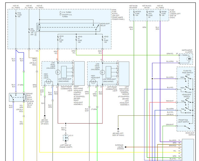

The trigger wire should be powered when the lights are on correct? It must have power all the time or the relay is stuck. here is a guide to help test it and the headlight wiring diagrams below so you can see how the system works:

Yes, i want the lights to power on when i turn on my high beams, aka i plug the trigger into the high beams and when they switch on, it should provide power for the relay right? The relay is connected to battery positive and negative terminals, as well as auxiliary lights and the trigger wire to the high beams.
Is it possible to find the wire for the high beams that hasn't yet entered the Auto Light control module? I think the ALCM might be the problem as it sends a different type of voltage instead of 12v on and 0v off?

Idid it! I had to do wire it the following:
12V from battery with fuse to relay shoe 30
Ground (sShoe 85) to high beam ground!
Trigger (86) to high beam fuse in engine bay fuse box!
87 (not 87a) to auxiliary lights.
It now works when i turn on the high beams and stay off when high beams are off!
