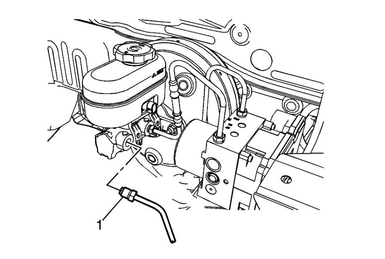

This sounds like the master cylinder is failing. The seals internally are not holding.
https://www.2carpros.com/articles/brake-pedal-goes-to-the-floor

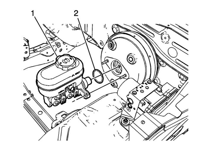

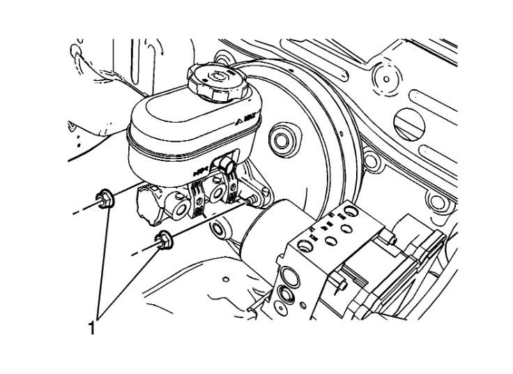

I would replace the master cylinder and flush the old fluid out of the system dirty fluid is what caused the seals to fail.
https://www.2carpros.com/articles/how-to-replace-a-brake-master-cylinder
https://www.2carpros.com/articles/how-to-bleed-or-flush-a-car-brake-system
You are going to need to bleed the system when you are done. I attached the procedure for you to bleed the ABS. You must do it with a scan tool.
