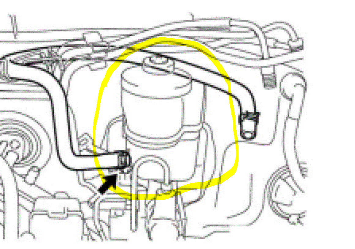

Also, open the hood and have a helper start the engine and depress the brake pedal while you listen to see if there is a vacuum leak at or around the brake booster. The brake booster is located behind the brake master cylinder. I attached a pic and circled the master cylinder to help you locate the booster.
Let me know what you find.
See pic below.
