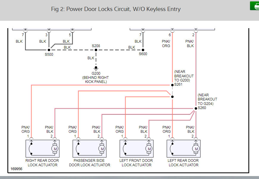

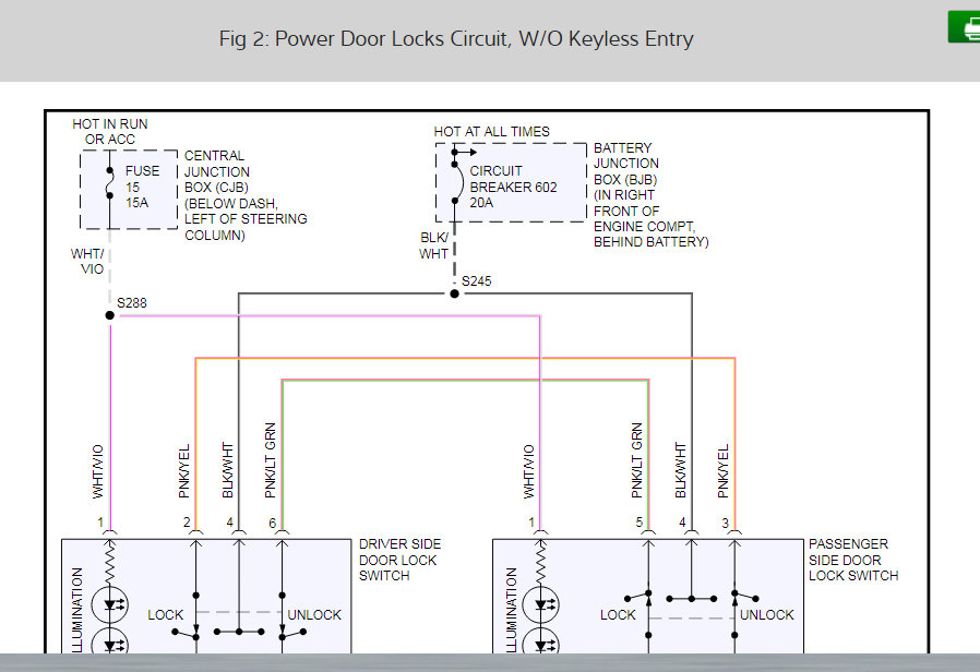

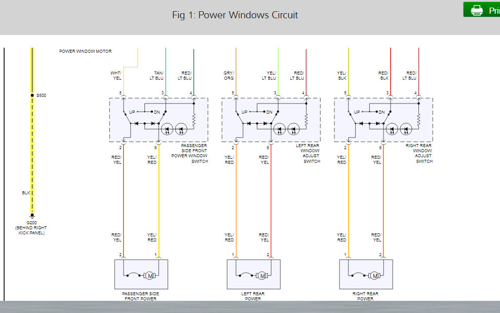

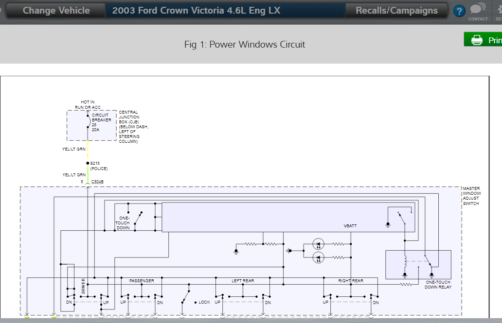

If I may jump in here, Okay from the wiring diagrams that I have included in the diagrams down below, this is the best I can figure it here. Okay 1== Yellow/Black Wire) Master Window Adjust Switch(Pin #4) to Right Rear Window Adjust Switch(Pin #5) 2==Red/Black Wire) Master Window Adjust Switch(Pin #3) to Right Rear Window Adjust Switch(Pin #3) 3==Red/Light Blue Wire) Right Rear Power Window Adjust Switch(Pin #4) to Left Rear Window Adjust Switch(Pin #4) 4==Pink/Orange Wire)
Right Rear Door Lock Actuator(Pin #1) to Driver Door Module(Pin #3) 5==Pink/Black Wire) Right Rear Door Lock Actuator(Pin #2) to Driver Door Module(Pin #8) 6==Black Wire)
Master Window Adjust Switch(Pin #5) to Ground #200 7==Black/tan which is actually Black/White Wire) Circuit Breaker 602(Battery Junction Box) to Passenger Side Door Lock Switch(Pin #4). Please go through these and see if they match up. These are all the major components that I can see. Please get back to us with how everything turns out.
