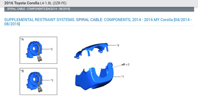

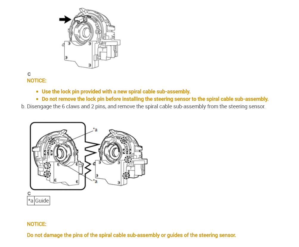

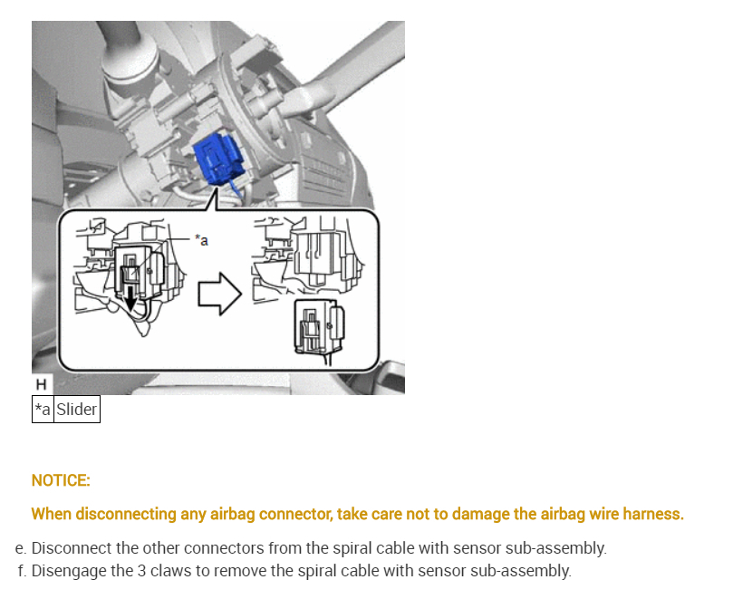

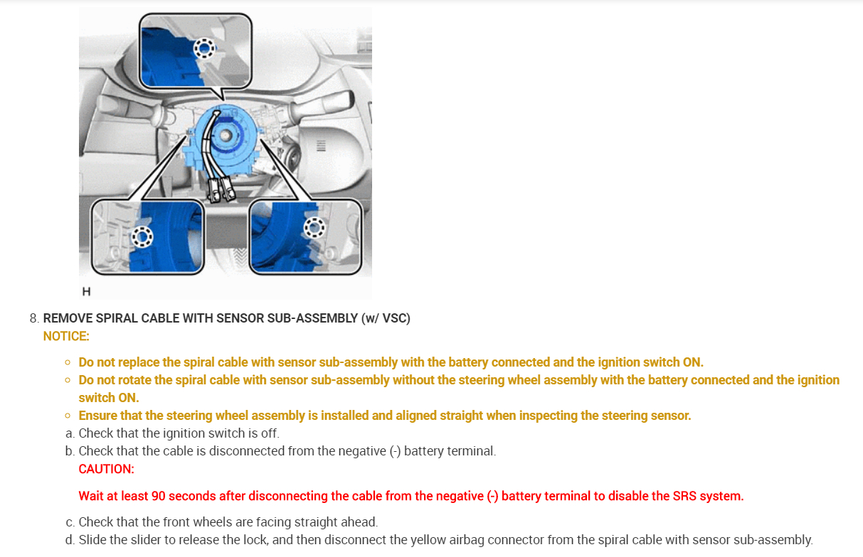

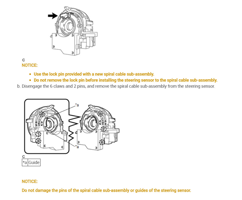

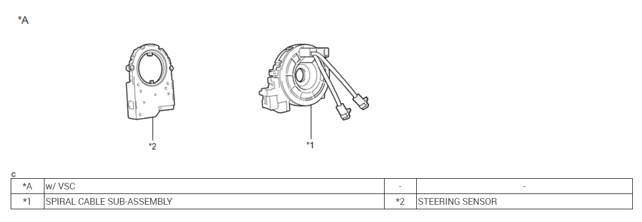

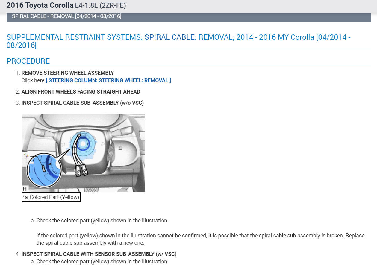

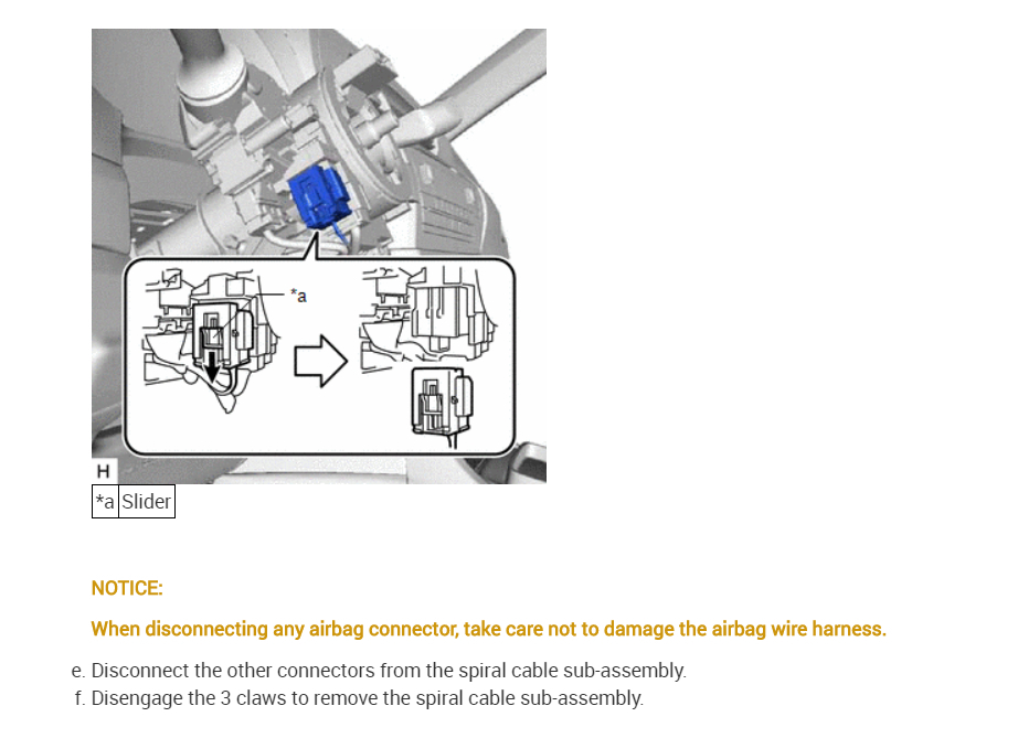

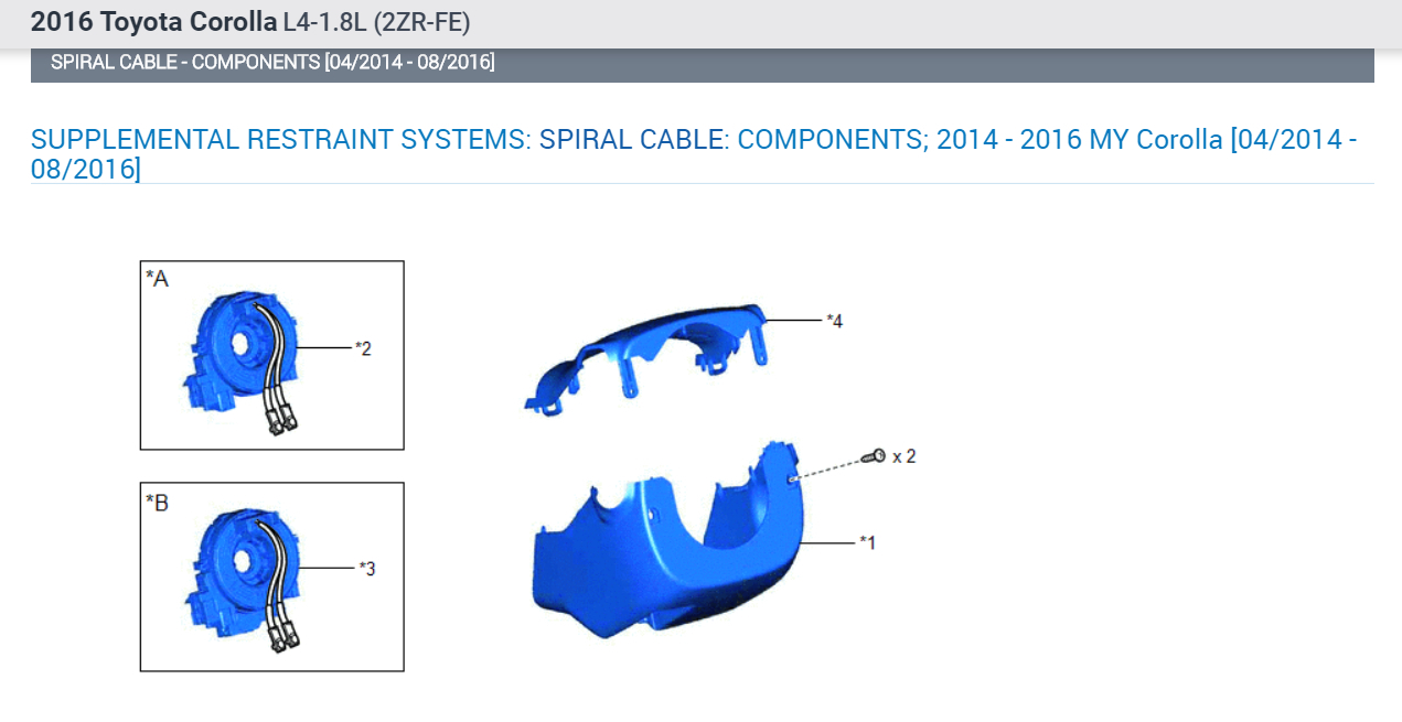

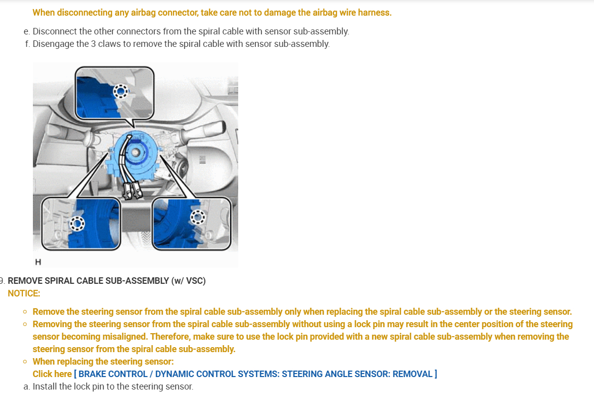

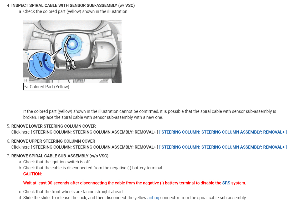

Here are the instructions on how to replace the clock or spiral spring for you to see in the diagrams below. Can you please shoot a quick video with your phone so we can hear the noise? that would be great. You can upload it here with your response. Check out the diagrams (below). Please let us know what you find. We are interested to see what it is.

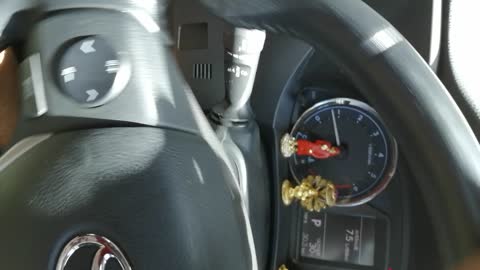

At nearly 1 minute of video.
Nov 21, 2019 at 2:14 AM
MEGHDEEP DHUNNOO
  • 6 POSTS
Another video.
Nov 21, 2019 at 2:37 AM
Thanks for the video. it does not sounds like the clock spring. can you jack the front of the car up off the ground and try the video again please? Here is a video to help you:
