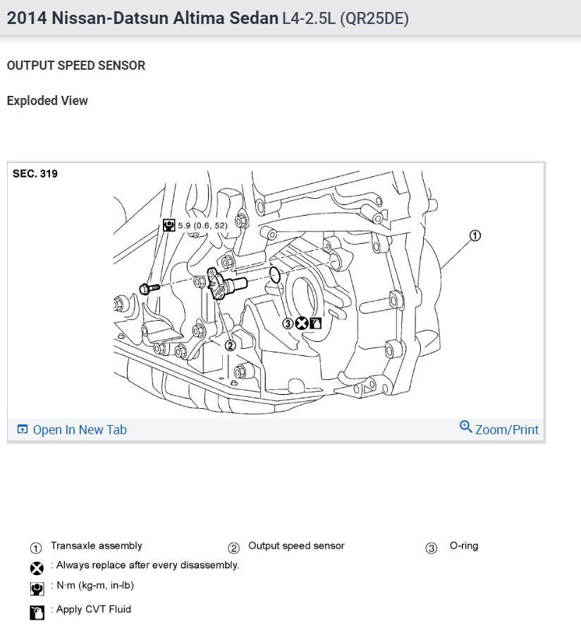

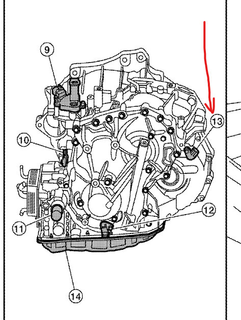

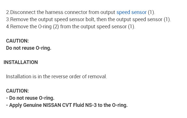

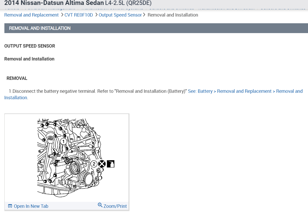

Sure, the output shaft speed sensor is on the transmission case near the CV axle output. Here is more information on the code and I have included the location of the sensor and how to replace it in the images below.
P0500 for a 2014 Nissan Altima refers to a problem with the vehicle speed sensor.
Check out the images (below). Please let us know if you need anything else to get the problem fixed.
