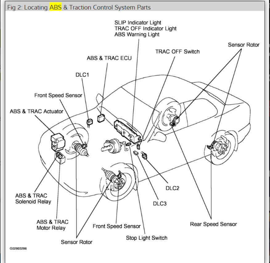

Hello and sorry for the late reply. The sensor is located under the center console. Attached image below. Hope this helps you narrow it down.

Thank you for getting back to me. The image of the yaw rate sensor I see in this image is different from what I think it is supposed to look like. Can you please send me an image of the yaw rate sensor for a Lexus ES 330 2004 model?

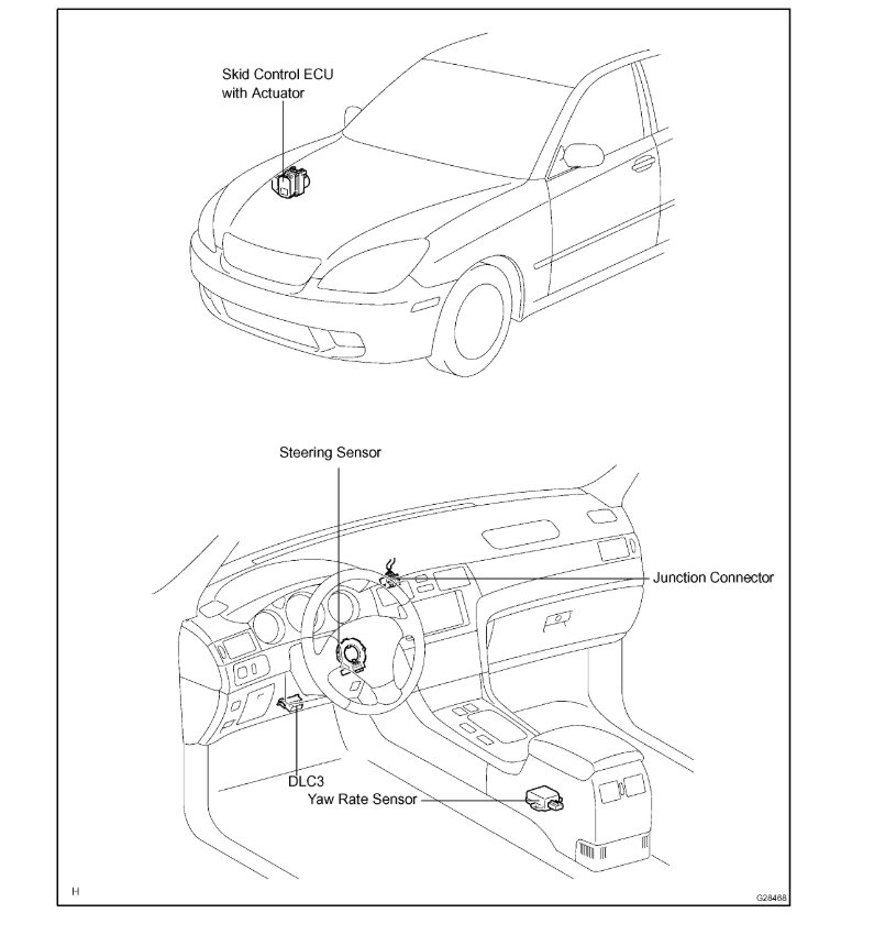

This is a yaw sensor issue which is located under the rear floor center console. Here is a diagrams below to show you where. (DLC2) Check out the diagrams (below). Please let us know if you need anything else to get the problem fixed.

Thank you for getting back to me. I've searched the center console but I can't find the yaw rate sensor. According to that image, it is supposed to be here but I can't locate it. The VIN of the vehicle is JTHBA30G045011785. I'd appreciate any history you can help me pull up about the car and any help I can get about the location of the Yaw rate sensor. Thank you

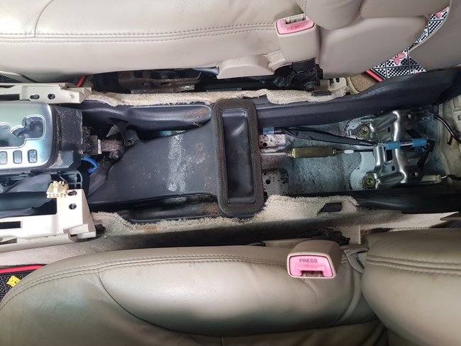

Image.
Jun 30, 2019 at 10:54 AM

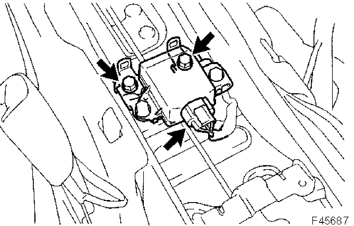

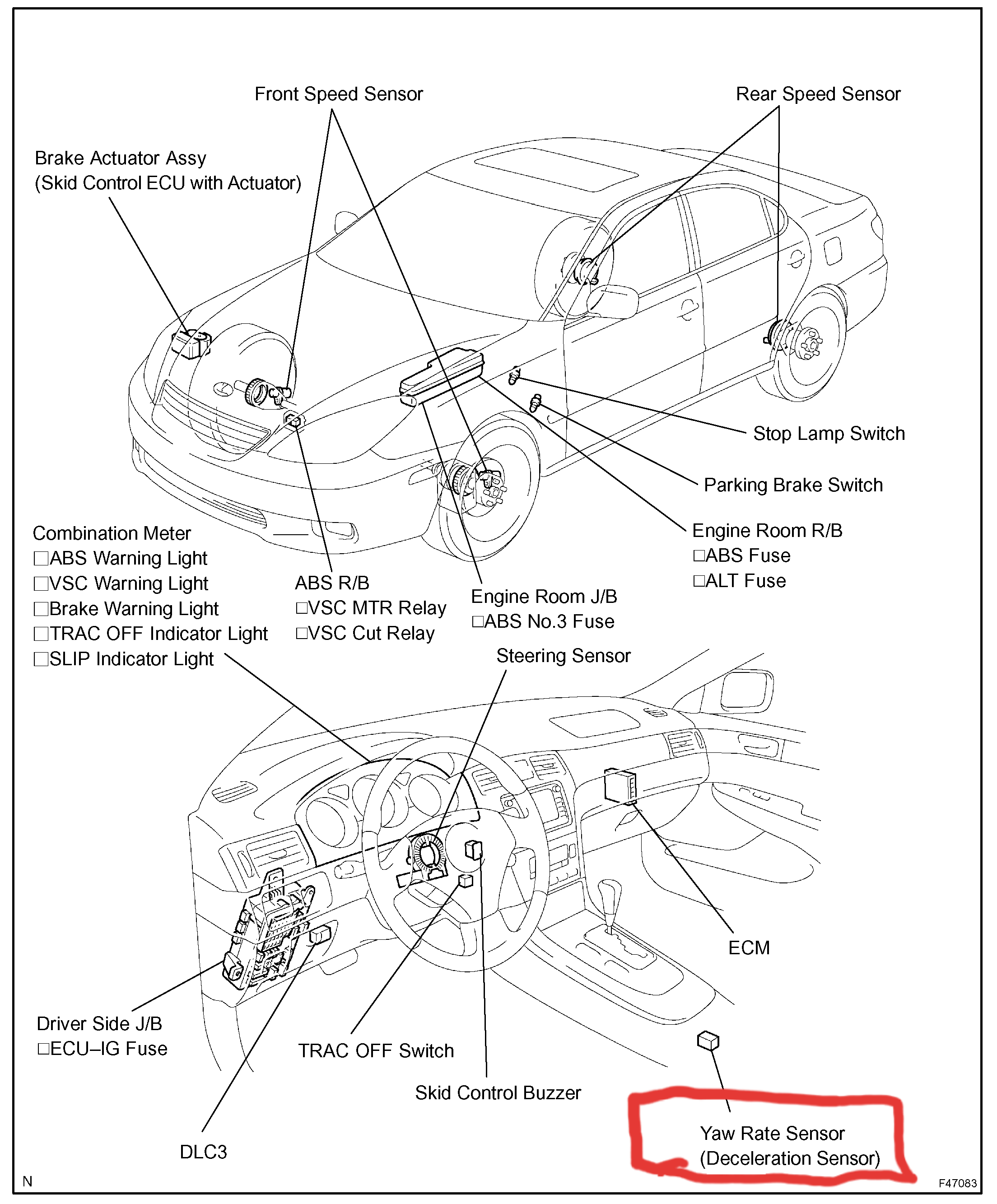

Here is a better image. it looks like it is under the center console. Check out the diagrams (below). Please let us know what you find.
Jun 30, 2019 at 11:23 AM
BADEWOLE EMMANUEL
  • 16 POSTS
Yeah. That is exactly where searched and i could find it.
Jun 30, 2019 at 12:03 PM
Is it under that ducting, did someone remove it, do you see a wiring connector? can you please take more pictures?
Jul 1, 2019 at 10:56 AM
BADEWOLE EMMANUEL
  • 16 POSTS
It is not under that ducting. I don't see the wiring and I don't know if it was removed or moved by someone else. I don't have the history of the car.
Jul 1, 2019 at 5:26 PM
Yep, someone took it out not knowing what it is. you will need to take apart the car further to see what happened to the wiring harness.
