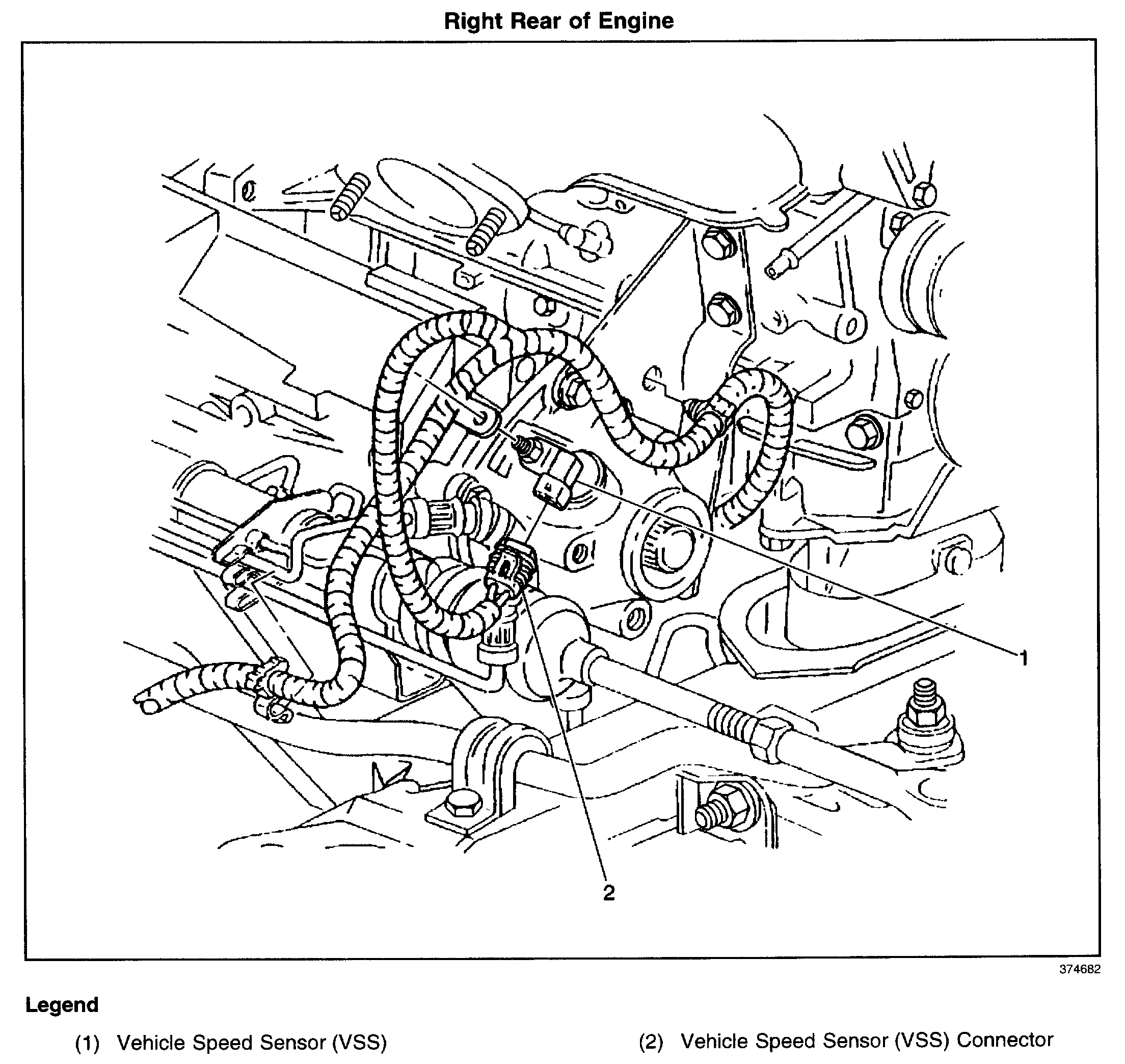

Two speed sensors, one i replaced behind transmission and axle, but second sensor is for speedometer cable VSS. I can't locate that one. I have the part picture I sent you. where is it located and can you show me diagram?

The VSS is located at the rear of the engine/trans-axle. See the attached picture and let me know if that helps. Check out the diagrams (Below). Please let us know if you need anything else to get the problem fixed.

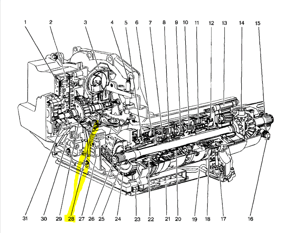

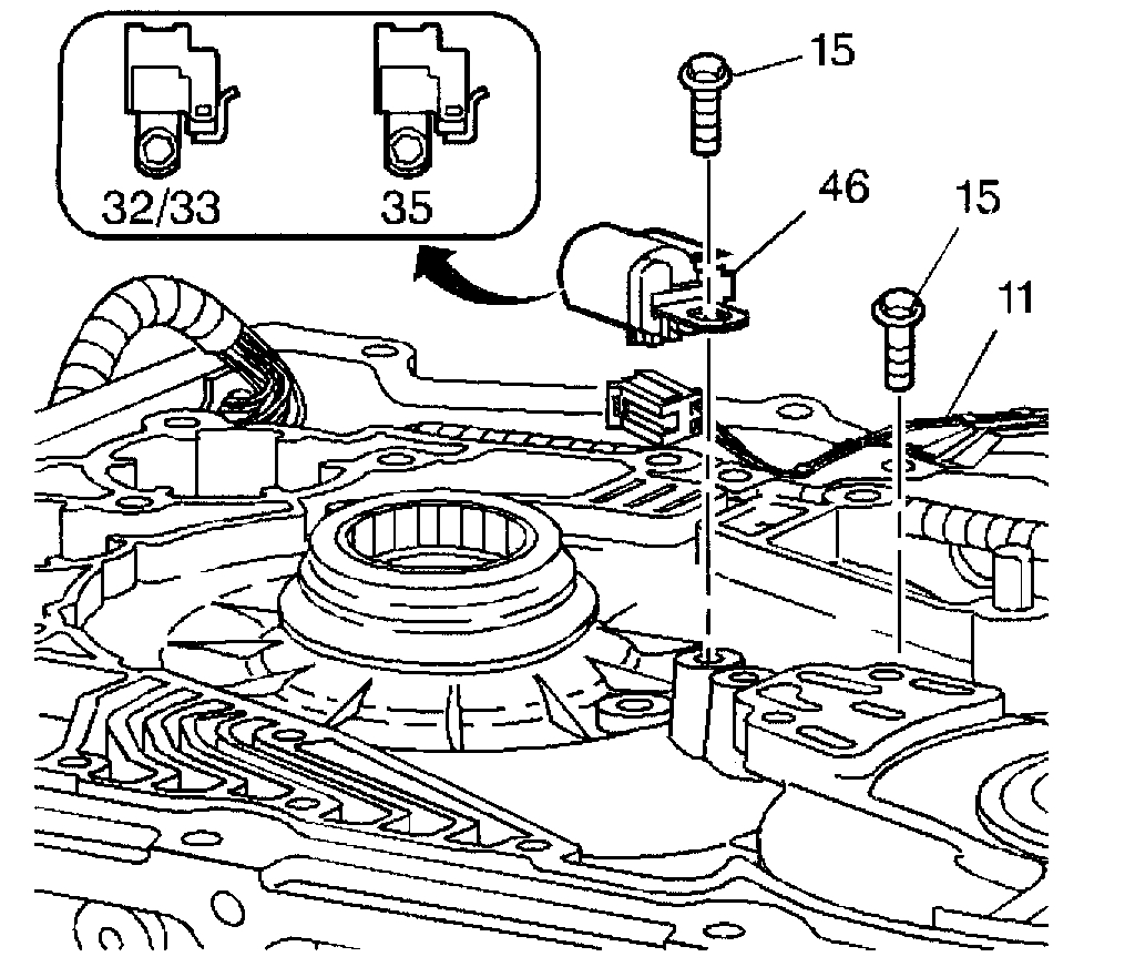

Hi:
The input speed sensor on this vehicle is located internally. You will need to remove the pan. In all honesty, if I recall correctly, the transmission needs to be removed.
If you look at pic 3in, it shows the location of the sensor.
Here are the directions for removal. The attached pic correlates with the directions.

see pic 1

pic 2
1. Assemble the input speed sensor (46) to the transmission case (51).
Notice: Refer to Fastener Notice in Service Precautions.
2. Install the input speed sensor bolt (15). Hand start the bolts.
^ Tighten the input speed sensor bolt to 12 Nm (9 ft. lbs.).
3. Route the input speed sensor wiring harness in the case channel.
4. Connect the input speed sensor connector to the input speed sensor.
5. Install the wire harness retainer and wire harness retainer bolt.
^ Tighten the wire harness retainer bolt to 12 Nm (9 ft. lbs.).
