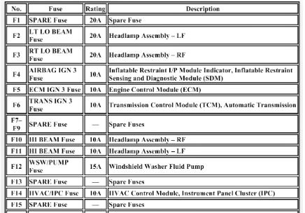

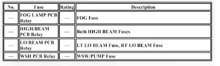

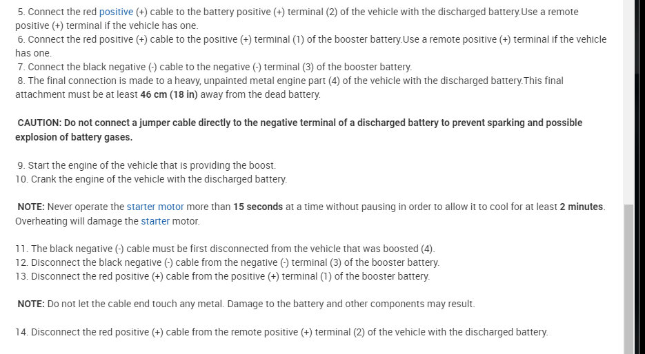

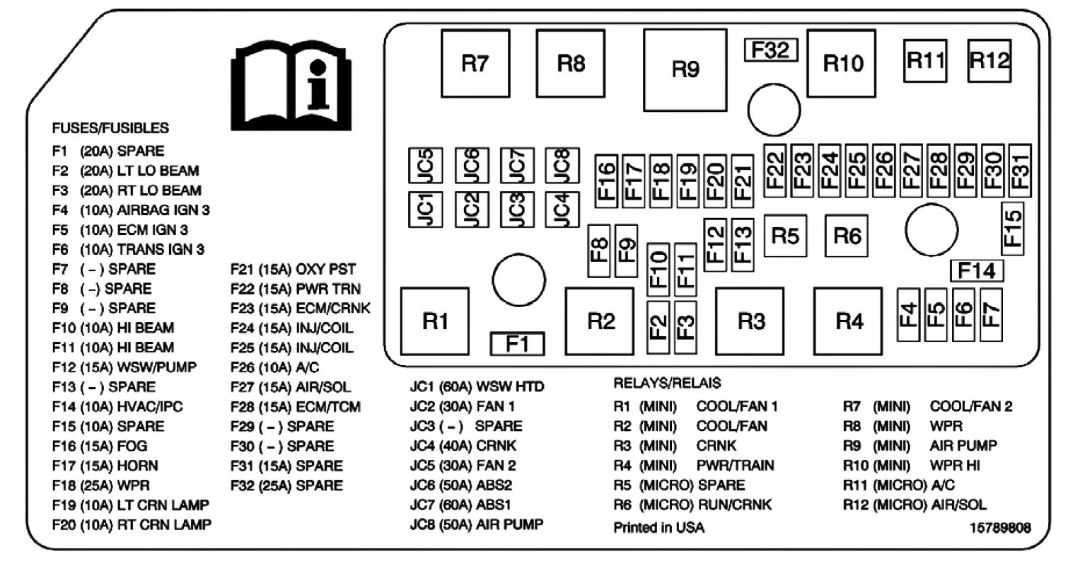

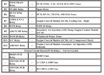

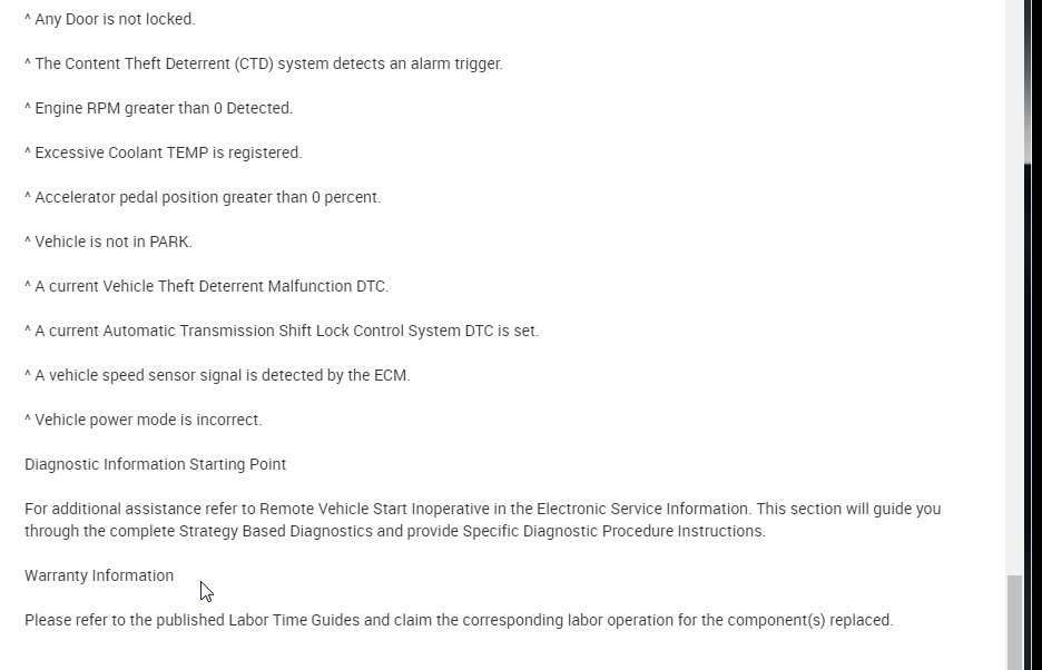

After my car was jump started Directly from the battery, they did not jump start the car from under the hood like they were supposed to.
The speedometer,remote start, fuel distance all of this or digital, stopped working. How can I get them back online and running?
