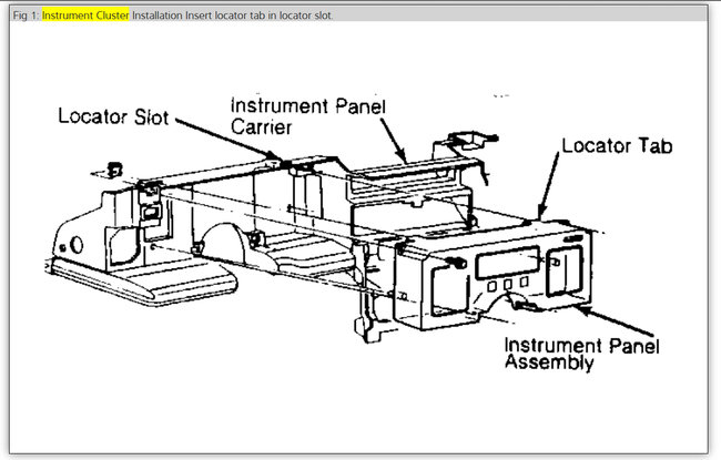

Sometimes my digital speedometer works and then it stops working. I never know how fast I' am going and it is annoying. What can cause this problem and how can I fix it?
Sep 17, 2018 at 2:48 PM

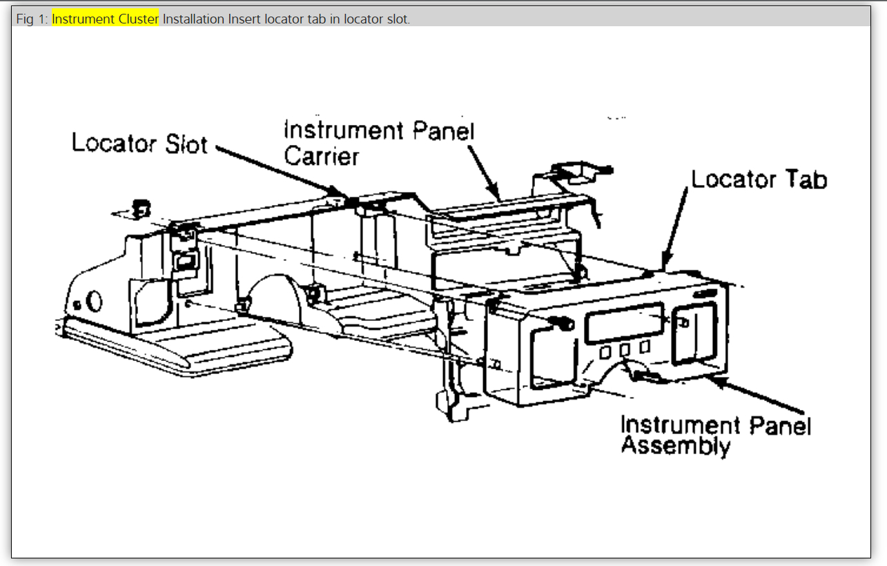

This is the LCD screen which they had a problem with. When this happens you must remove the instrument cluster and send it to be rebuilt. AER does this, here is a video of the job being done on a similar car with diagrams below to show you on your car. Sometimes just unplugging the cluster and plugging it back in again can fix a bad connection.
