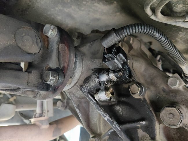

After driving in rainy weather for several days, I noticed the speedometer drop to 0 MPH while traveling at around 60 MPH. It quickly returned to 60 MPH, but from there started operating intermittently. Whenever the speedometer was registering the correct speed, both the odometer and cruise control would function. When the speedometer dropped to 0 MPH, they both stopped working. The speedometer is now permanently at 0 MPH regardless of the velocity of the truck or the weather.

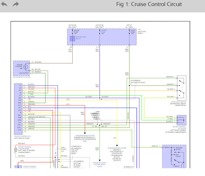

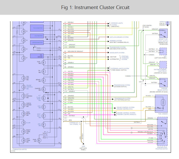

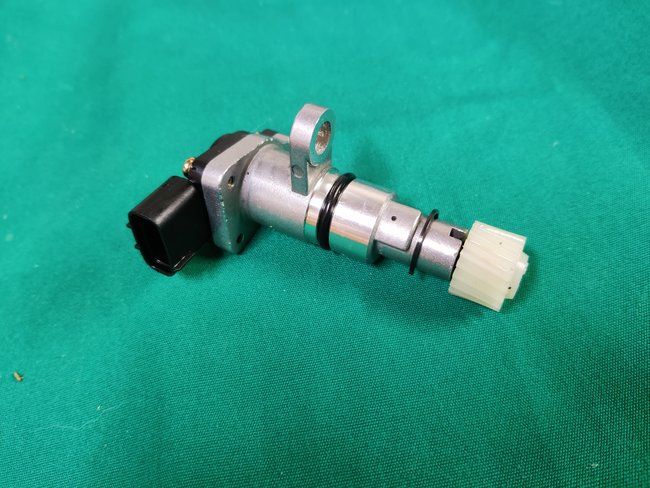

Online forums I've read suggest that if the cruise control also stops, along with the speedometer and odometer, then the likely cause is the speed sensor. Before spending $415.00 for a genuine Toyota part, what is the likelihood that either the wiring harness, speedometer or ECM may be the cause instead? Thanks in advance for your help.
