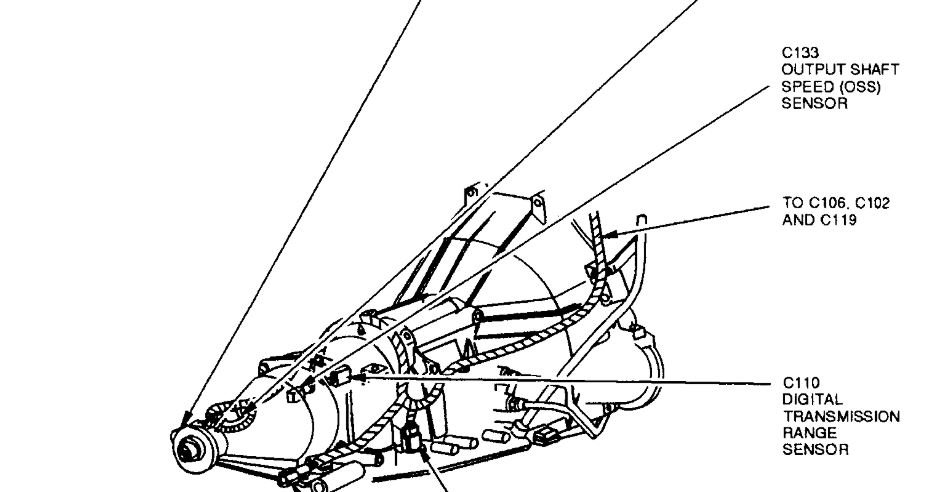

Was it the output shaft speed sensor that you replaced? Also, are you sure all wiring to the rear of the instrument cluster is in good shape, tight, and not corroded including ground? I attached a picture of the sensor responsible for the speedometer just to confirm we got the correct one. Also, I will need to know if this problem existed prior to repair of the odometer.

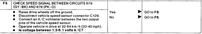

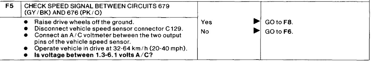

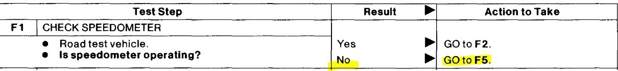

I attached the first two steps of the diagnostic trouble shooting procedure. I will need to know what you find when you get to the end of the second pic below so I know where to lead you next.
Let me know if this helps.
