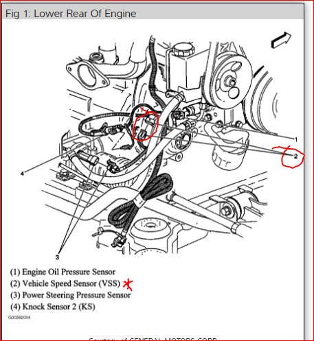

My speedometer is not working. Could it be the VSS sensor? Where is it located? A picture please.
Aug 3, 2018 at 12:32 PM
DANNY L
CERTIFIED EXPERT
5,648 POSTS
Hello, I am Danny.
Yes, that would cause you speedometer to not work.The VSS is located on the lower rear of the engine. I have attached a picture and circled it in red. Hope this helps and feel free to ask any questions if needed. Thanks for using 2CarPros.

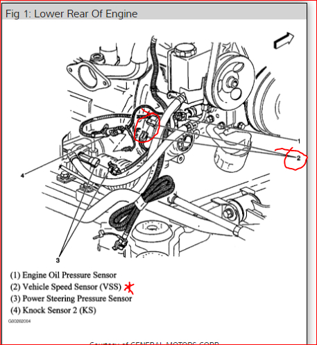

Can I get to it from the top of motor or the bottom?
Mar 22, 2021 at 10:23 AM
DANNY L
CERTIFIED EXPERT
5,648 POSTS
Hello again.
It will be on the lower rear (picture attached).
