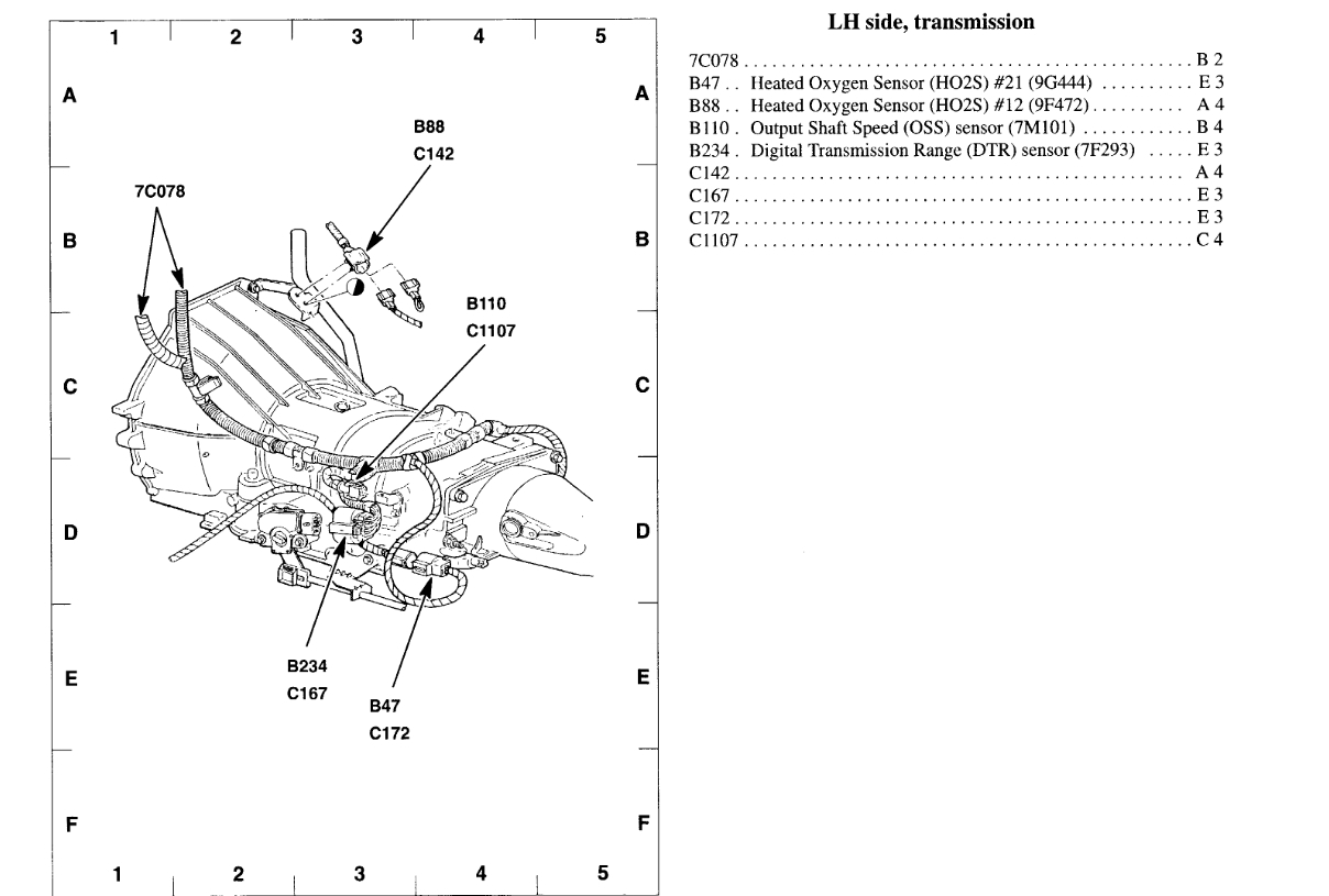

It sounds like the output shaft speed sensor is bad here is the location so you can change it out to see what happens. Check out the diagrams (Below). Please let us know what happens.

Thanks for this post I had this problem and replaced the sensor for $56.00 all fixed!
