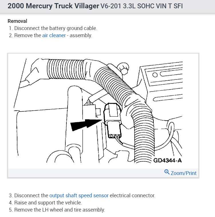

Trying to find out where the wire is inside the engine behind the fire wall.
Aug 8, 2018 at 8:01 PM
Hi Berry,

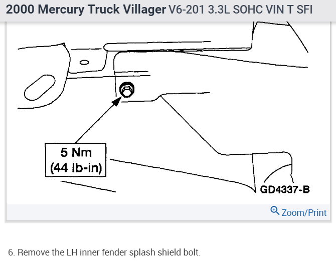

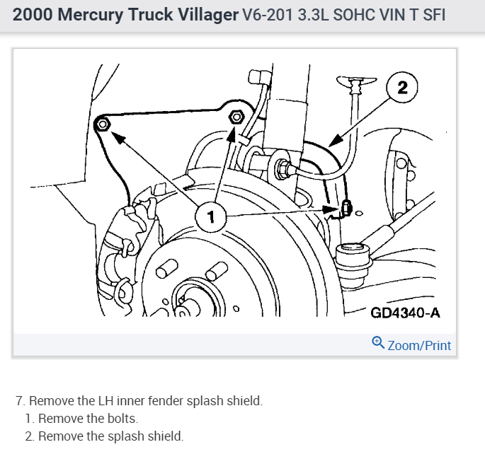

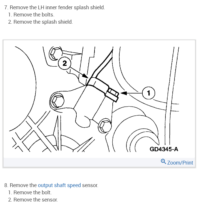

The VSS controls the speedometer, I would start there. Here is the location of the sensor which the wires will be connected to.
