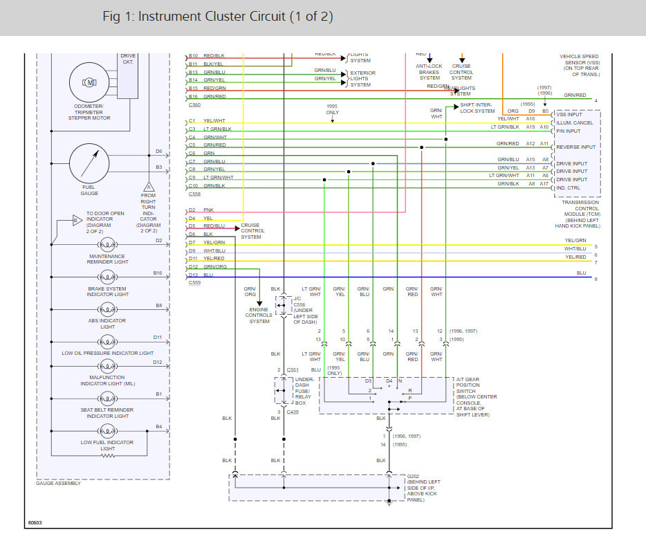

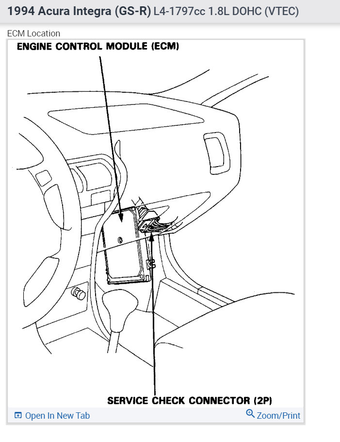

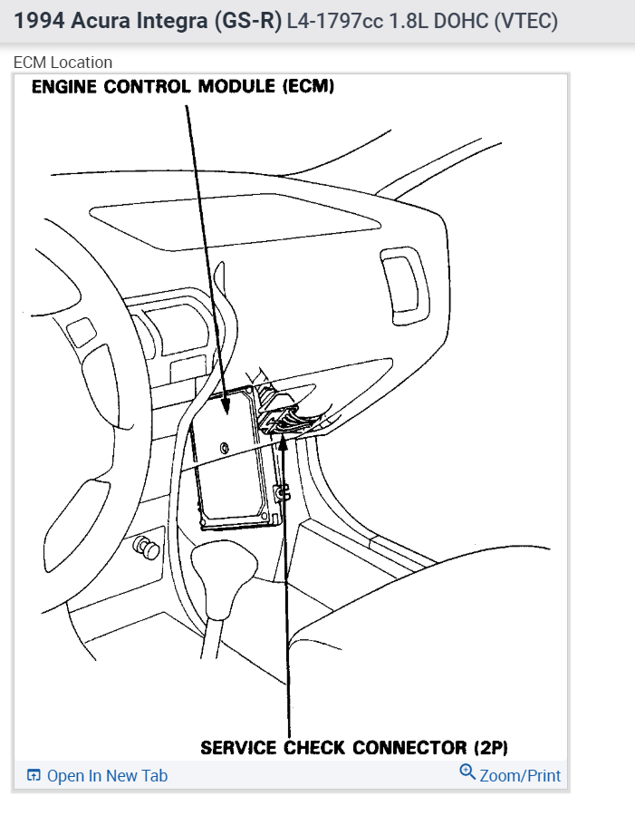

This sounds like the ECU is bad causing the speedometer operation you have described. Here is the location i would try a used unit or rebuilt. Check out the diagrams (below). Please let us know what happens.

I was thinking that too, I'll see if I can find my p72-a01.

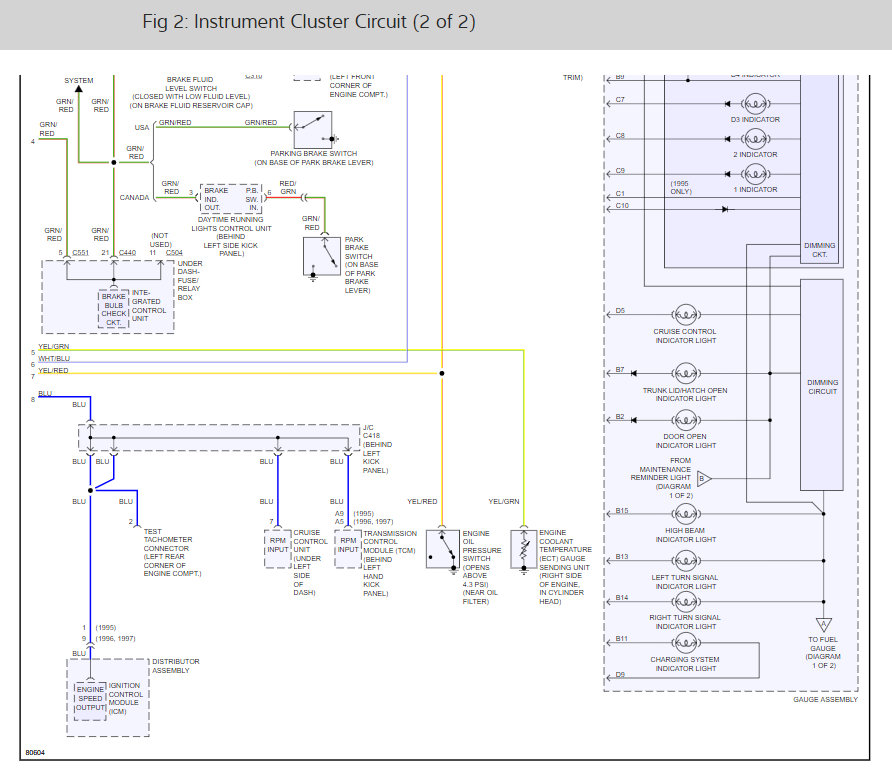

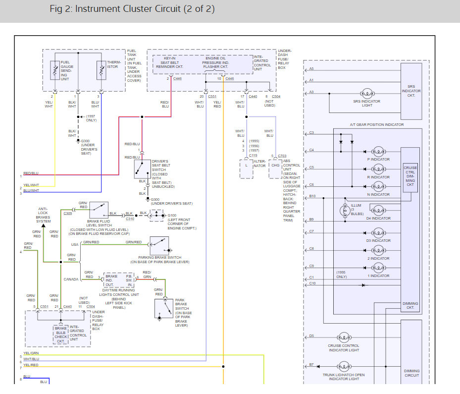

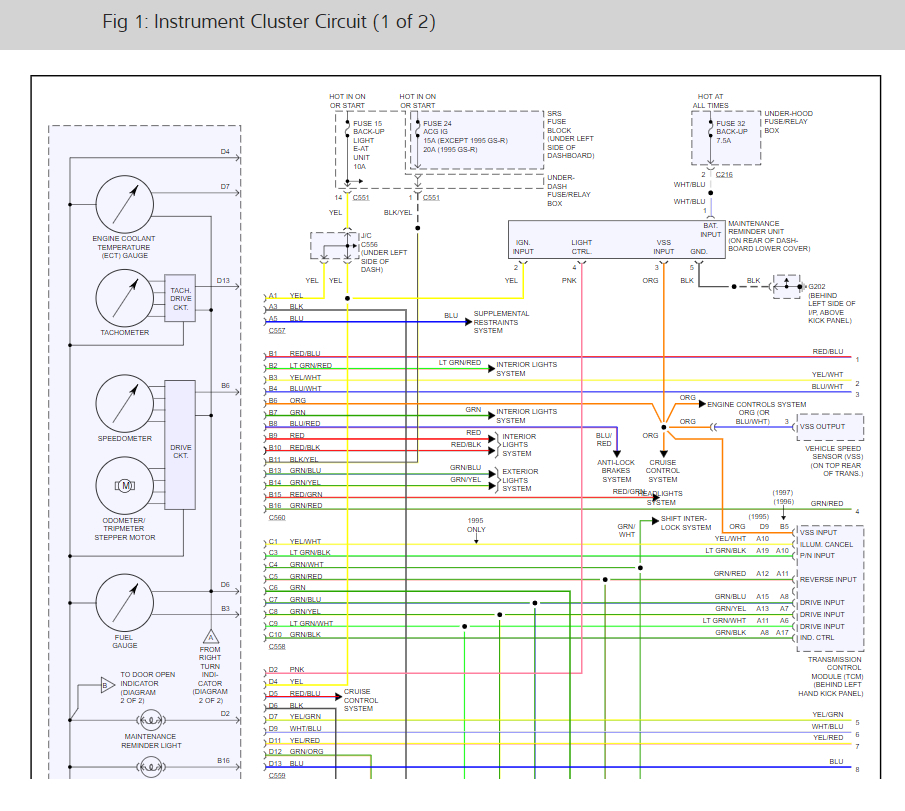

It could be an ignition feedback issue. do you have good quality (new) ignition parts? Here is a guide to help us check the wiring and the cluster wiring diagrams below:

Thanks for the diagrams and sorry I didn't write yesterday, but I have already found the problem and have corrected the situation Friday afternoon. It was in the harness itself. the plug had actually shorted even though I was getting continuity; it was shorting when energized.
