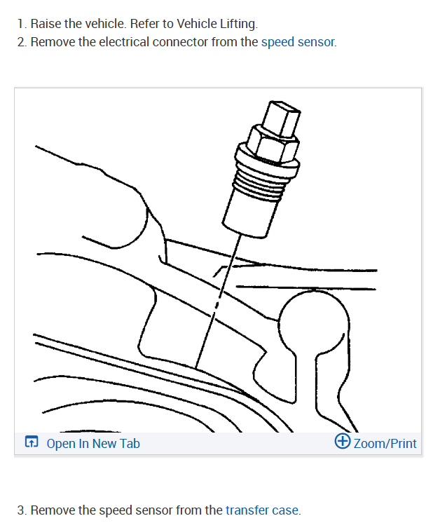

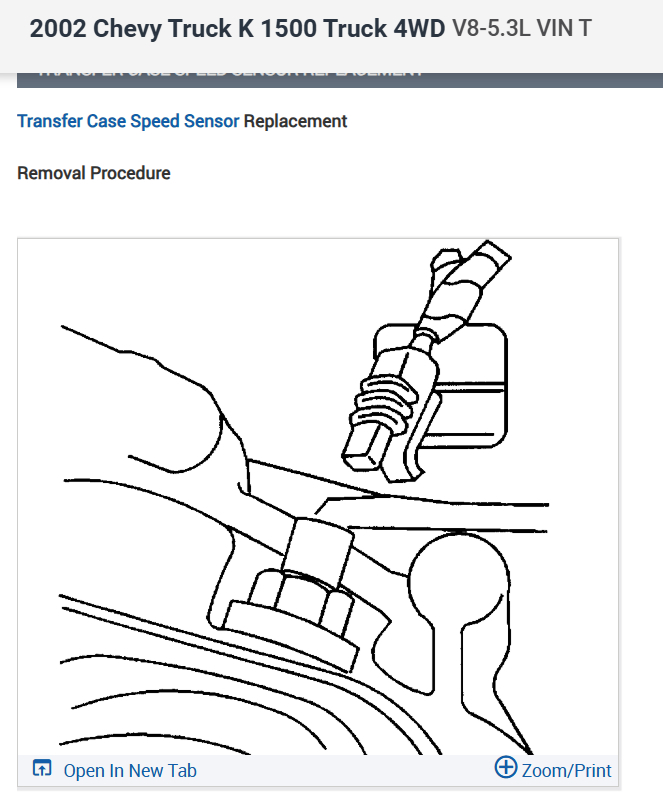

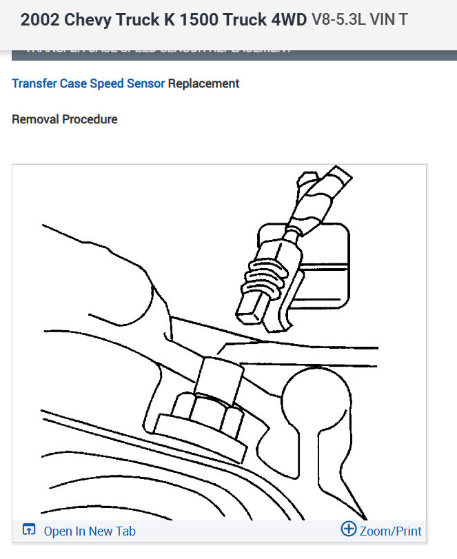

I would replace the VSS which should fix it. here is the location of the sensor which is on the transferase so you can change it out. Check out the images (below). Let us know how it goes.

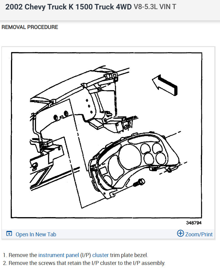

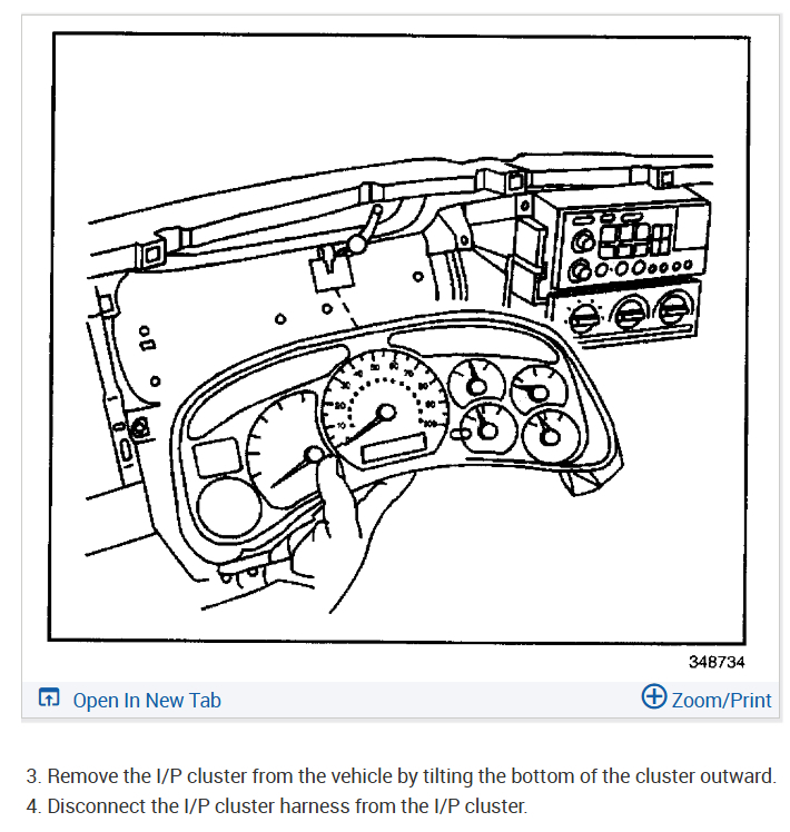

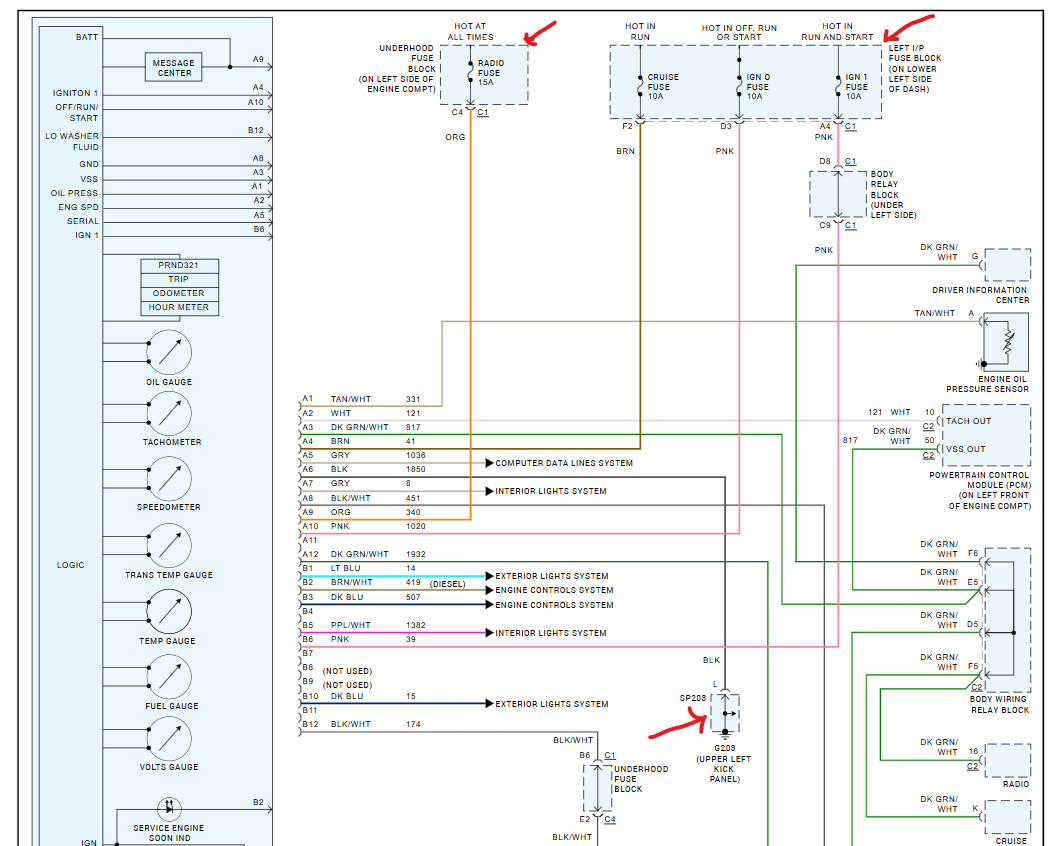

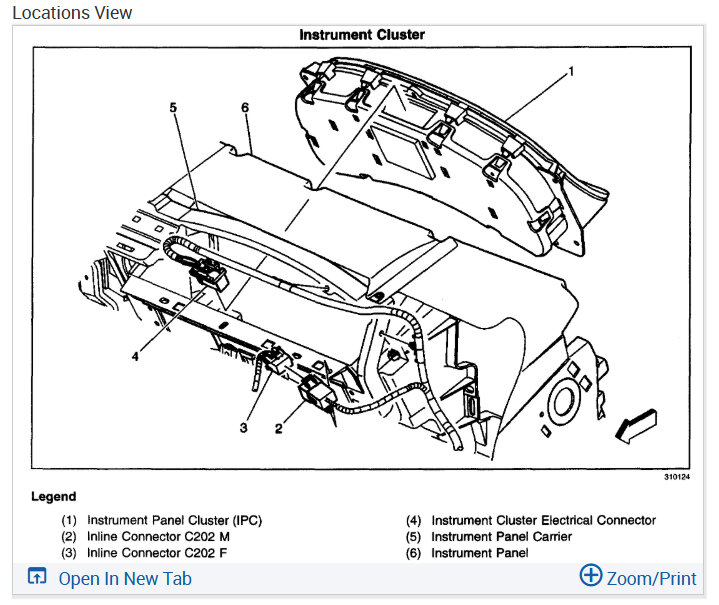

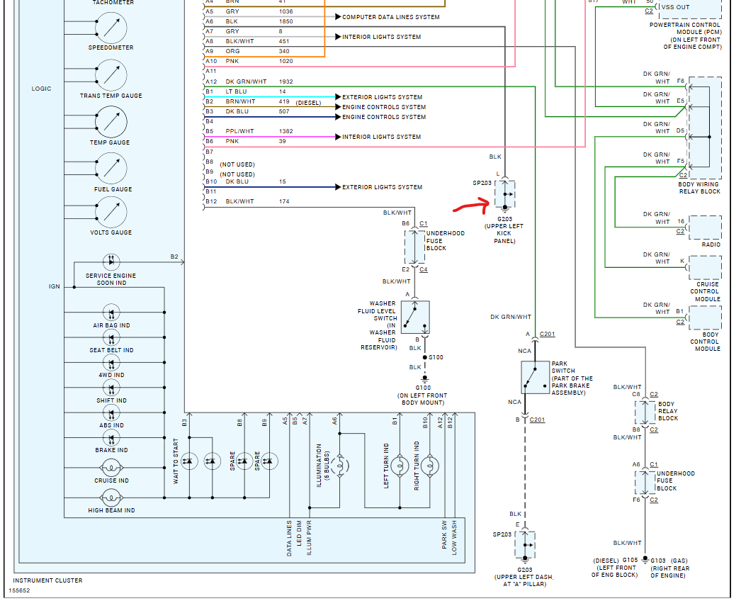

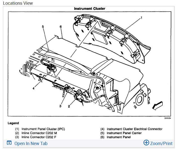

If all of the gauges are having issues it can be the cluster itself, but we should check the ground and power inputs before getting a rebuilt/used cluster. The ground you need to check the is the G203 which is located at the upper left kick panel. I have also marked the fuses you need to check in the cluster wiring diagrams below, I have also included how to remove the cluster so you can get the wiring connector. Check out the images (below). Please let us know what happens.
