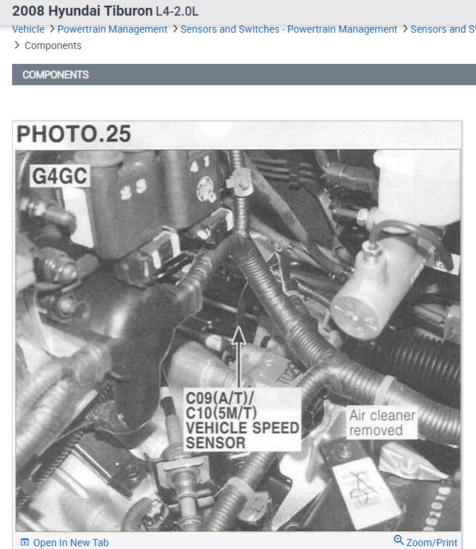

Excessive speedometer error can be due to incorrect size wheels/tires or a faulty vehicle speed sensor. An out of calibration sensor can send incorrect signal to the ECM and that will display incorrect speed on the gauge.
I have attached a picture showing the speed sensor location below.
