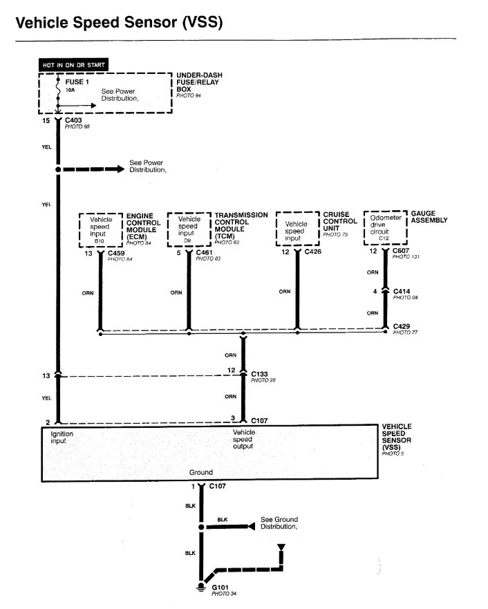

I replaced my VSS, and my speedometer still does not work. Every other gauge works properly.
Is the speedometer gauge itself bad? Or is there a speedometer cable also that I need to replace?
Sep 24, 2019 at 2:46 PM

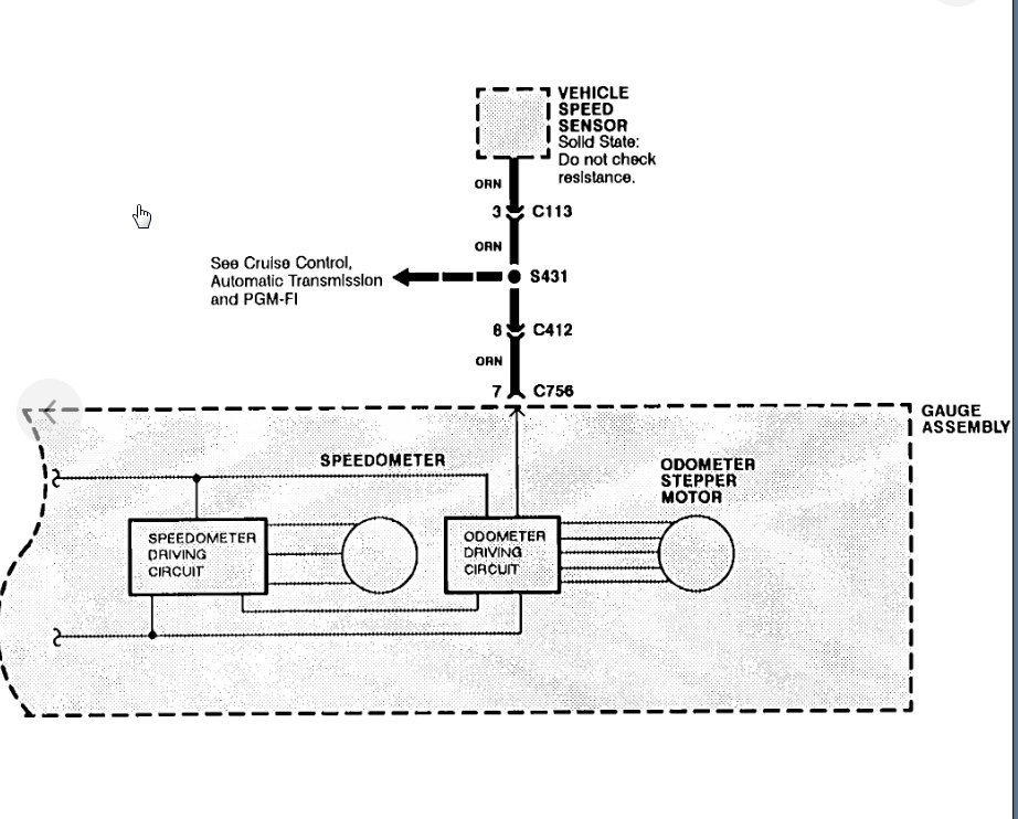

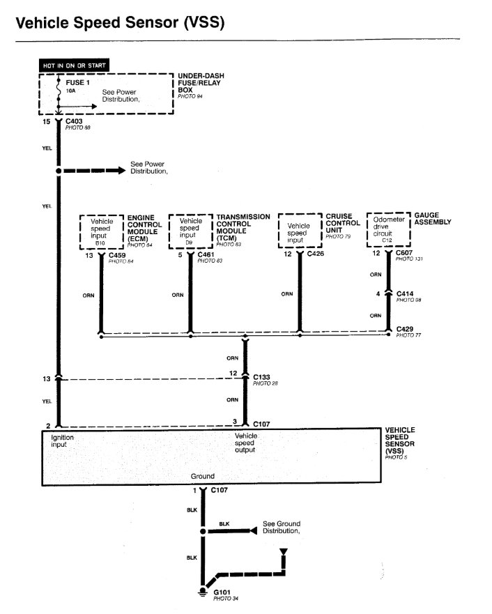

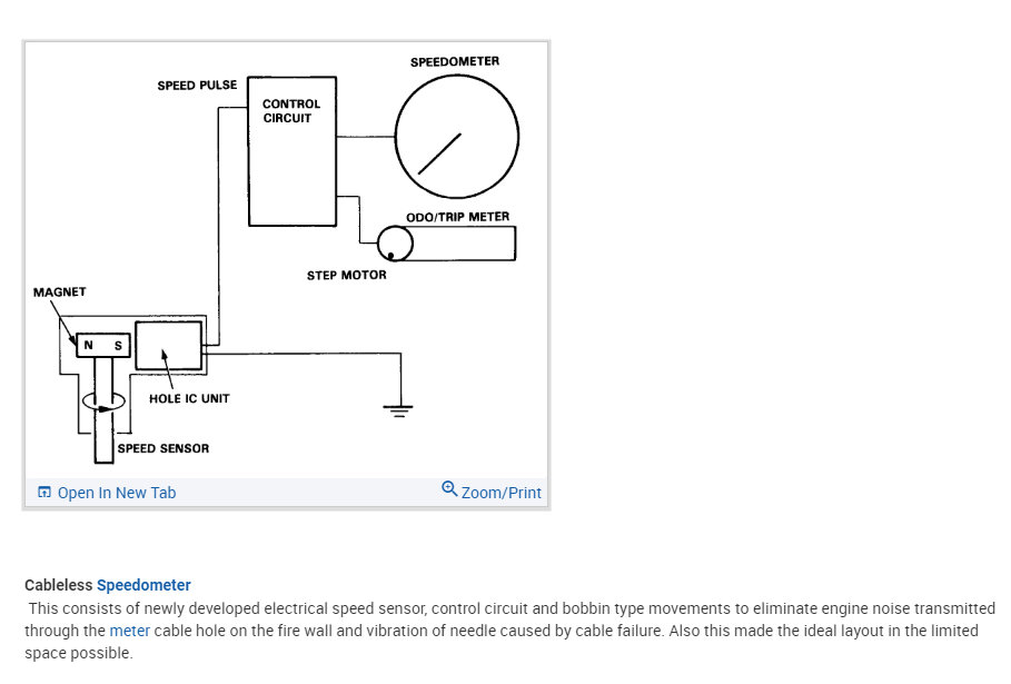

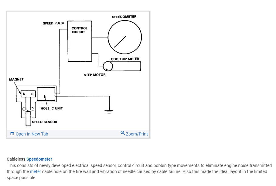

You have a system called a cableless speedometer. I attached some more info that will explain this in more detail. However, basically you have a VSS that sends an electrical signal to the gauge assembly that translate that into the display for the gauge.
If you replaced the sensor then the gauge assembly is the only thing left unless you have a wiring issue which is possible. As you will see on the wiring diagram there are inline connectors that could be causing an issue. However, the easy way to tell if the wiring is ok is if your odometer is working with no issue because it gets the signal from the same wire.
If this is the case, then you need to replace the assembly.
