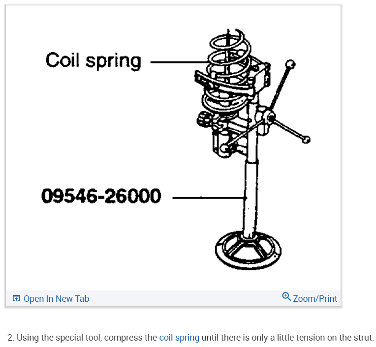

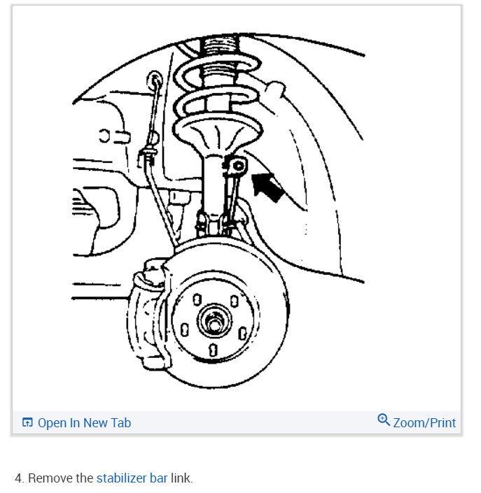

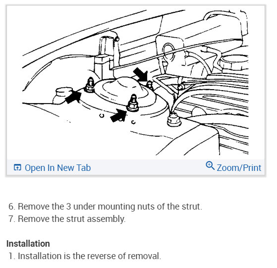

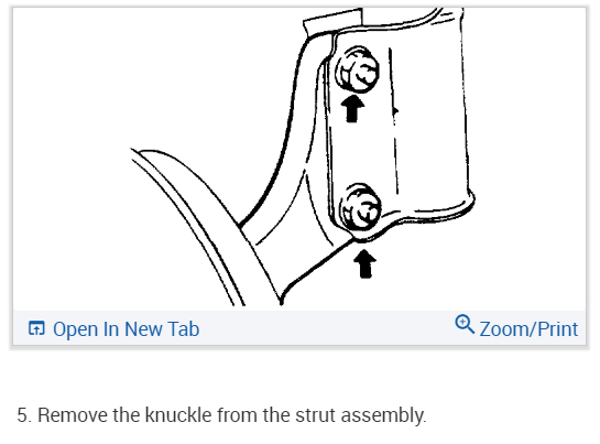

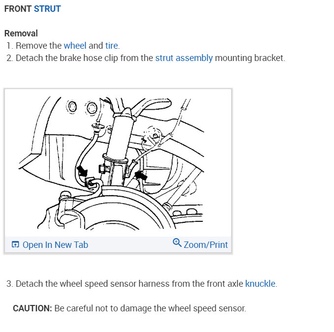

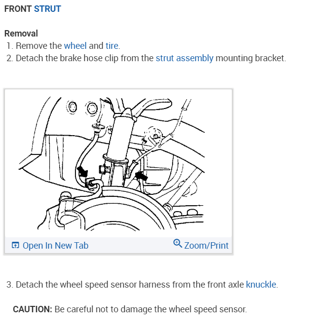

Also, do you by chance have a guide to replace front struts on it? Or what size sockets we will need? I am fairly confident that i know how this is done but knowing what tools i will need would be greatly appreciated.
