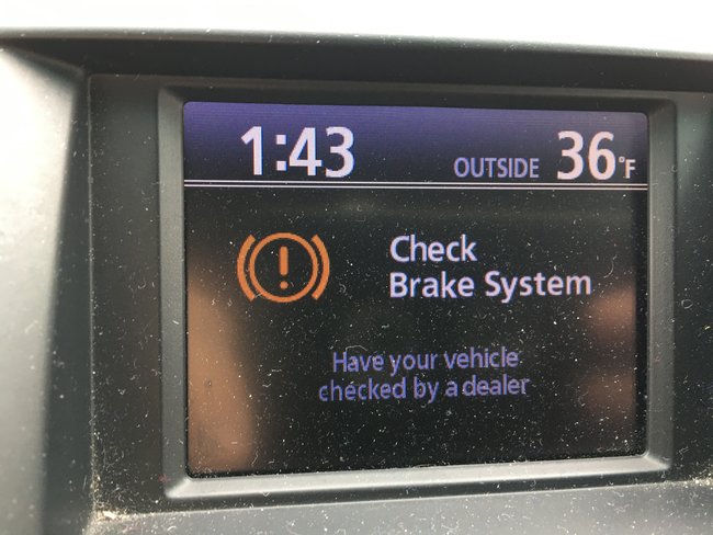

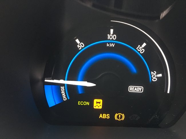

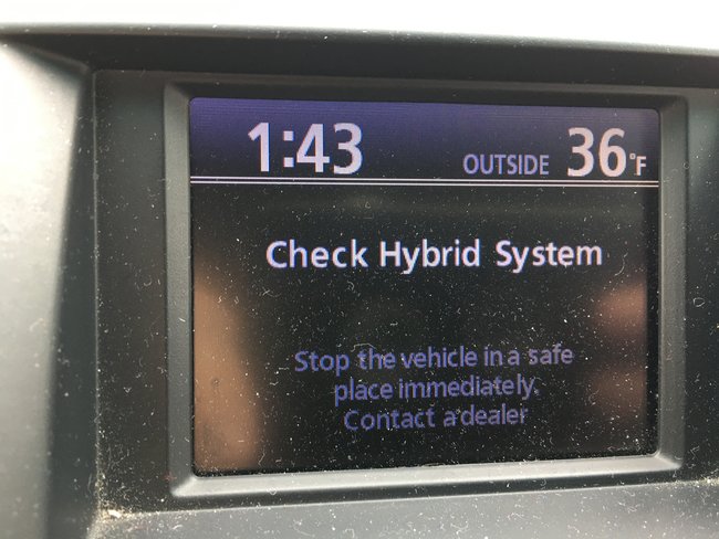

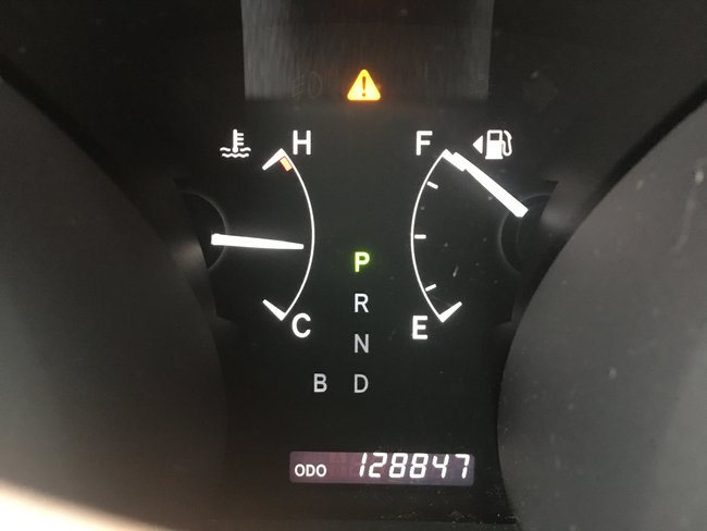

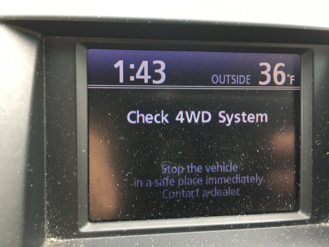

Next time the lights are on, can you get a picture of the cluster so that we can see what messages and lights are on? Thanks
Jan 23, 2021 at 5:43 PM
KIRT K. PARKER
  • 10 POSTS
These are pictures of the warning lights and control panel messages, before they are cleared with a code reader, even though the Toyota dealers code reader says that there are no error codes, with the below messages still on the panels.
Jan 23, 2021 at 7:06 PM
Okay. The only thing that makes sense with this is if the 12 volt battery is weak causing these lights to come on. Each of these warning lights is associated with codes so if there are truly no codes then a weak battery would make sense.

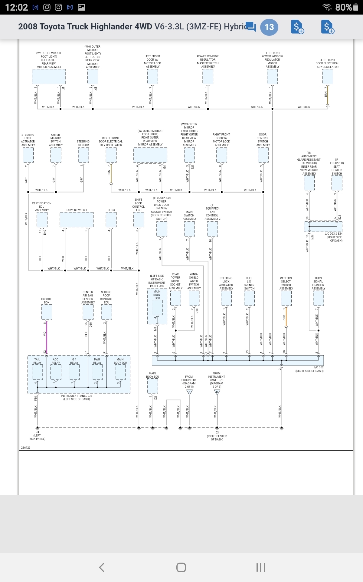

Toyota of Knoxville, said they looked at everything and could not find anything (with lights and messages on dash). I have contacted every hybrid repair shop within 250 miles for any suggestions. Most think that it is an electrical issue after I checked everything (battery, battery cables, plugs, fuses). Best suggestion from a few is that there is a loose ground wire, but they also added "Good Luck Finding It", because there are so many ground wires and I can not find one diagram to even show where to begin looking for them.
Jan 25, 2021 at 7:39 PM

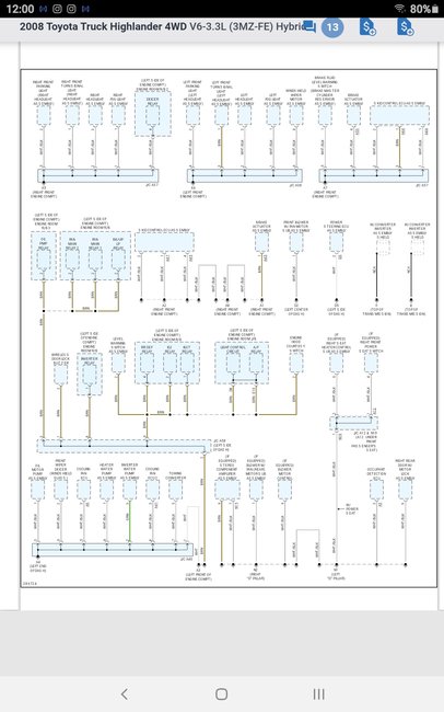

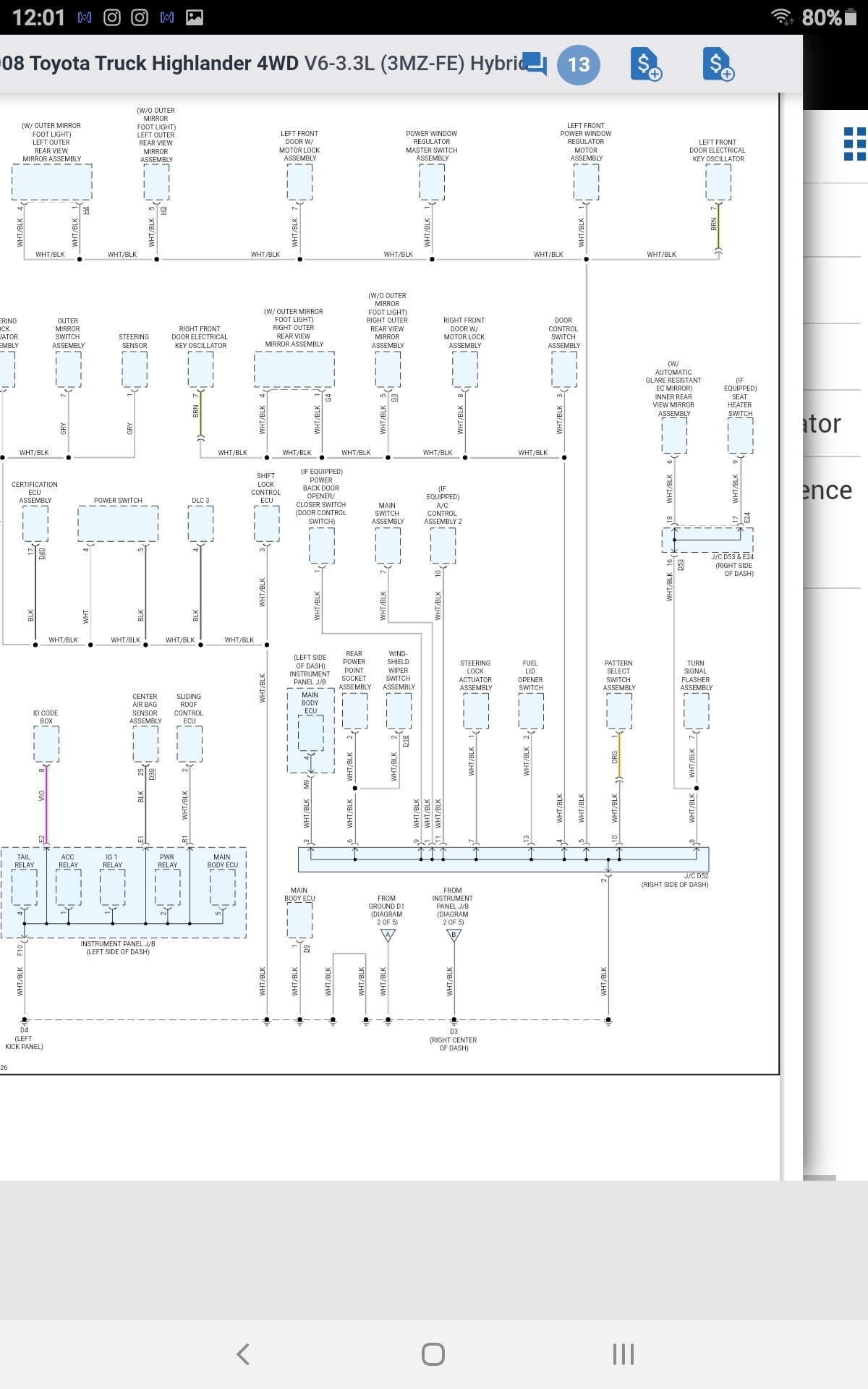

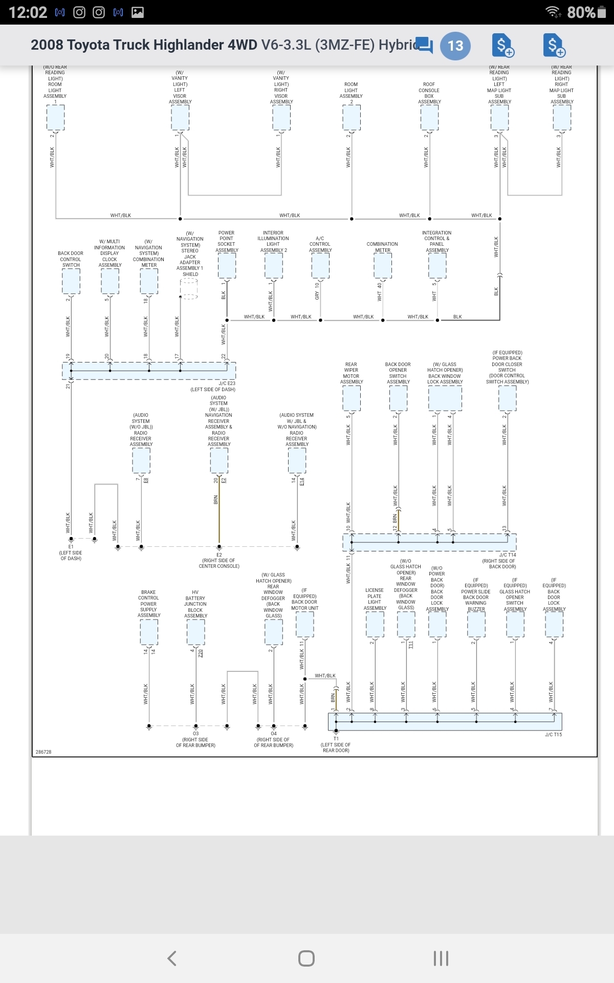

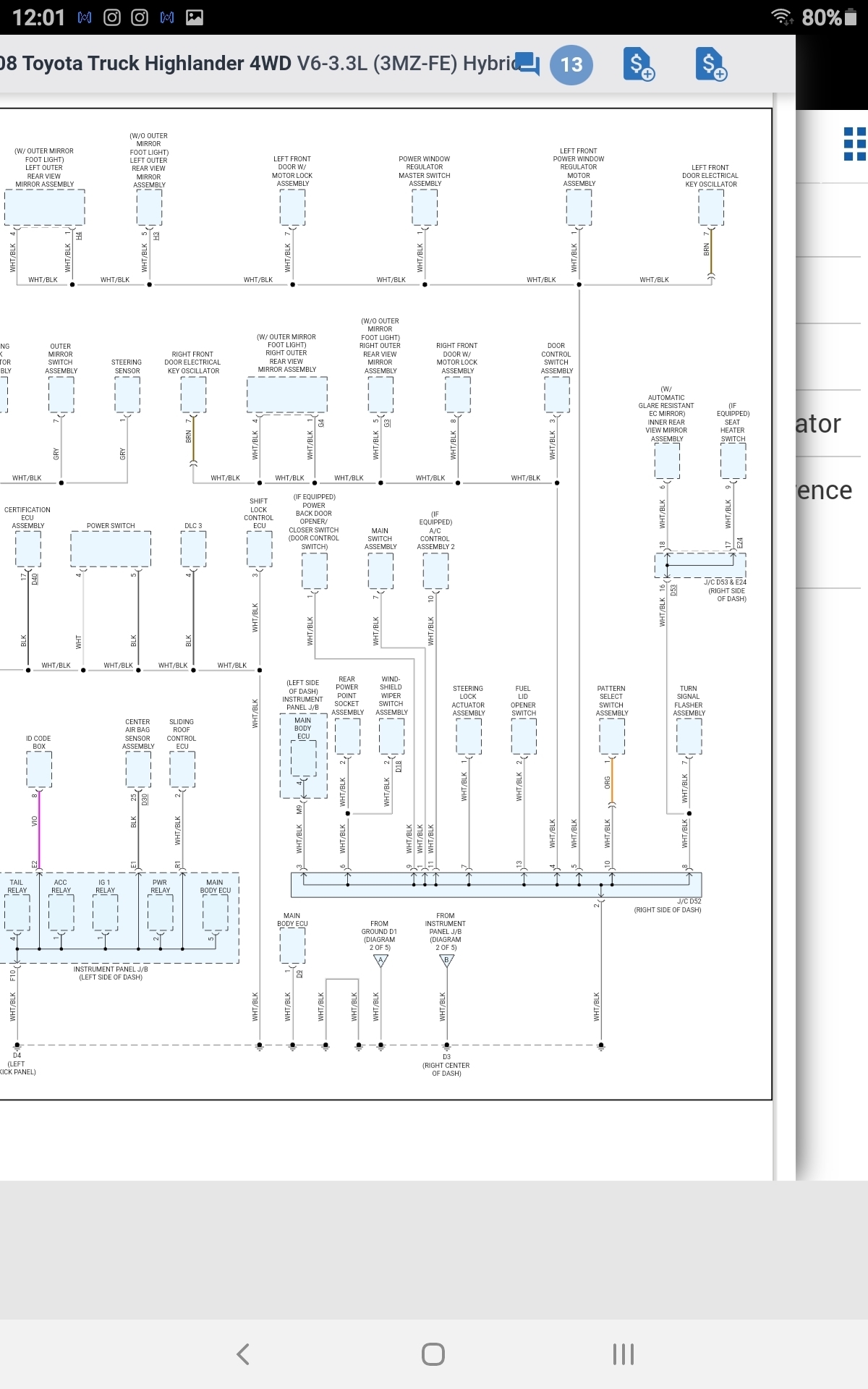

4DRTOM
  • 467 POSTS

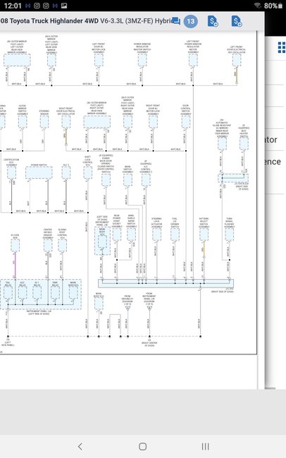

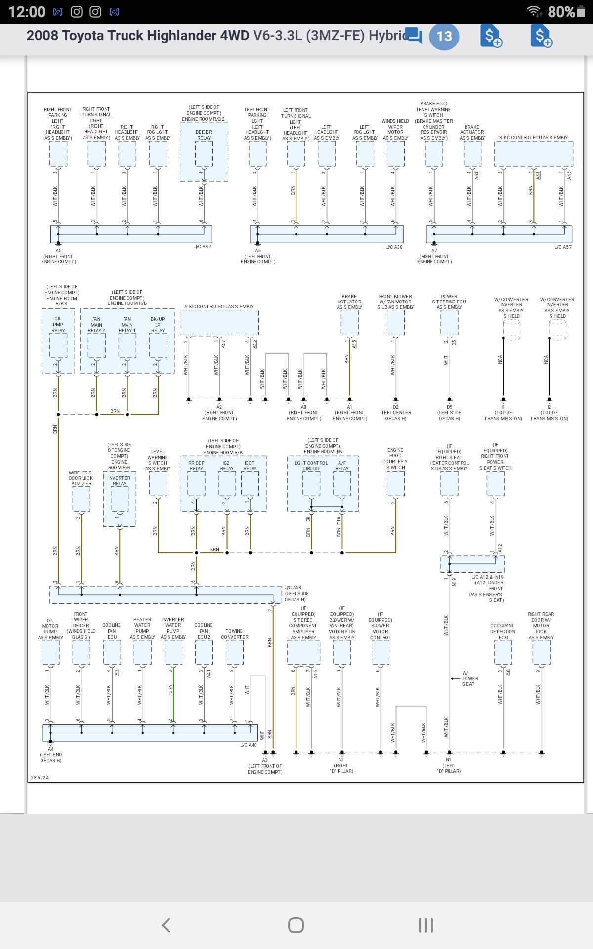

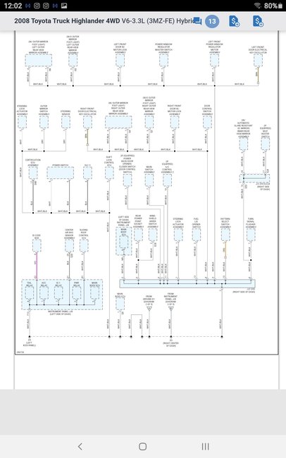

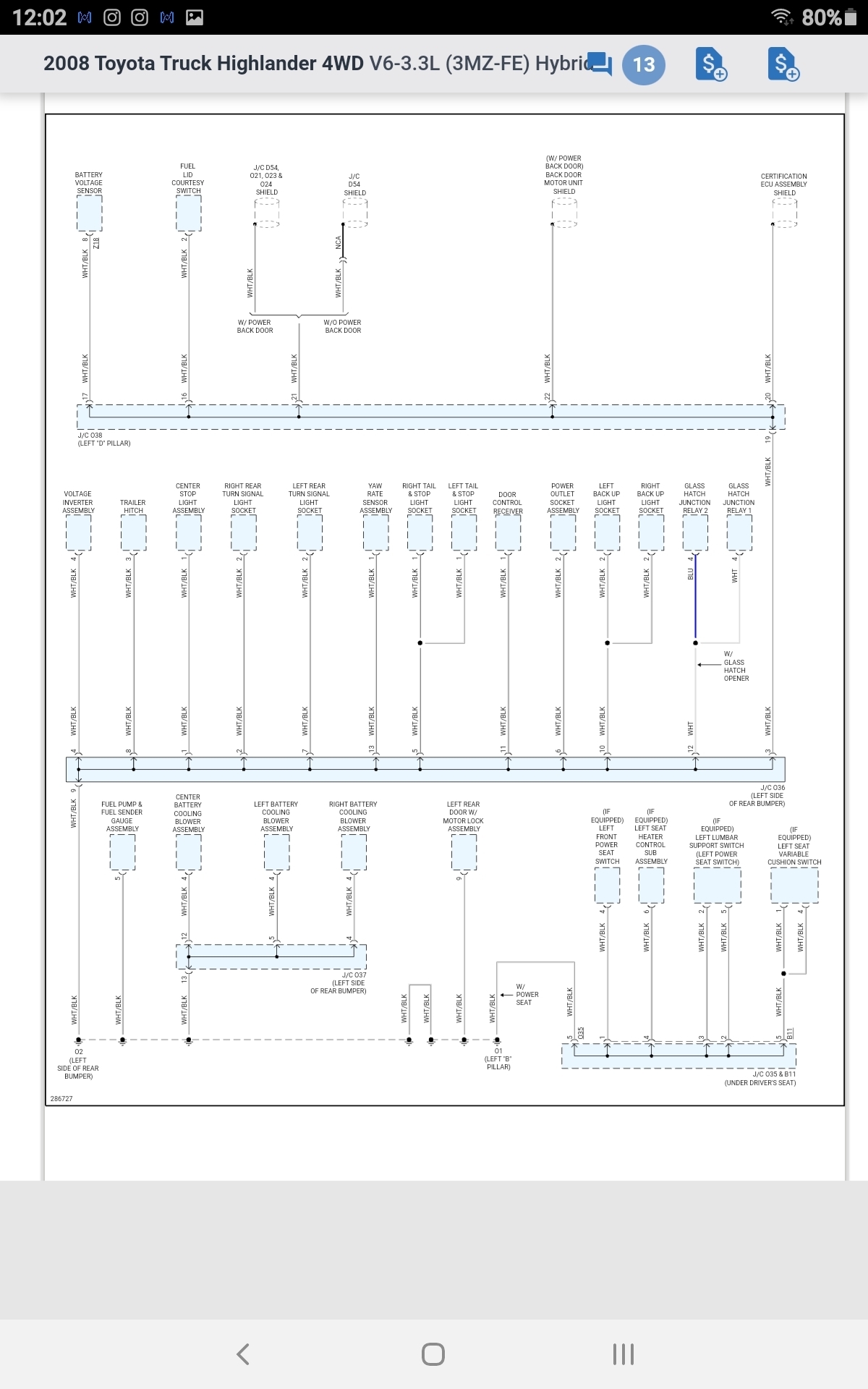

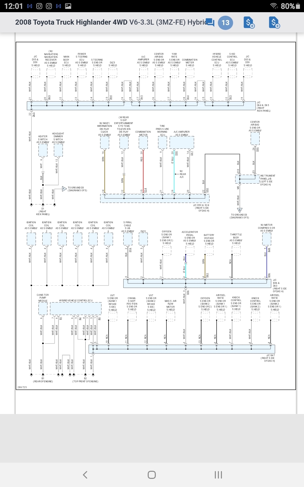

I'm Tom and went through this a little. I've attached all the diagrams for your grounds. Maybe you will find a bad one, a wet area or something just not right when you look. Can you recall the very first time this happened? Was there anything out of the ordinary, spilled coffee, driving down a bumpy road, Snow storm, lent the car to someone, a jump start? Anything at all. Think back to that very first day and the few days before and let me know if you can recall anything.
Tom
Jan 26, 2021 at 12:09 AM

Thanks for the diagrams...This will really help me locating all the ground wires. As far as what happened when this problem first showed up, I was sitting at a red light for about 60 seconds on a beautiful sunny day and it was about 36 degrees F, absolutely nothing was going on inside or outside the vehicle. I had just drove from home about 15 miles before I got to the red light. :(
Jan 26, 2021 at 8:20 AM

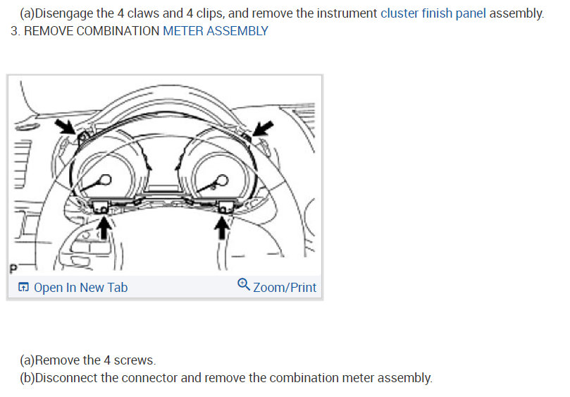

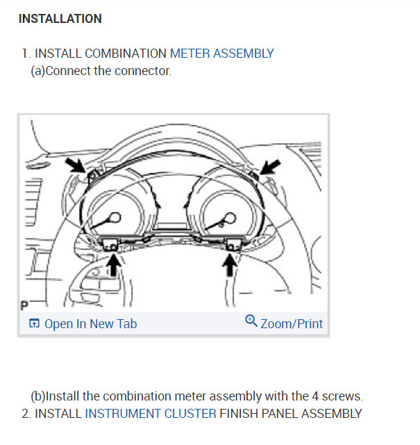

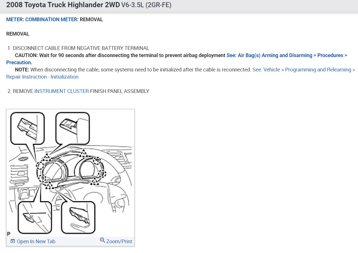

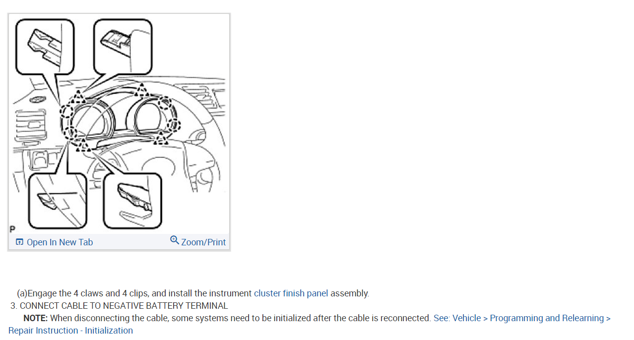

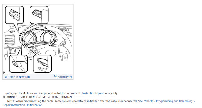

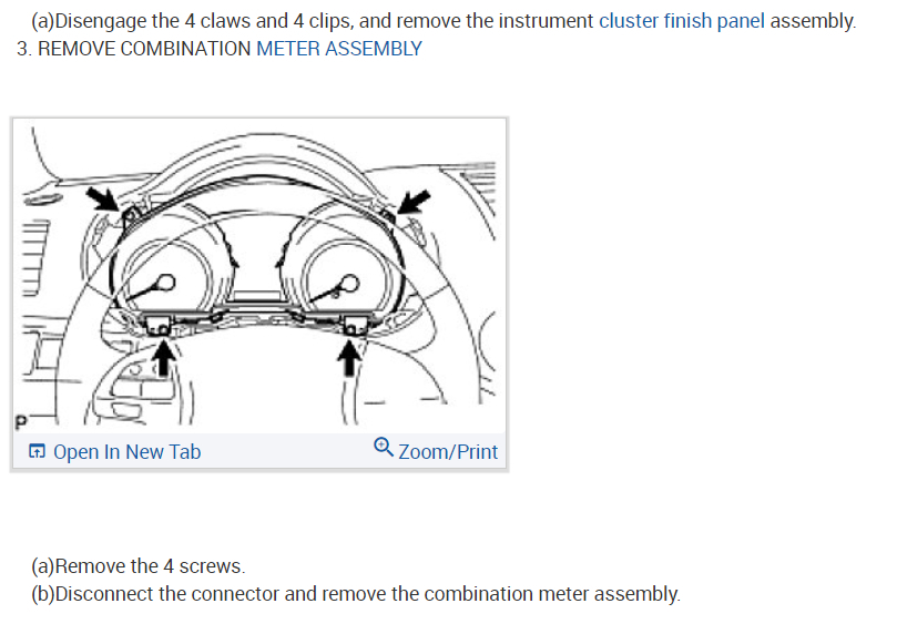

With no codes I would say the cluster needs to be replaced. here are the instructions. You will need to get a used unit or rebuilt from a place like AER in California. Check out the diagrams (below). Please let us know what happens.
