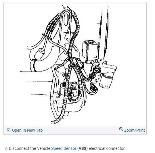

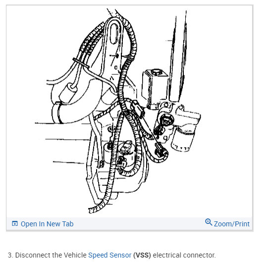

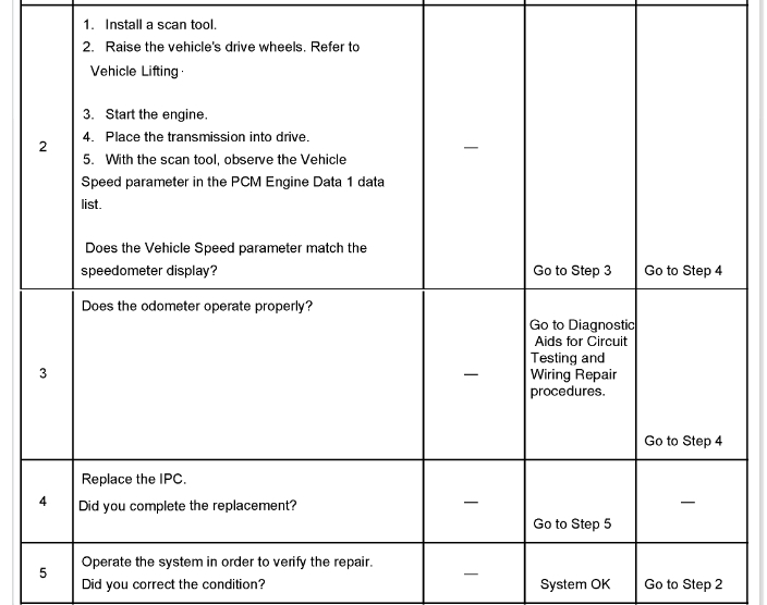

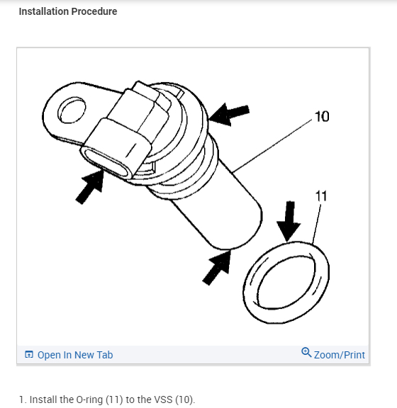

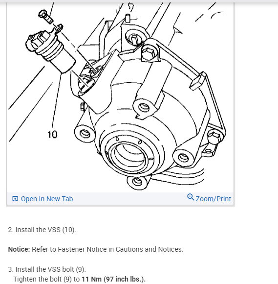

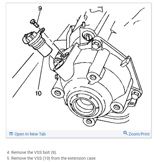

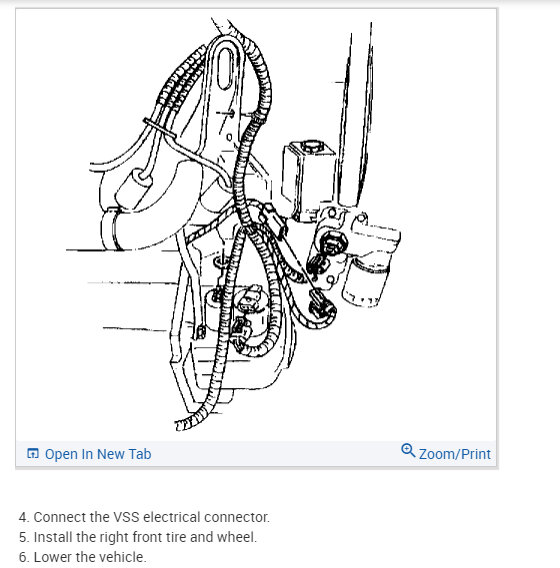

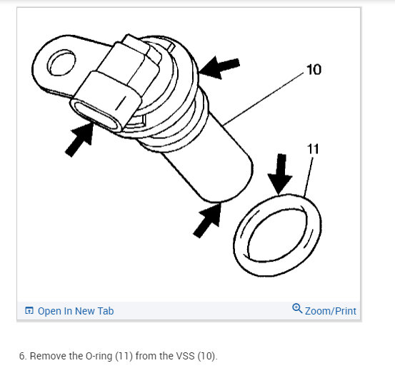

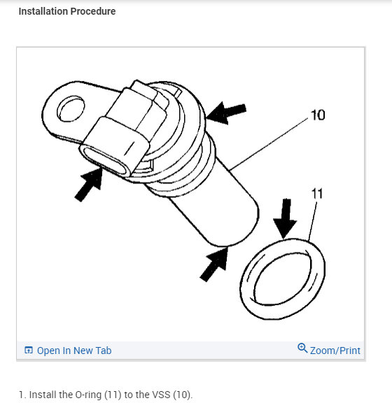

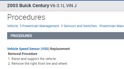

This could be a few things. First, I attached the directions below for replacing the VSS. Just take a minute and look through the directions to see if you may have missed something.

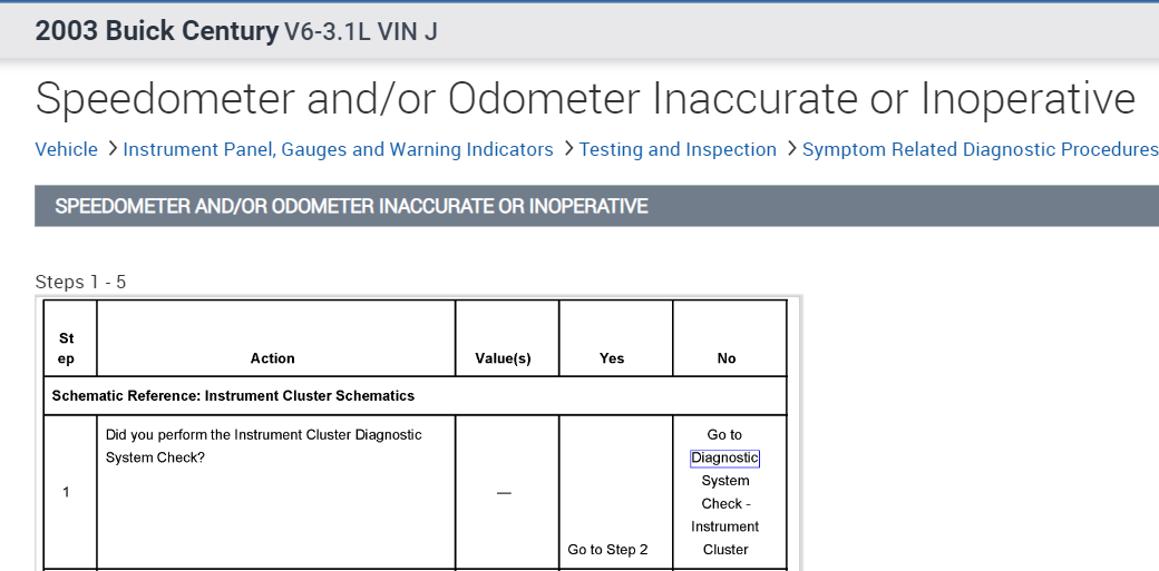

If you did, take a look at the diagnostics and let me know if that is something you feel comfortable doing. Also, if you haven't already, have the computer scanned for diagnostic trouble codes.
Let me know what you find.
See pics below.
