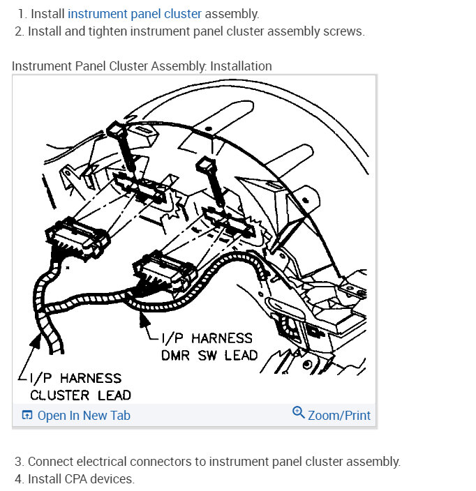

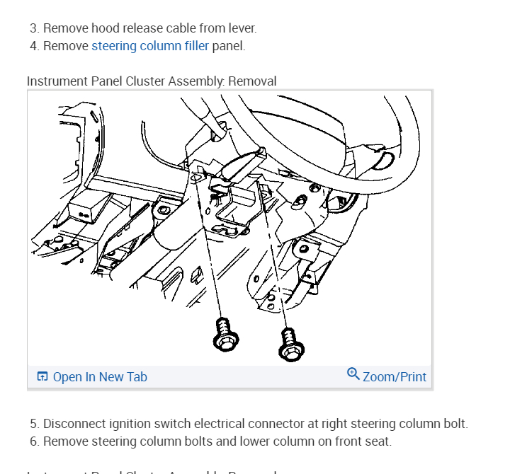

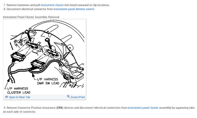

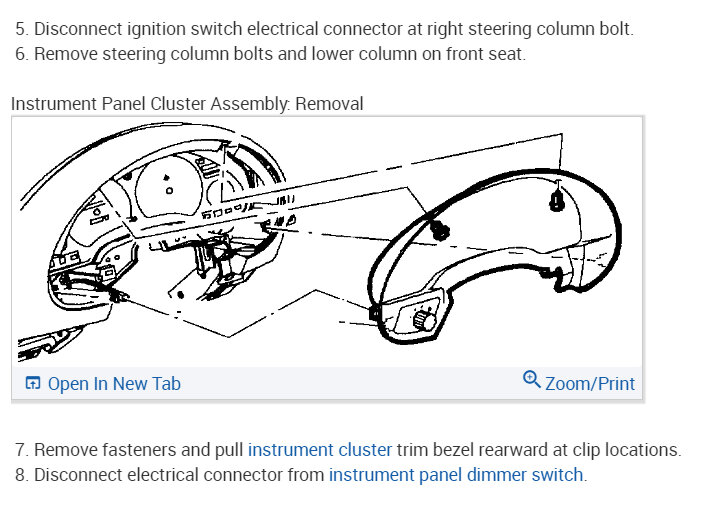

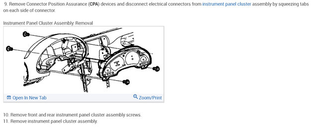

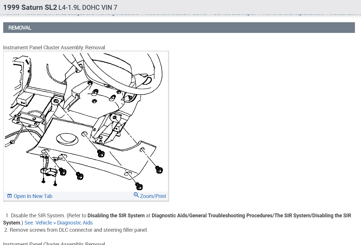

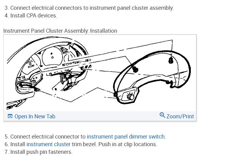

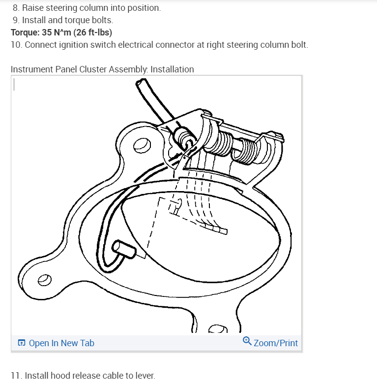

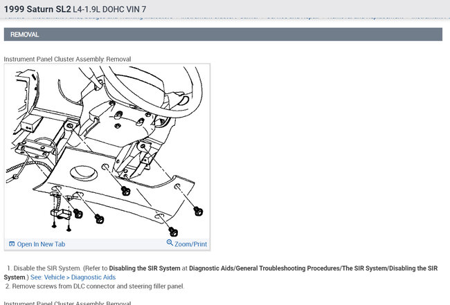

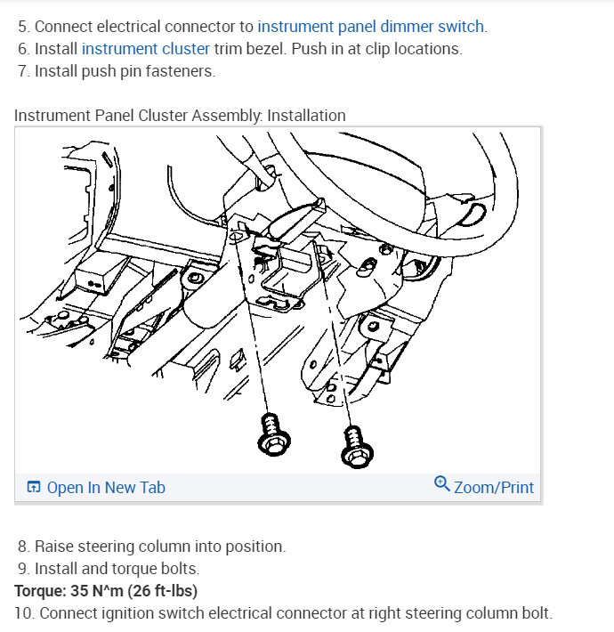

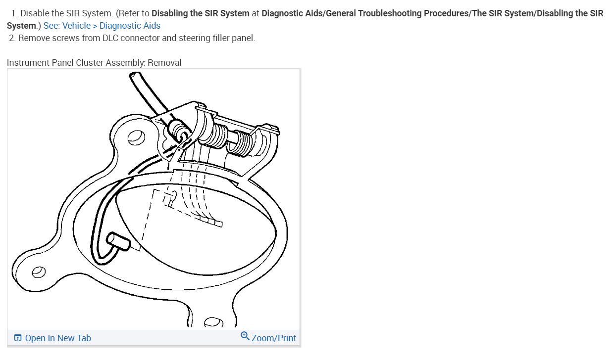

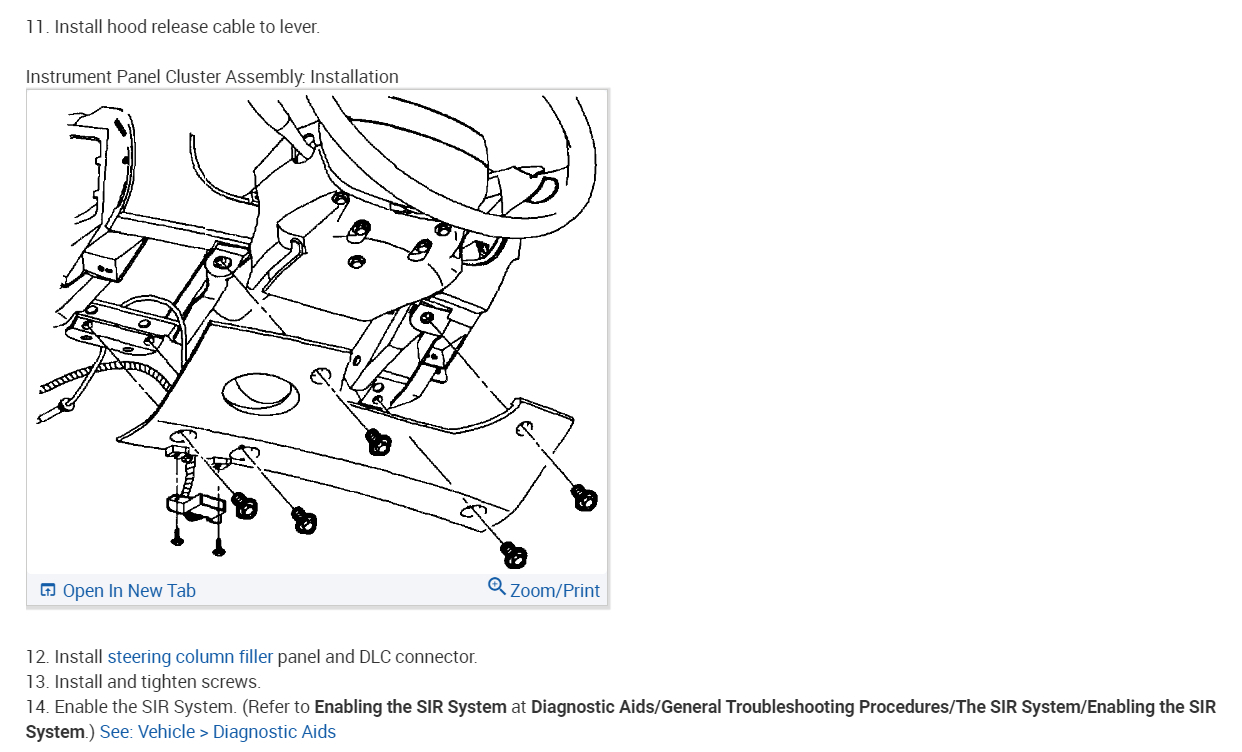

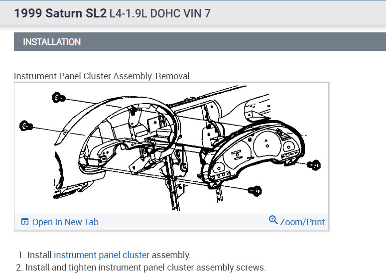

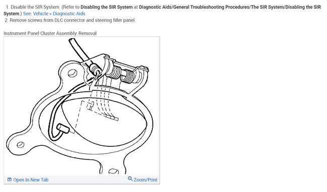

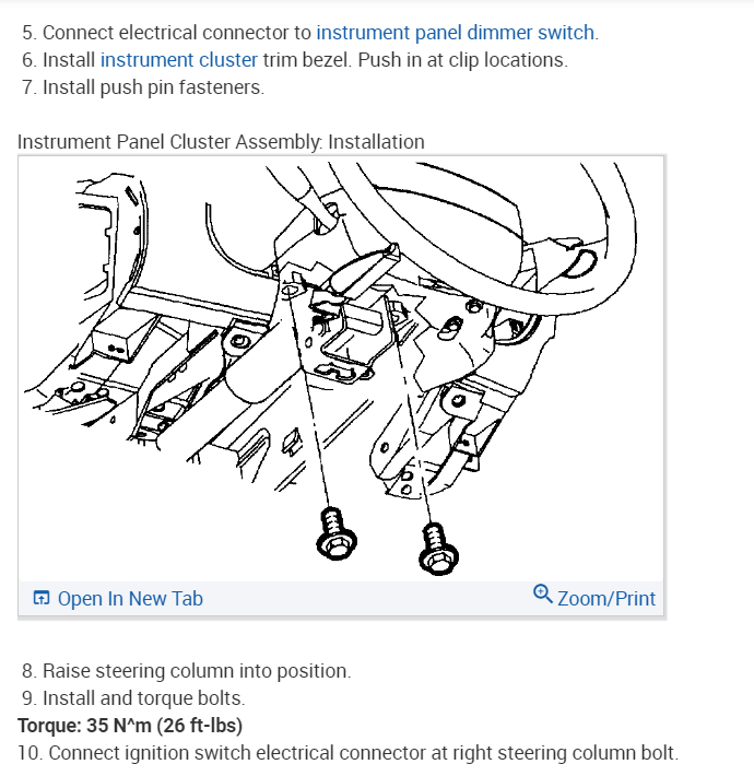

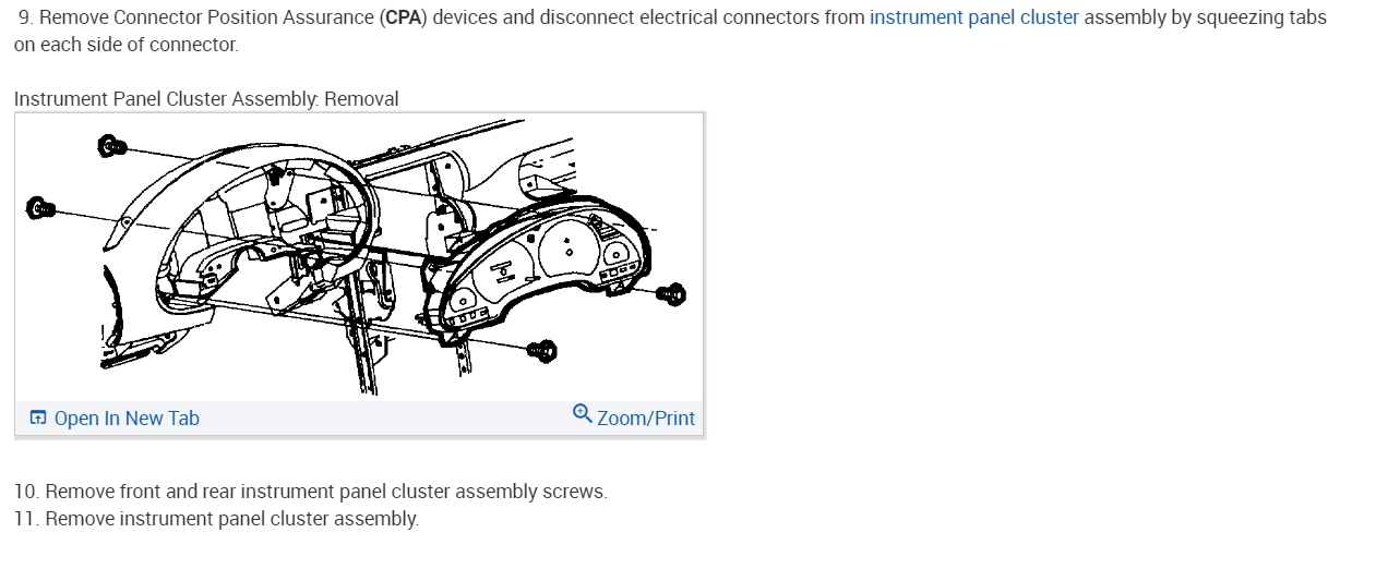

It sounds like the cluster is going bad, but you can try a hard system reboot. This guide can help and if not, I have included how to change out the cluster in case you need it.
https://www.2carpros.com/articles/step-by-step-guide-performing-a-hard-system-reboot-for-your-vehicles-electronics-systems
You can get a preprogrammed unit by searching Google or Ebay. Also check the electrical connectors at the rear of the cluster if there is bad connection it can cause this issue. Check out the images (below). Please let us know how it goes
